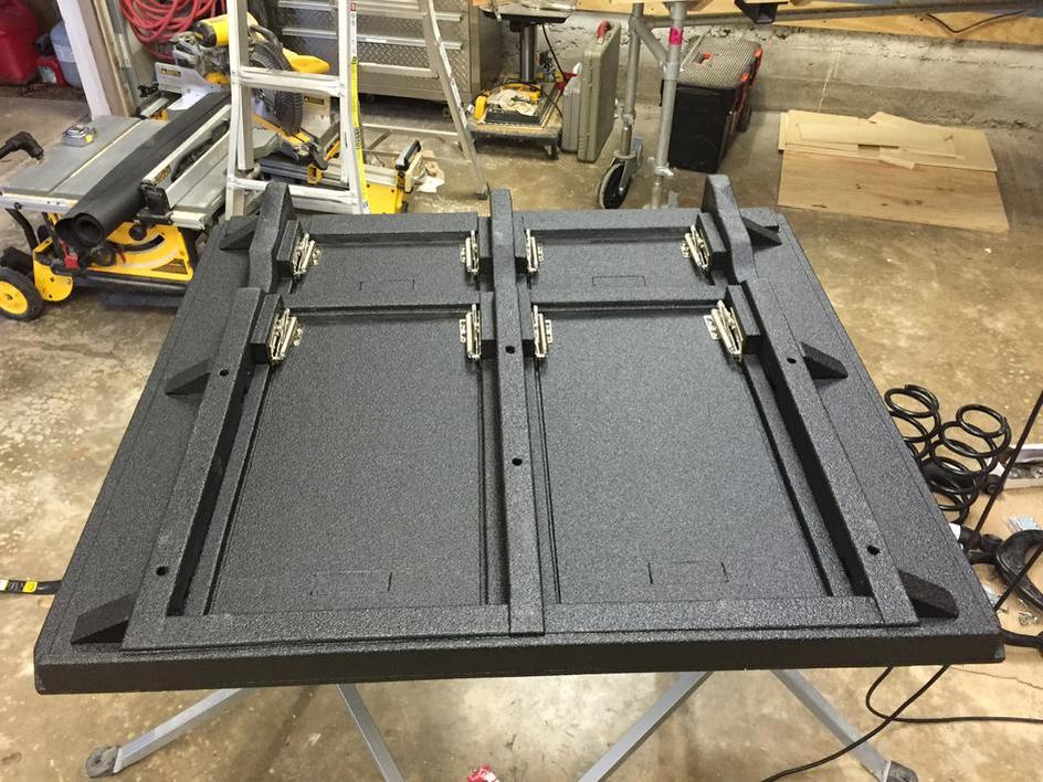

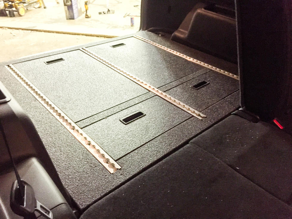

Flat cargo area with tie downs and storage
Other angle

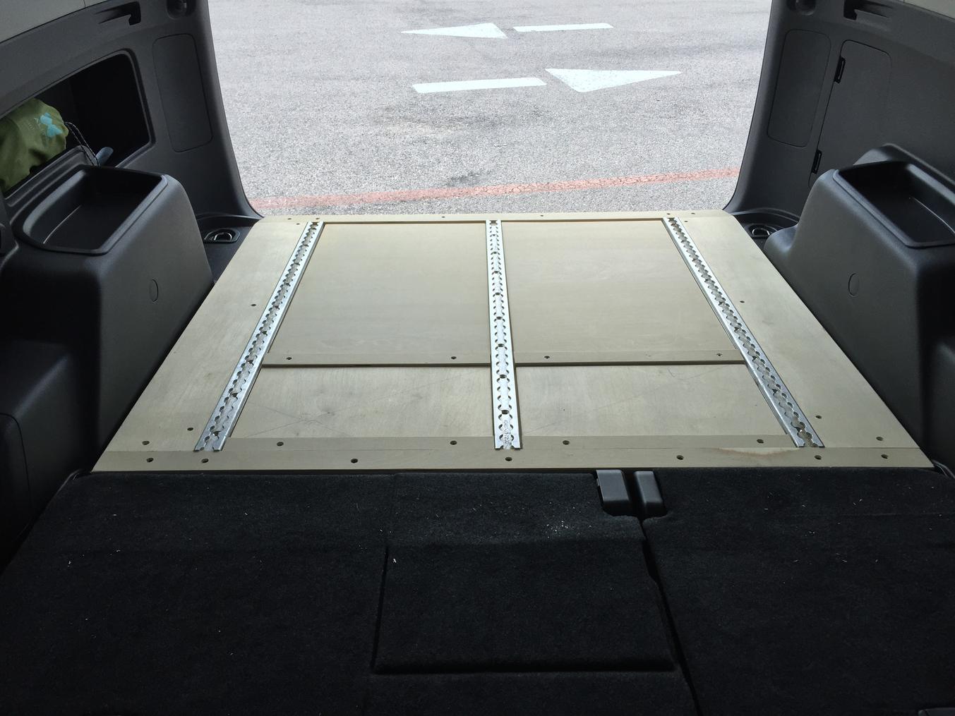

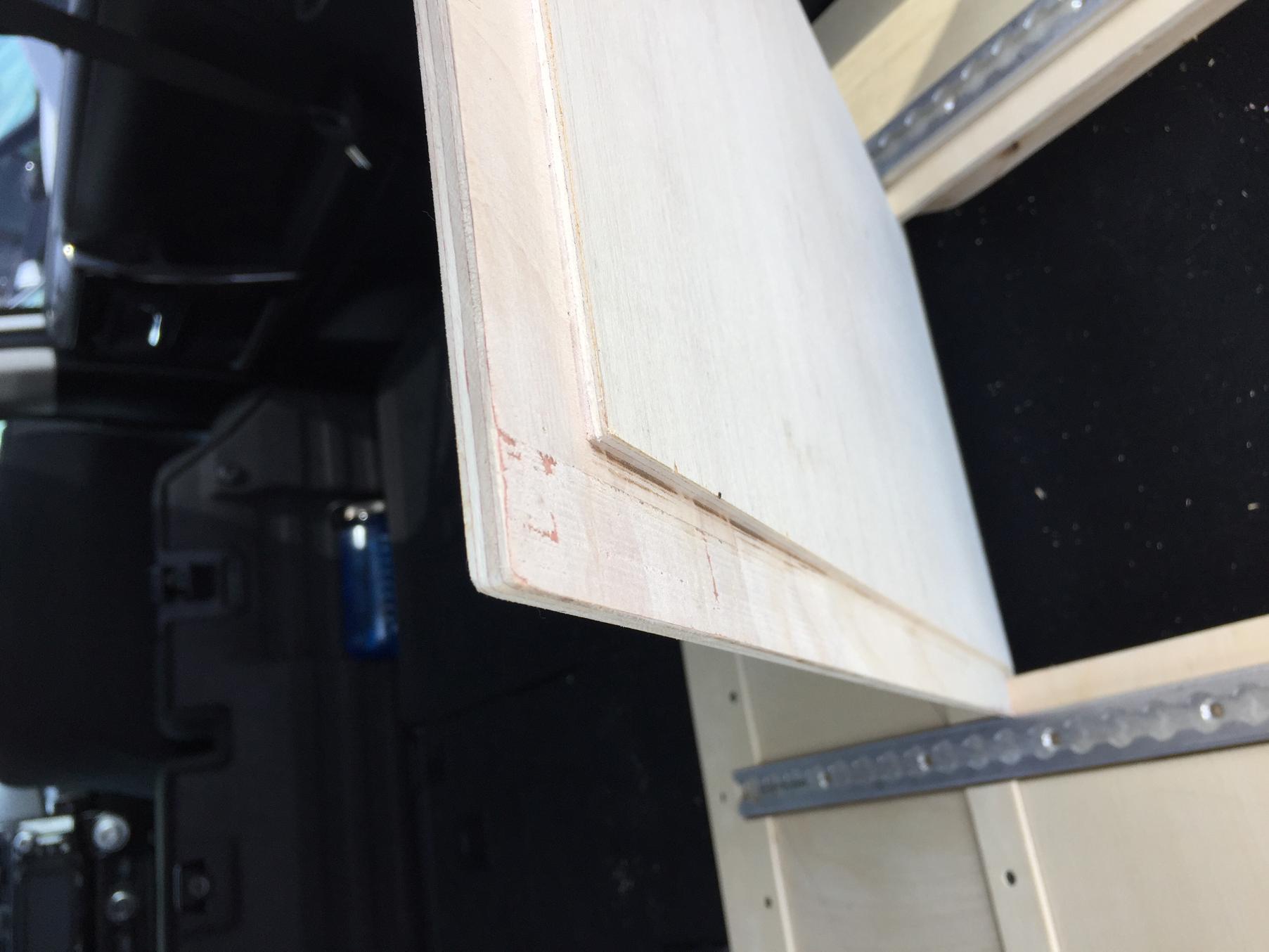

Yeah I haven't decided what I'm going to do for hinges yet. I don't want the panels free floating. I'll keep the dogs back there and wouldnt want a panel or gear to pop out if I hit a bump or when off road. I guess I need some kind of latch too. Have to make this up as I go along.
To secure the floor try using #14 flat head wood screws in predrilled holes Bevel the holes so the screws fit flush. Due to the big diameter, these can be installed to fit loosely and turn out with an easy twist using a short handled driver that's easy to keep in the car. When you want access you simply remove 4 screws per panel.
I like the metal track for tie down. It looks like they are part of the floor panels that remove, but I can't be sure looking at the bottom and top photos.
I removed my back seats 3 weeks ago for my first camping trip and haven't put them back in yet. I imagine making a similar platform in the front where the seats anchor. I'd add plywood to cover the back just to protect it. But with no prep at all the front works great and will fit 3 or 4 5-gallon water bottles and the ice cooler with room to spare.
Here are the final pics! It has worked out PERFECT!!! I love it. Have carried all kinds of things back there. Most often an engel 45 and my bikes.

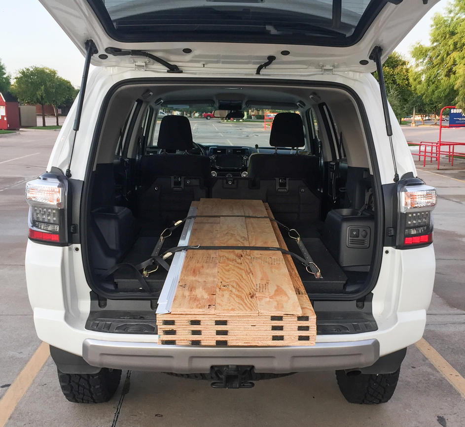

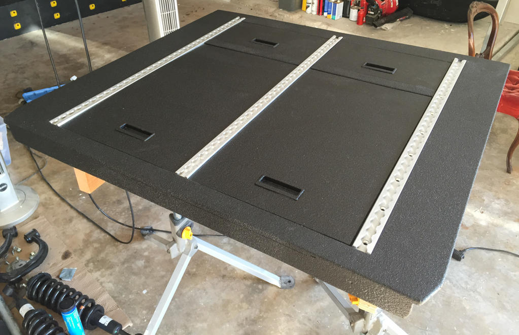

Loving the rear deck. No complaints. I use the tie downs almost every day for securing heavy things I Doan't want to become projectiles and the under deck storage is fantastic. Also sleep on it regularly.
Favorite mod so far!
For those that asked previously, yes it is line-X.
