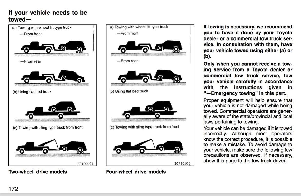

From my PDF of the 1997 owner's manual:

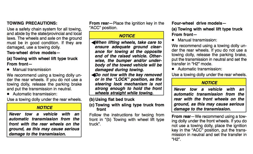

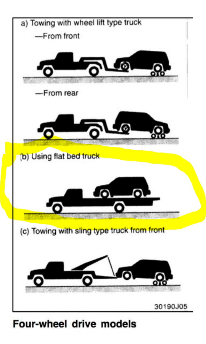

Realistically of the options pictured, B seems the most valid one. I don't think there is a 2-wheel dolly that is highway legal, maybe in Japan...
Or .... as mentioned before and below disconnect the rear driveshaft and tow it with the rear wheels down.
:bat:
