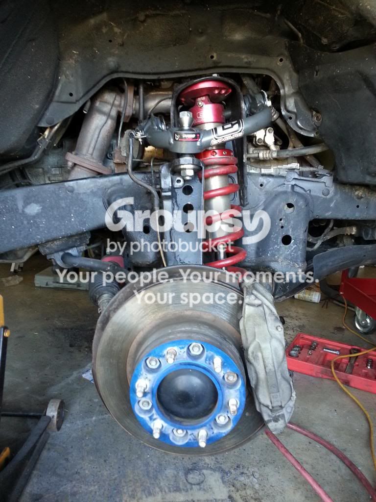

Ok so i know all about long arm kits, So please dont steer this thread that way! I want to get the most flex out of this thing as posible, so this is what i have so far
and the rear is sonona steel lift. That is all i know about it.
so I was wondering what people are doing with there sway bars because my 2nd gen dose not have them and it is fine but this is my dd and i want it to be way more streetable then my 2nd gen! witch disconnects are better? and what about my rear what should i do about that?

The front really wont flex anymore than the IFS will allow now madder what springs and shocks you run up front. To get more flex you would need too swap over too a solid axle.
The SS rear is just LC coils and LC shocks. If you have the rear sway bar lift brackets your pretty much maxed in the rear but it flexes like crazy. The front I dont run a sway bar at all. Still feels safe on the street IMO. I kept tearing the front links anyways.
