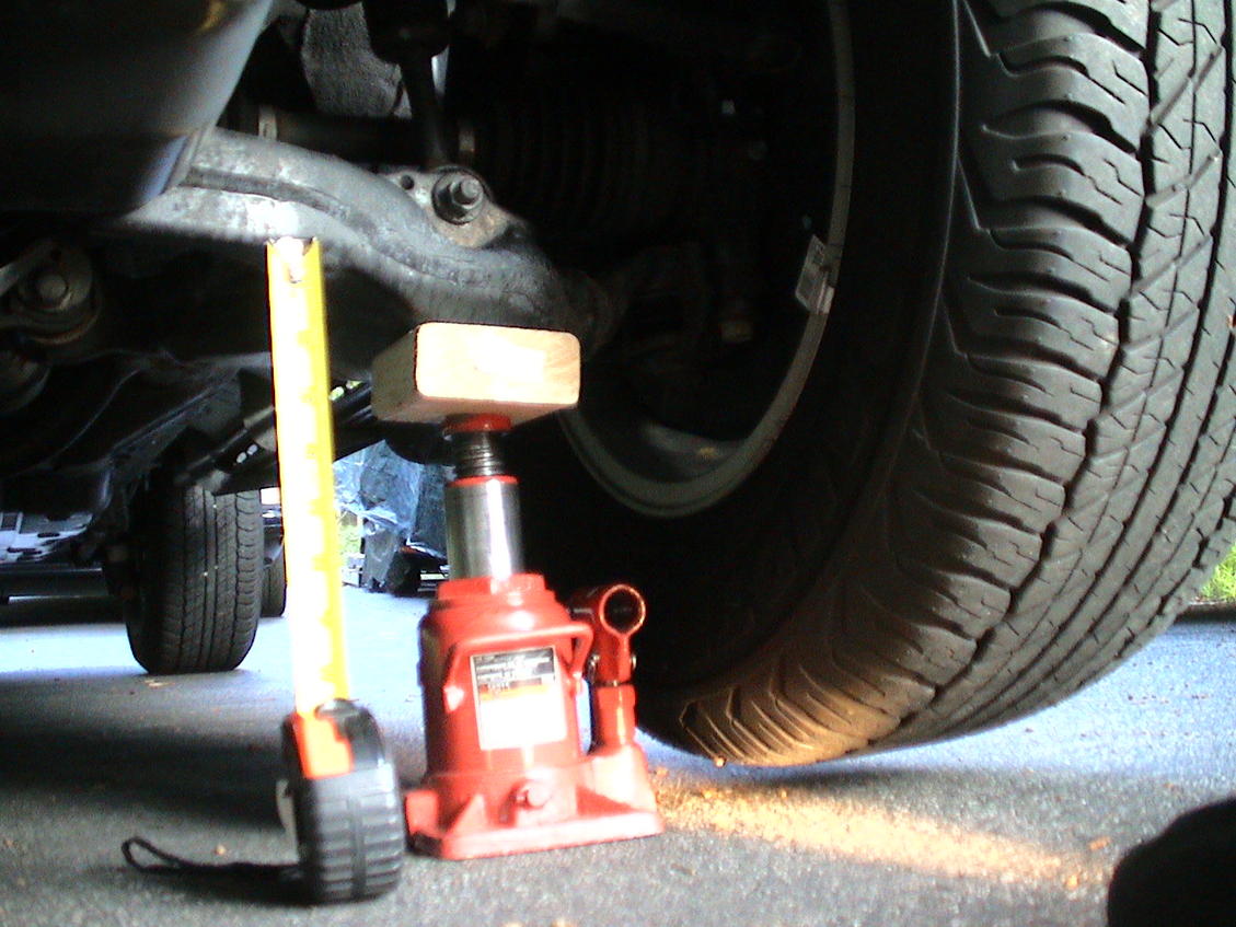

I have HF low profile jack about 20inches .. works great on my low profile sedan also..
when I rotate tires on the runner I jack up on the rear pumpkin .. also put a small jack under the front lower control arm .. little lift very safe ..
