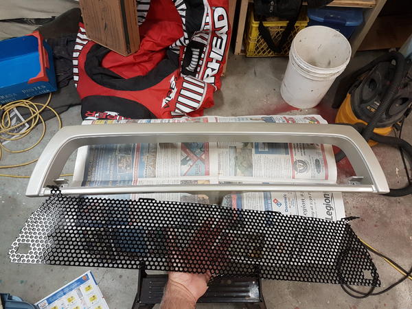

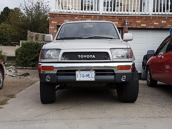

Well, a year and a bit later they are working great.
I did get around to repainting the grille...
