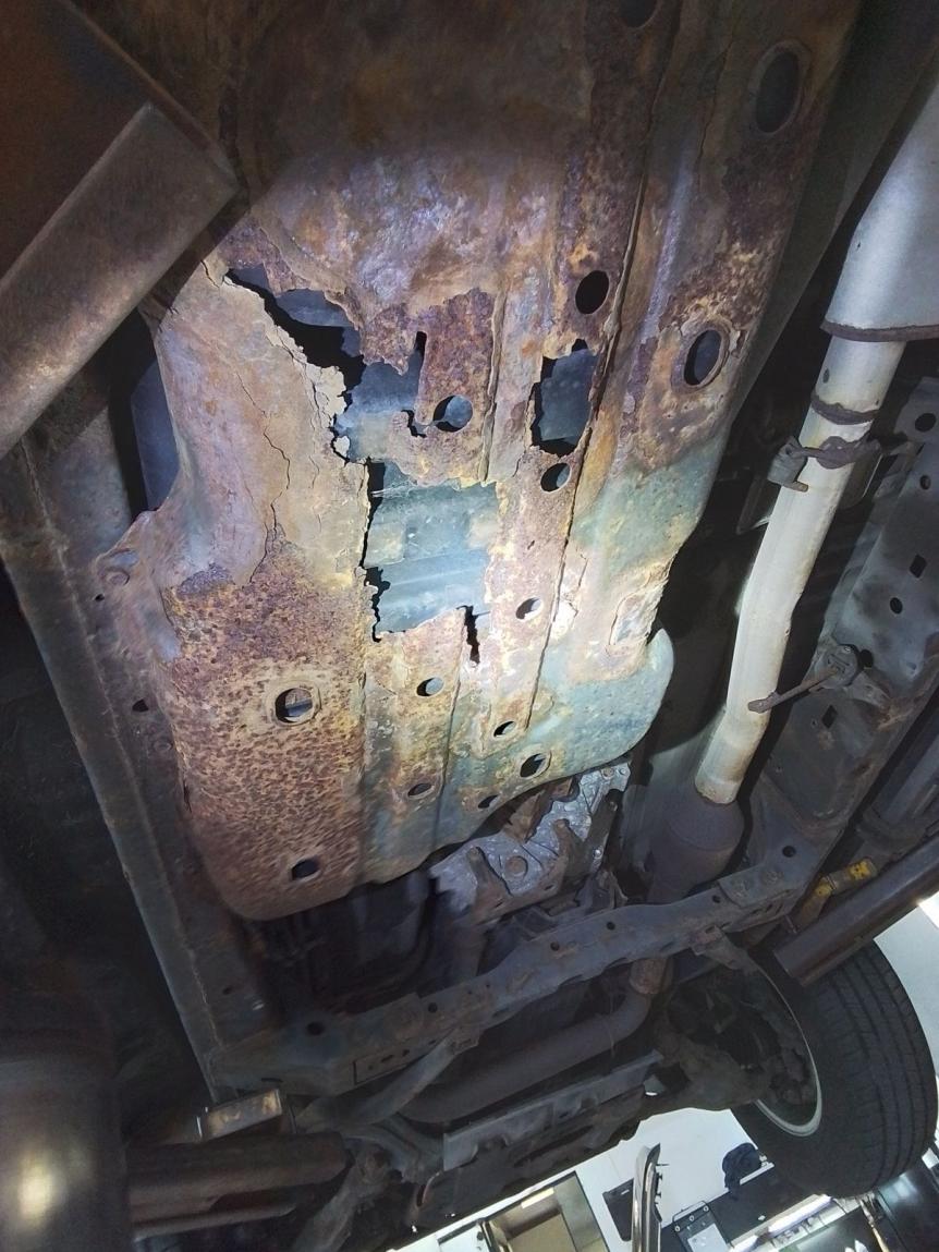

I have a 2004 Toyota 4Runner. I don't really drive it and long story why I am keeping it. Well, the garage I take it to for inspection failed it for a couple reasons, but this one is because the OEM fog lights. My brother in law said there's a short somewhere. I think he said "power through both wires", if that makes sense. He said he tested the relay and the fuse, both good. Oh, and no light on the dash. Same story this person on the thread stated.
I am not sure which fuse(s) or relay(s) he looked at. He was a mechanic so I am guessing he checked everything, but I have to ask him. I hate bothering people. But can you please tell me what I can check?
Please be easy on me. I am a woman that tries to do everything on my own. Soooo, that said, about a year ago, I replaced the Rear Hatch Latch Actuator. That is in the trunk. I bought a part from Amazon. Not to sound stupid, but is it possible, that I knocked anything off in there that caused the short in the fog lights?
And I know this is not the right topic for this, but it also failed for gas tank straps. My brother-in-law will replace, however, the "cover" is also rotted. The quote the garage gave did not have the cover in it, so not sure if it is needed for inspection, but it is rotted and I am not sure what the correct part number is to replace it. I will start a new thread (if I can figure out how) on this. I am sorry for the long post. I have to pass inspection (Pennsylvania) by the end of the month. I already paid for the emission exemption sticker.

for the gas tank. your skid plate is rotted. probably not needed for inspection unless it was so rotted it posed a danger. you can call a toyota dealer and ask for the part number and order a replacement. they're steel, they will rust no biggie
Thank you so much for your reply. My brother-in-law confirmed that he checked all this. I also contacted the garage and they said the cover is not needed for inspection. I ordered a toggle switch for the bypass to get the fog lights working and the fuel tank straps.
