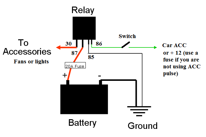

See the image,
A relay has 4 pins (some times it can have 5)
They are numbered
Pin 87 is +12 V supply from your battery VIA a FUSE (20 A)
Pin 85 is grounded
Pin 86 goes to your switch + 12 V.
You can use +12 V from
A) car ACC line (power that goes into your radio). If you use a +12 V from this method you will turn off your accessory lights when you take the key from the ignition and will not require a fuse.
B) from the battery. Remember to use a fuse with this method. Also your lights will stay on even if you take the keys from the ignition. You have to remember to turn off your switch to turn off your accessory lights
Pin 30 is the +12 V supply to your accessory lights.
You can find all these numbers embossed right next to the respective pins
There may be two 87 pins, you can use either in that case.
