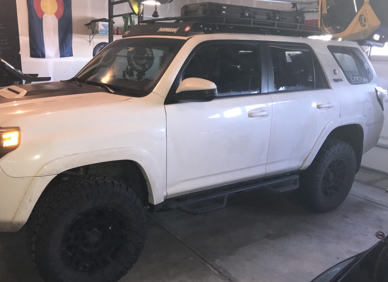

I have 6112 both at the top notch with 1/4" spacer on top of it. I also have the OME trim spacer on top of my SAW d/s rear spring. Both sides are 23" hub to fender. Very happy with results. I will post a pic in a few mins
