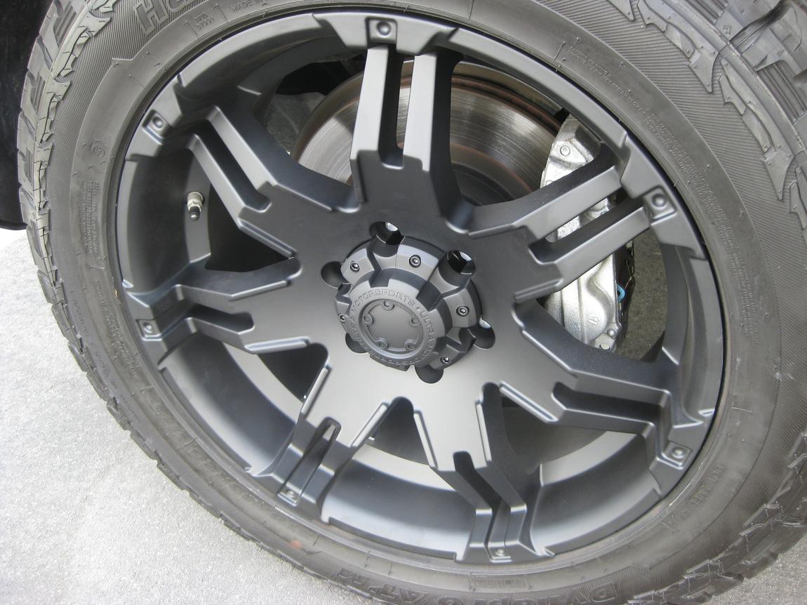

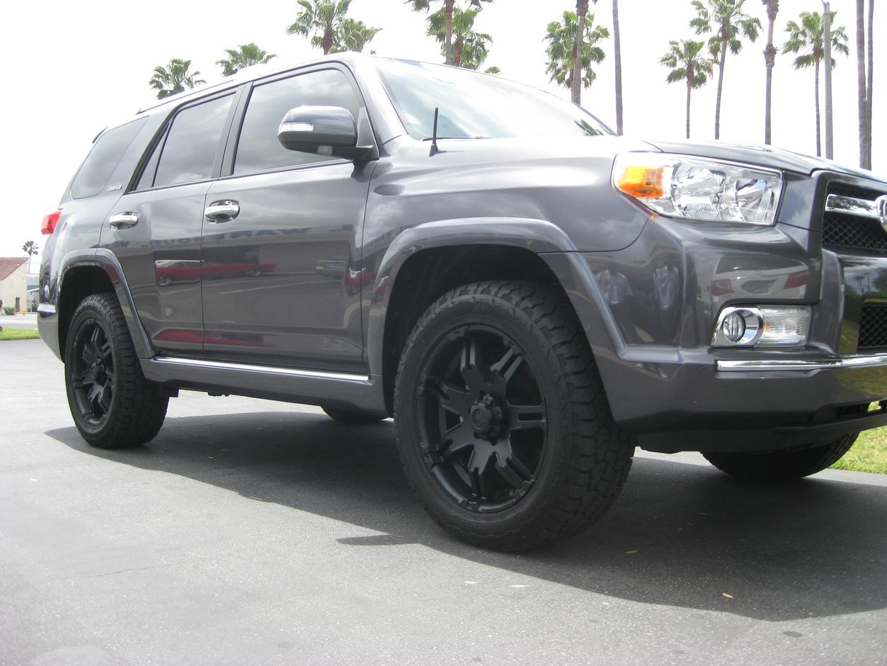

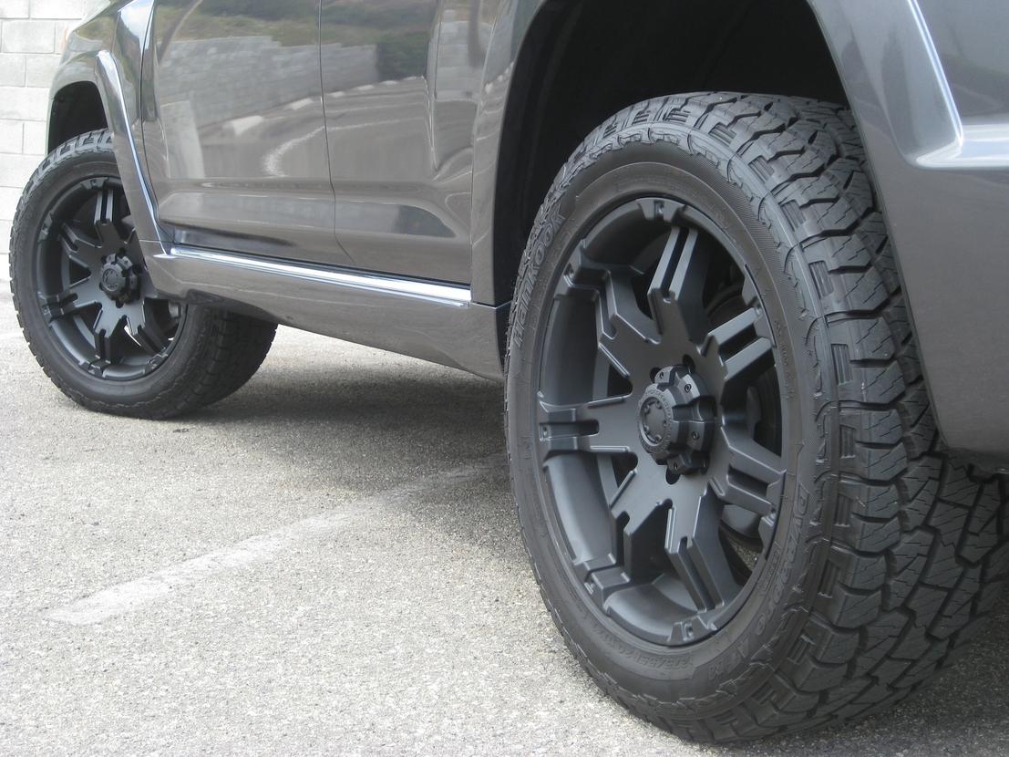

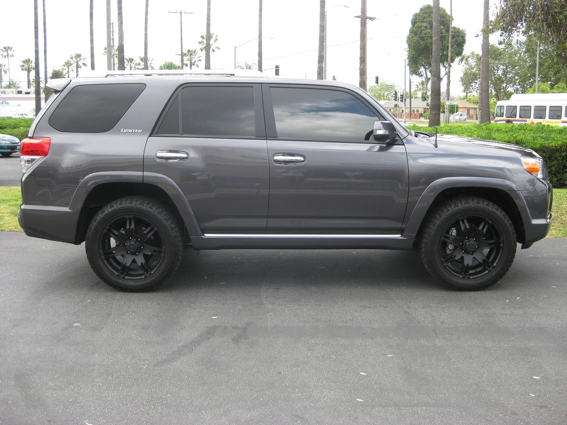

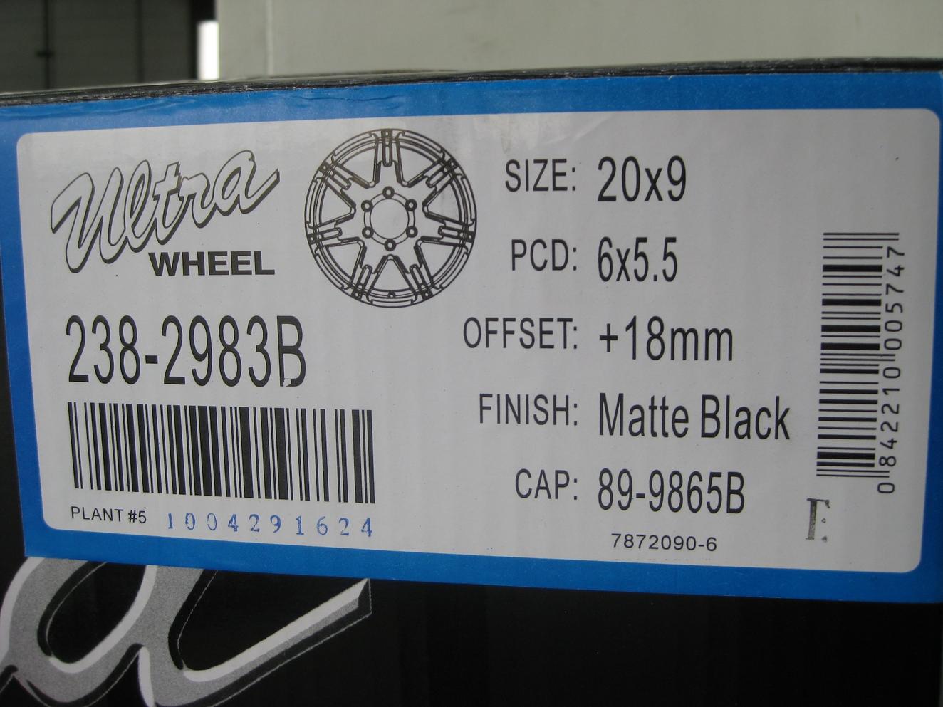

I know there's already a thread about 20x9 wheels, but for some reason some owners don't know their aftermarket wheel specs and can't provide help to others that are interested in upgrading. So, I decided to start a new thread in hopes to help those in need.

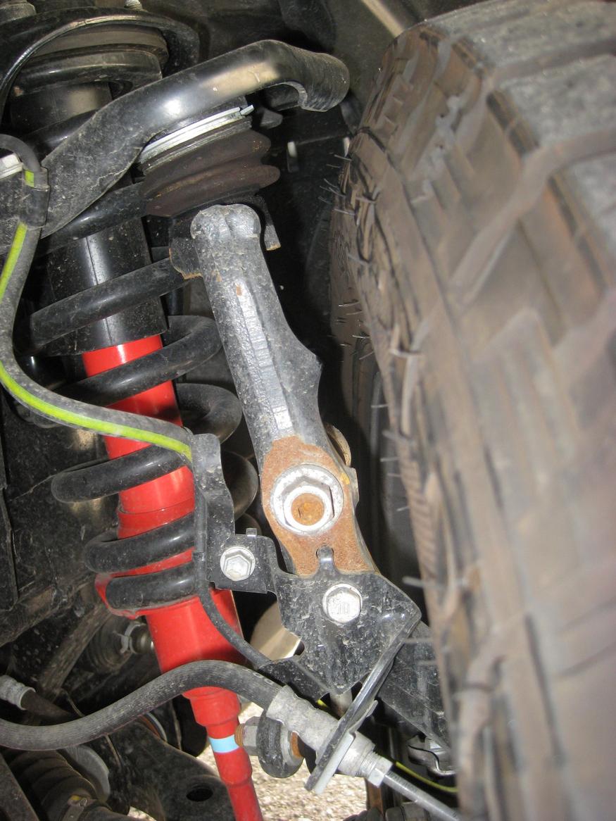

Finally my wheels arrived after 8 weeks of waiting and wrapped my 275/55/20 Hankook Dynapro ATM Rf10s on them this morning (they were on the OEM 20s). Wheel specs are as follows and I have no rubbing issues in the fender well or with the suspension components even with the wheels at full lock. I think they look great (i may be biased:D)
Ultra Wheel - Gauntlet - Matte Black
20x9"
Offset +18
BS 5.71"
Hope this helps. Next is a lift and chrome blackout! Oh, and I'm selling the OEM 20s if anyone is interested. Pics below:

rust should not be evident on those parts already. Not very encouraging if you ask me...i would make a fuss out of this at the dealer

Snow&Surf--Those look awesome. How far do they stick out from the fenders? Do you have any shots from the front or back?
How do you plan on blacking out the chrome? I'm in a similiar situation about to put some black wheels on an SR5 and hate all the chrome. I'm kicking around replacing with black Trail parts vs painting everything black or body color...
the wheels are completely flush with the fender. these wheels also come in 0mm offset which would make them stand 18mm past the fender. I'll post some pics when i get the chance....
