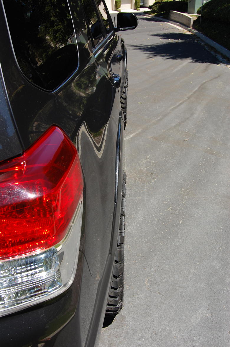

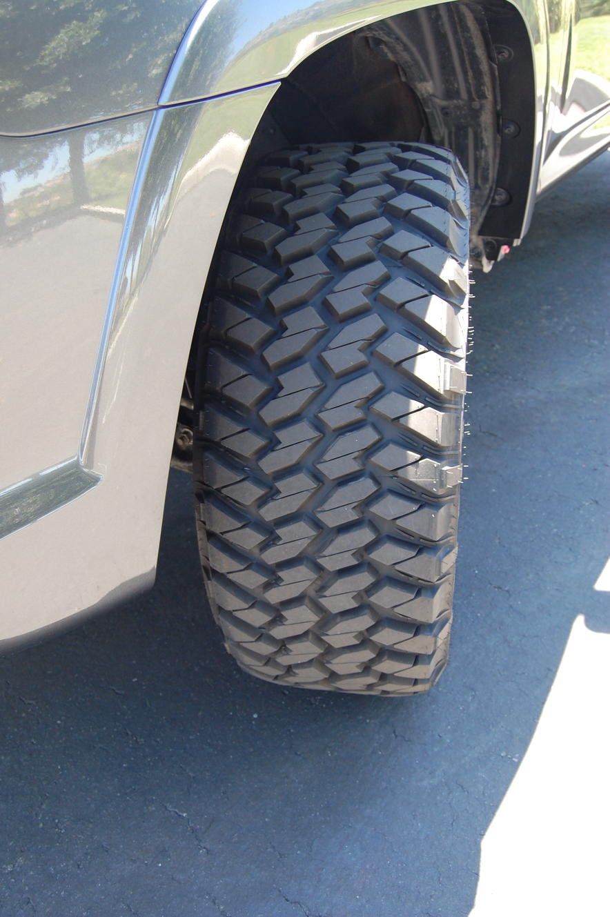

you can't tell from the pictures but the wheels stick out about 1" past the fender well. i'll try to take some pictures to show this better.

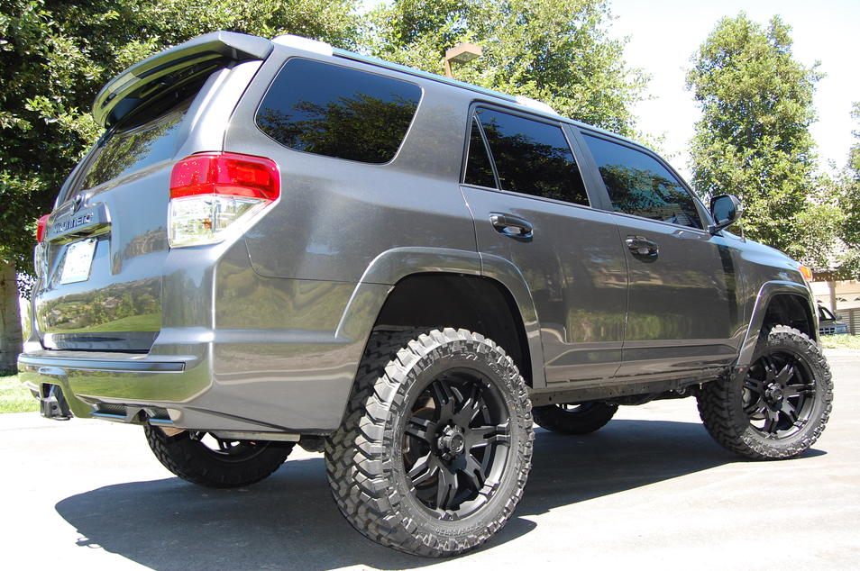

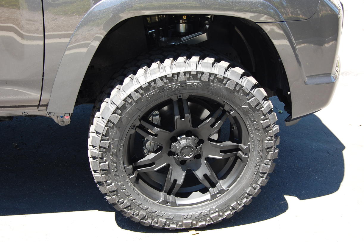

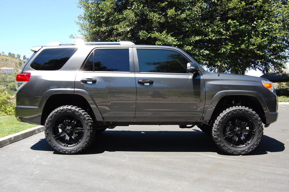

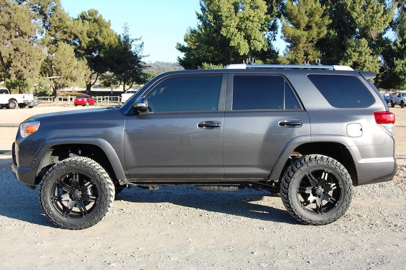

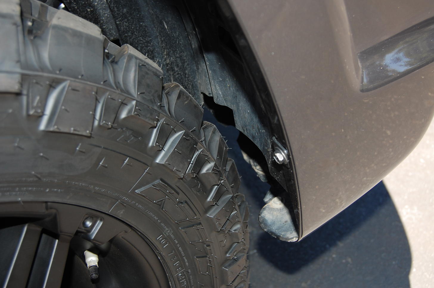

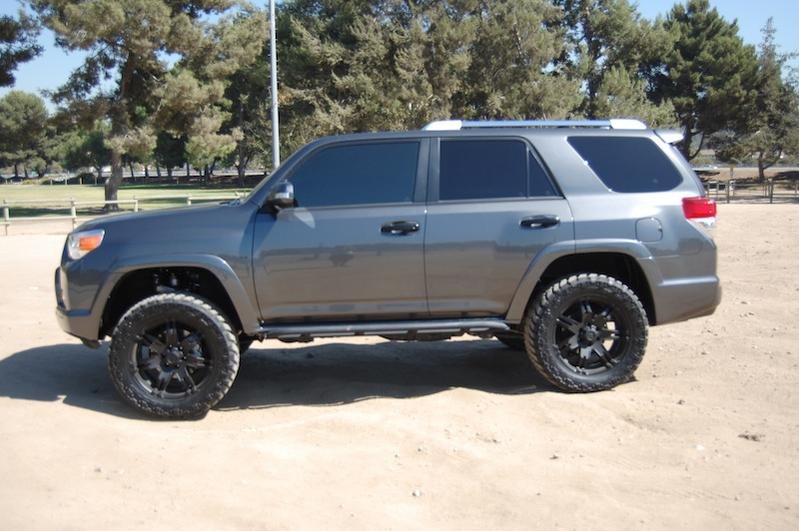

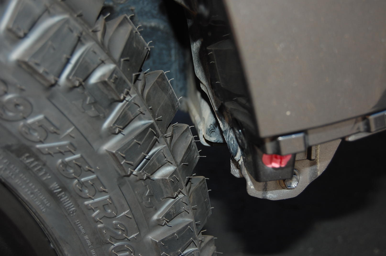

quoting myself but as promised, here's the pic. plus some additional pics to show fitment. as you can see (and from me driving) 33" tires with the right wheel setup will fit with no rubbing problems if you do a minor liner trim. i believe harper7 is running wider tires than i (305) so it's all about the right wheel specs.
#1 - tires stick past fender flare by about 1"
#2 - front inner fender well liner trim, wheel at full inward lock
#3 - tread blocks/lugs, wheel at full outward lock (front view)
#4 - body mount (not chopped), wheel at full inward lock
#5 - wheel/tire/lift setup. clearance of 33" tires in front fender well
#6 - courtesy profile shot
#7 - courtesy angled shot

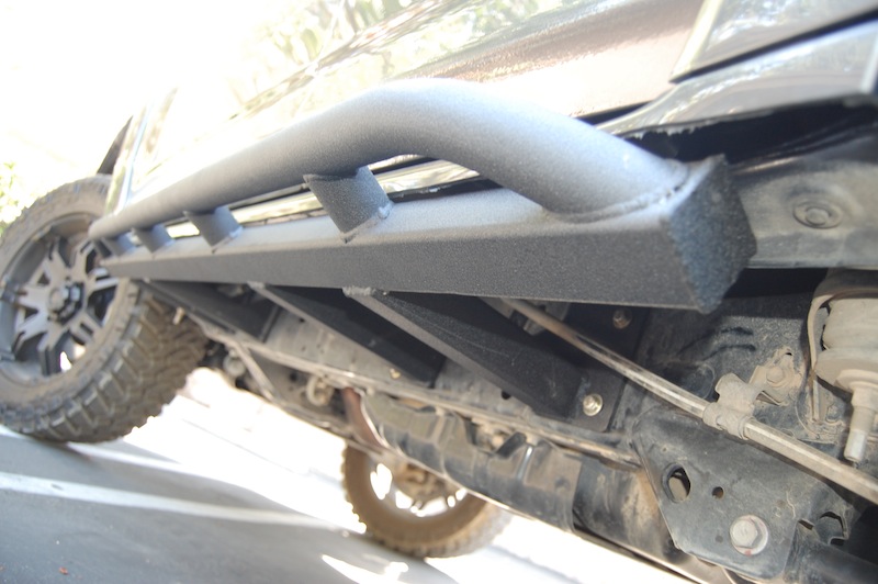

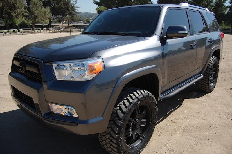

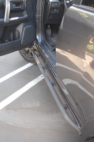

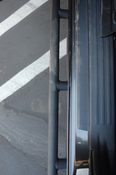

Demello Rock Sliders

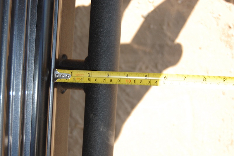

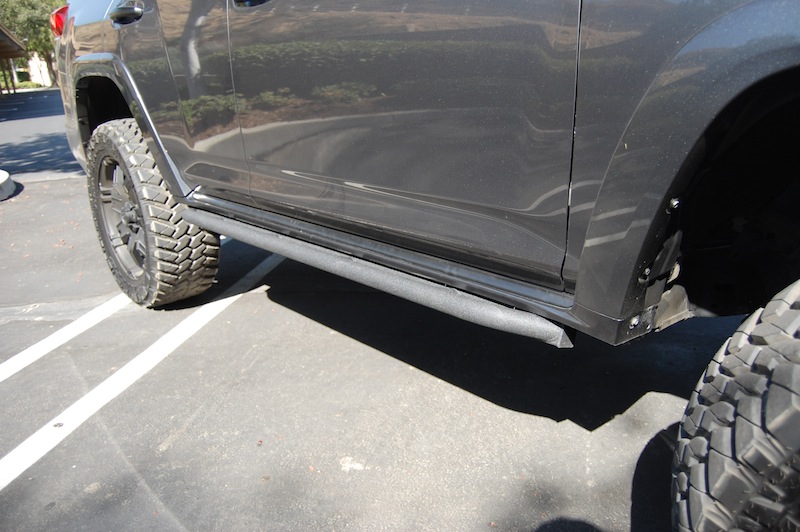

Thanks to forum member Dlak, I was able to get my Demello Sliders installed today. A couple months ago I removed my rocker panels to give the truck a more aggressive looking stance but really hated the unfinished look of it. I've been waiting to see if there was someone who would fabricate sliders for Limited/SR5 owners where we would be able to keep our rocker panels on. Thanks to Jason and his team for doing just that!
These guys are super friendly and did fantastic and professional work. I blacked the chrome accents on my panels and his team trimmed them down cleanly before mounting the sliders. I think they look great, I know they'll work great, and they're very functional as a step (my wife will be very happy :reddance:)!
Some pics. First will be a before (without rocker panels and sliders) the rest are after (with panels and sliders).
