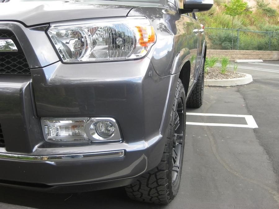

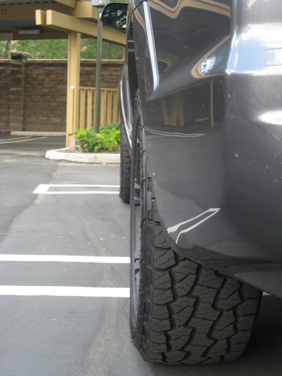

Snow&Surf--Those look awesome. How far do they stick out from the fenders? Do you have any shots from the front or back?
here you go:

@ skel - thanks for your comments. to answer your questions my wheels are tpms compatible and any shop can easily transfer the sensors from the stock wheels (at no charge). also the 275/55 tires do not rub the suspension components or fender wells at all and i've taken my truck offroad a few times with no problems. the bigger wheels and tires weigh more than the stock so you'll need more power to get and keep these moving plus the wider footprint creates more friction/drag so you will lose some mpgs. the ride is as smooth as stock but you may have to play with the tire pressure to fine tune to your liking.

I think it looks great and thanks for posting up the shots. Definitely a nice look without being over the top IMO.
What do you think of those tires? I'm starting to check out some for my 4th Gen but want a decent AT but not overly noisy.

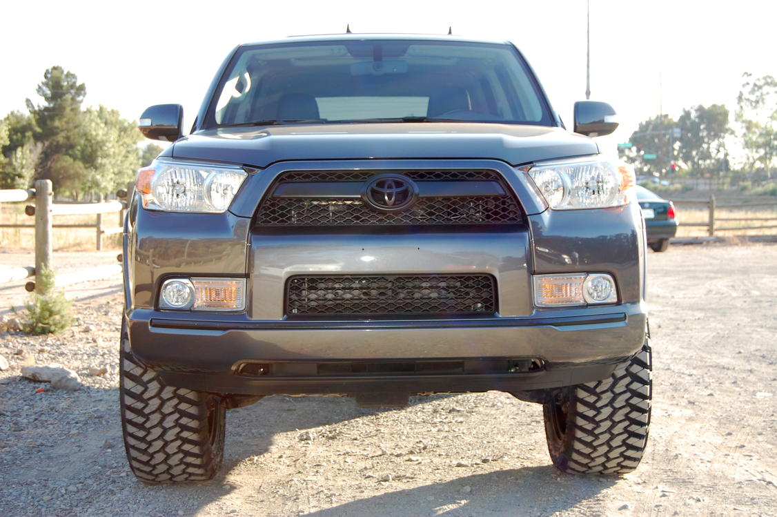

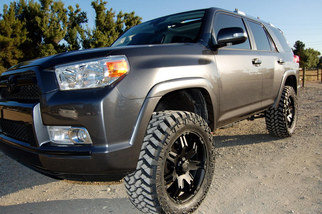

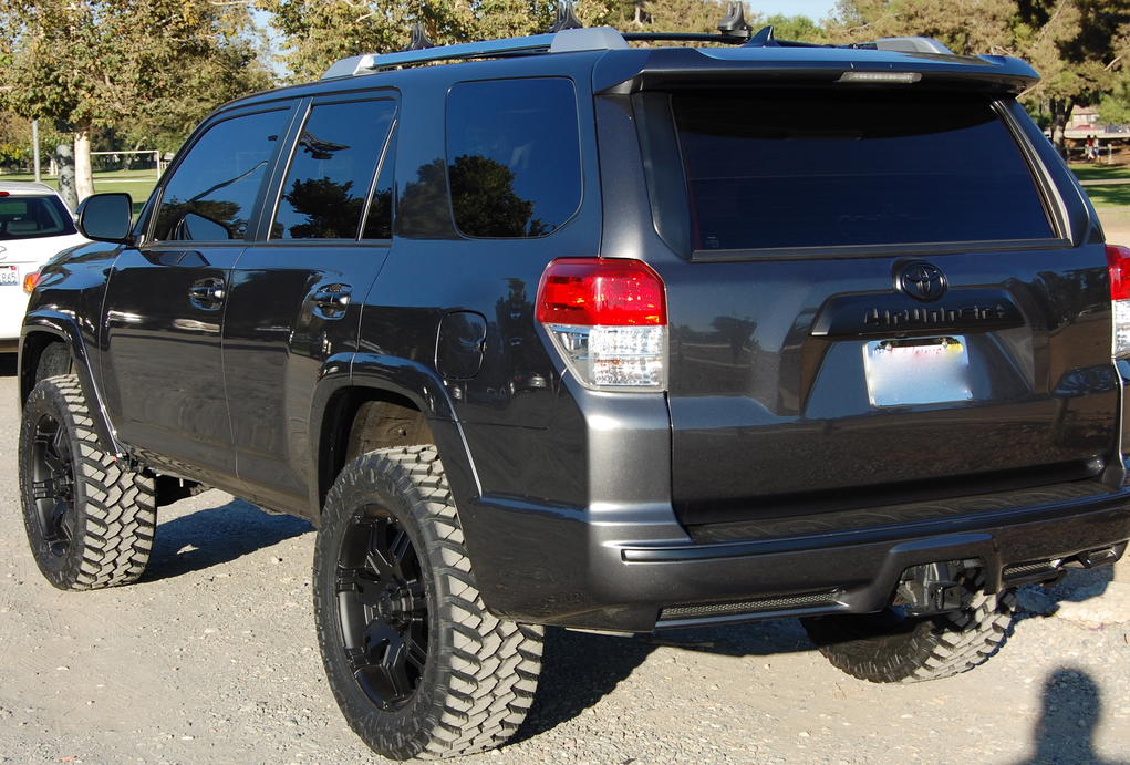

upgrades & changes!

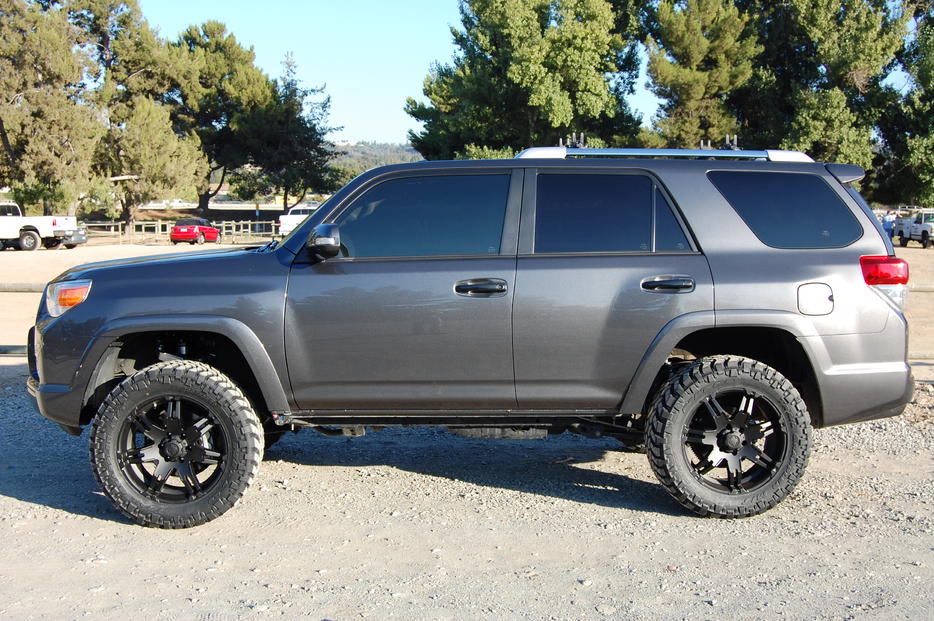

@ skel - i drive fairly aggressive and don't monitor my mpg. i can only go by what is displayed on my instrument cluster which is 18.3mpg @ 17.7k miles driving a mix 50/50 city/hwy. i can understand your frustration with the 7" wide oem rim and lack of available tires and that's why i got rid of them as soon as i found the wheel i was looking for. one of the reasons why i said this wheel may not work for your truck is the gloss black paint on matte black wheels looks a bit weird imo, and also it may be too much black and why i suggested looking for a gloss black wheel with some chrome. but if you're not going for the street look after this winter i say get the this wheel. i think it looks great with the 5th gen styling! as far as installing an aftermarket lift, i do believe the only way to do that is to get rid of the xreas (unless you do a spacer lift as opposed to coilover). our LE aren't bad offroad when stock (except for the tires) and we have one feature that the TE owners don't (torsen differential) which was big for me.
that being said, in addition to the torsen differential i chose the LE trim for all of the features/luxuries the SR5 and TE trims do not have and LE owners can mod their trucks to make them perform exceptionally well offroad (see harper7) and i too am doing the same.

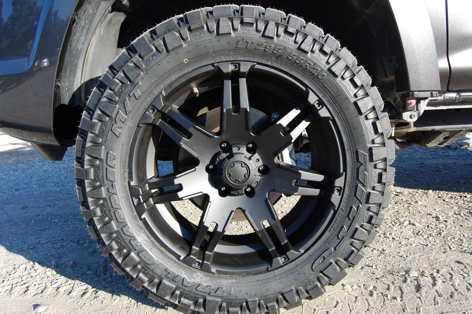

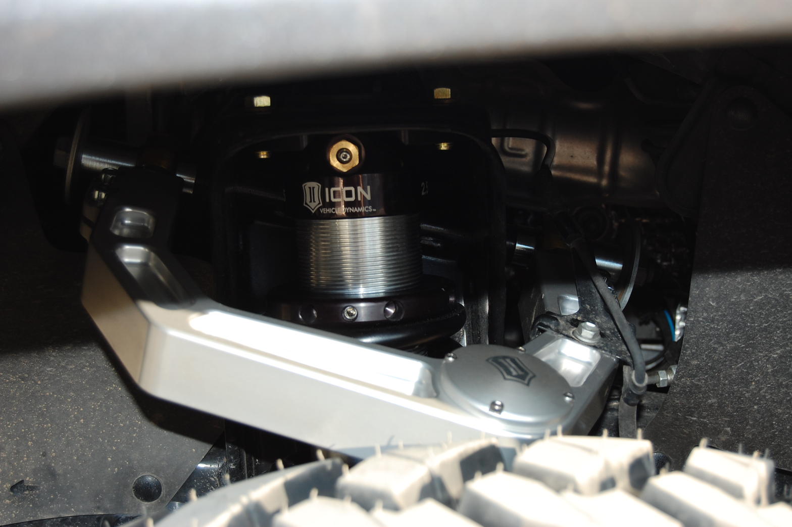

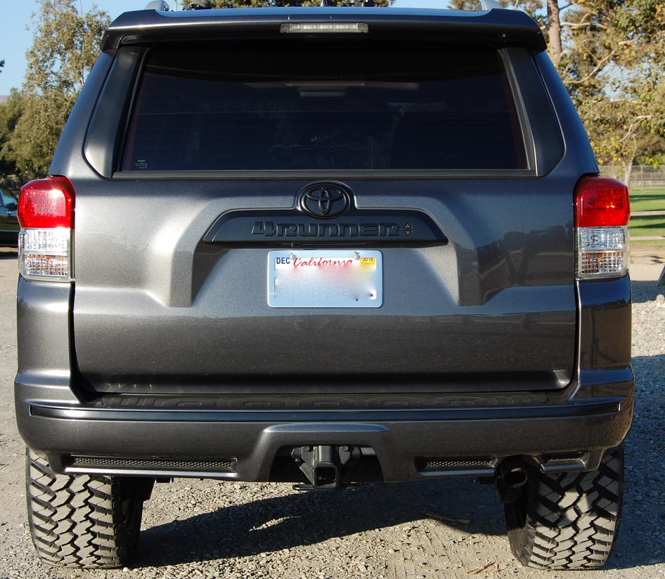

as i said in a previous post, my vision is to make my 4R mean with the intention of doing bad things and i'm getting closer to that with my recent mods. i blacked out most of the chrome accents, debadged, removed rocker panels, gutted and trashed xreas and sold my 275/55 hankook dynapros. just finished installing my ICON extended travel front COs, ICON UCAs, ICON rear coils and shocks, and slapped some 33" (295/55/20) nitto trail grapplers on my gauntlets! i love my 4R!!!!!

Now that is hot!
snow & Surf, prior to the lift could you run the spidertrax spacers with those wheels? I am asking because I would like to get those wheels but make them stick out a bit more. Then maybe do a lift down the road sometime.
Now that is hot!
thanks! i can't speak from experience because i haven't run spacers with these wheels but i don't see why you couldn't. as long as the spacers are made with the correct bolt circle pattern and have the longer bolt screws it should work, but you're better off getting a response from someone who uses spacers. my only concern would be the tire diameter you plan on getting because spacers can make the tires rub the inner fender liner at full wheel lock.
you can't tell from the pictures but the wheels stick out about 1" past the fender well. i'll try to take some pictures to show this better.
Right now I have the Hankooks you had before the lift. It seems to me it would work out fine, hopefully
Which icon package did you get?.
@ isitme? - great tire! really loved them but i knew the truck wouldn't look right with the lift and the Hankooks. they wouldn't fill out the fender well as much as i would like especially with the lift. at full lock the Hankooks were pretty close to the inner fender well liner with this wheel but it didn't rub. i don't know if the spacers would change that. the suspension is ICON stage 2.
Those tires look waaay better than the Hankooks. The width makes the difference. Lift looks sweet too, lets hope your able to put them to use.
@ kingpin - living in SoCal gives me plenty of opportunities to use them. other than upgrading the look that's the main reason why i made these changes. can't wait to hit the trails!

Too bad nfabs side steps don't fit the ltd. That would finish this off nicely.
N-fabs WILL fit the Limited/SR5's with the rocker panels removed.
Pretty sure he's building his Ltd. for serious offroading though and N-fabs are not strong enough and don't attach to the frame.
They attach to the body and won't support the weight of the truck like real sliders.
i know, but i'm waiting to see what Demello puts out before i make my decision with sliders.
