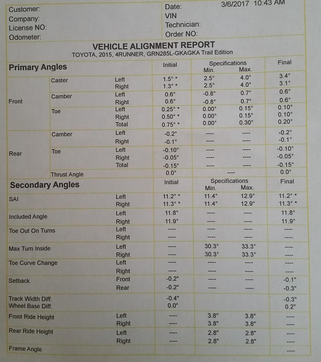

I have 2.5" of lift and run stock UCAs. I've read it can be done, and I've read otherwise. May depend on your person doing it maybe. Also, like said above, your results may vary. Pretty sure I posted this in one of your other threads but here it is again.
