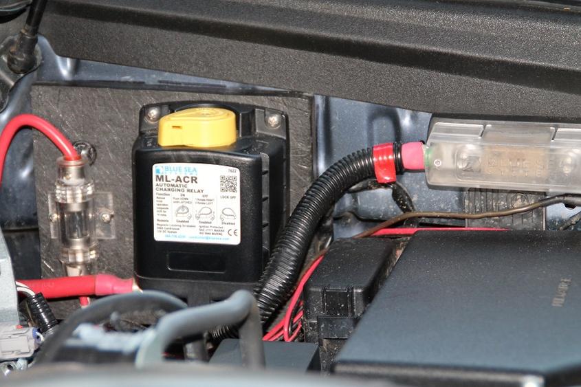

Blue Sea 7622. Expensive but idiot proof. I also upgraded all my cable to welding or marine grade #2 AWG.

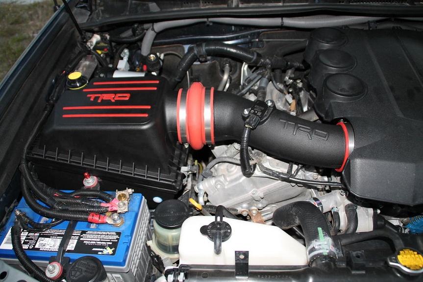

Drunner, what engine do you have? How big of a battery were you able to fit, and where did you put it? I'm trying to do a dual battery system in my '07 V-8 Runner. Trying to find enough room for the second battery
I have the V6. Stuffed it on the passenger side near the firewall in the corner. I think it's a 24F Marine battery. Can't remember but it's pretty big. It's raining right now but if it stops I can snap a picture of it.

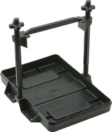

I used cheap parts that have worked very well. It took some creativity to move the powr steering res and bend the hold down hooks just right. There is a reinforced pad in front of the fenderwell that the right hand drive vehicles mount their batteries. Tray is an attwood marine from walmart and the hold down bracket and hooks are from a parts store. There are factory holes the hold down hooks will hook into if you bend them just right. I dont have a write up but you can make it work with some patience.

Thanks for that. I'll see if I can't do similar.

Blue Sea ACR

I've seen lots of good system... ACR and DC-DC are two really popular routes. It really helps to know what it is you are trying to accomplish but the rest of it past the core wiring and charging controller is really just accessories and personal preference.

"auto switching" is great... Its not like its any more complicated to install, or even that much more expensive.
Blue Sea stuff was designed for marine / boats. Their gear is high quality and very reliable. <$100 gets you a quality ACR.
You can read a write up on the two I used here.
http://www.toyota-4runner.org/engin...cr-automatic-charging-relays.html#post2642084
I never really have to worry about switching anything on or off. You never run the risk of accidentally leaving your starter battery combined and running both flat. It provides far more convenience and saftey. You also never have to worry about remembering to constantly switch it on to maintain the battery when when not in use.
Too many things to worry about and remember on the trail... I just need it to work without user intervention.
