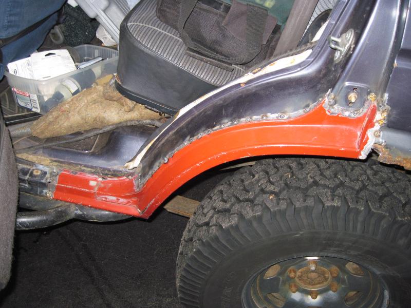

So how do the shops access the dog leg? that is the area where you open the rear doors, in front of the rear tires. I agree I don't like drilling holes, but this area either has to be accessed from a rear rocker panel plug (factory) or a long wand in from the tail light opening. Just know this area I'm trying to rust proof is a usual area for rust on 4runners as they get older. My climate is very humid, next to the ocean and see 6 months of winter every year. Want to keep my 4Runner for many years. To put it into perspective the F250 at work had its box runners rot off in 5 years, and needed complete replacing.

To be clear the area I'm talking about is the orange area, I have been looking at old rusted ones and it looks as though the 32" 360 degree flex wand should be able to gain access through the rear most factory plug in the rocker panel.

Yikes. I don't ever see rust that bad unless people are actually driving the vehicle into the saltwater to launch a boat. Three sides of my state are ocean, and we get slammed with salt in the winter.
That picture was just to show the location I'm referring to.

I just went out and had a closer look under my 4Runner. The only factory plugs on the back side of the rocker e panels are towards the front. None back past the front doors. Looks like the area I'm concerned with accessing will need a long wand coming in from tail lights.

Stumbled across an access point in the rear, where the factory jack and tire iron are located. You can easily access the entire rear quarter panel from here. Now just need to find a way to access the passengers side rear quarter panel.
