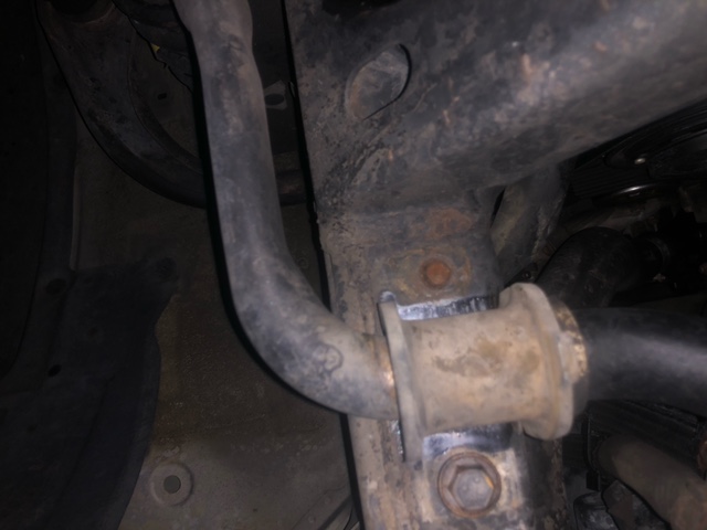

Included a pic of my front sway bar, the bracket was missing but i found that in a junkyard. but when i went to install, one bolt is spinning in the hole(stuck), and the other is obviously broken in there from the picture. i was thinking go up a size in bit and retap the hole to another thread size.... what you guys think??

regarding the broken swaybar bolt.. that's crappy.. going up a size would work, in theory, but you still need to get both bolts out. My only concern would be tapping the one hole closest to the support member since you won't be able to get fully turn the handles.... maybe if you used some sort of an extension .. but you get the idea. I've gone up bolt sizes all the time to fix similar issues.
It could be easier to try and carefully drilling out the bolt so you don't screw the threads up too much and then just chasing the threads to clean them up, but that depends on why your second bolt is spinning.. something is stripped .. either the bolt or the threads in the frame.
I would try drilling/tapping first. Obviously you'll need to cut the one that's spinning and drive what's left up into the frame. Depending on where this falls there are sometimes holes in the frame you can drop a bolt through from the side. Lastly a Rivnut setup would make for an easy fix.

I would take the painstaking process of drilling out the bolt thats broken. In terms of the one thats spinning, try to see if you provide some good downward pressure on while ratcheting. If you can get some help, or hold part of bolt with pliers and pull down, slip a wrench between the head and rest of the bolt to push it down and see if you can get it to catch
Ive tried about all ways with my skid plate bolts that have frozen - using a larger bolt, retapping and using rivnets. I had the most trouble with re-tapping

cut the one that was loose and took the piece out with a magnet. theirs definitely not enough meat to thread that hole, so most likely gonna fish a bolt into their and use in impact to get it on tight.

The sway bay bracket is a captive nut on the inside that's broken loose. I've seen people cut a hole in the frame, weld a new nut on, and then weld up the hole. I'd be suspicious that just tapping the thickness of the frame rail would produce enough thread to reliably hold the bracket on.
