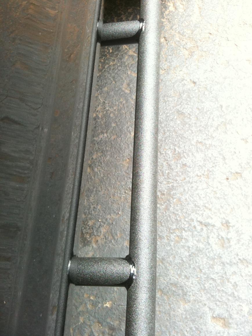

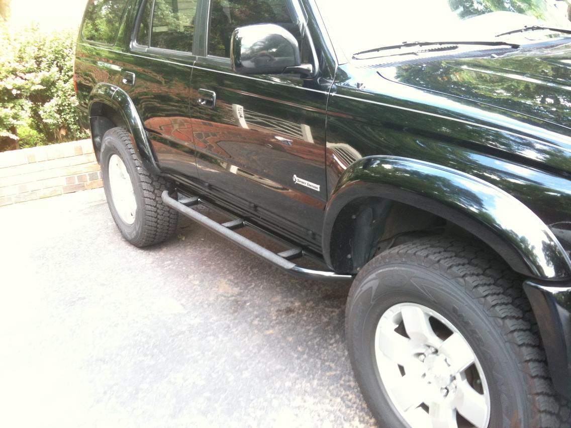

I painted mine with Rustoleum Professional High Porformance.
Only had one chip so far in 2 years.
3 cans of primer, 3 cans of black and a roll of good Grip Tape and you are good to go.
The grip tape is key, great traction plus wont ever chip where the tape is.
I have had 2 car doors slam it pretty hard and not even leave a mark.
That's an awesome idea, I may have to steal that. Rocks wouldn't hit up there to rip the tape off so it would be perfect.
Is the grip tape just around the welds? That looks great. And where do you get the tape?
You can get the tape darn near anywhere, I believe I got mine at Lowes Hardware but virtually any hardware store sells it and I would assume Amazon.com also.
Yes I cut the tape so that it just "misses" the welds, so its everywhere but the weld and it goes down at least 1/2 way around the tube, so the bottom is paint but the top and the side is grip tape. That way when some dinkus slams their car door into your slider it just hits the grip tape which is tough as nails and can take a pretty good beating.
Can see how the tape goes on this pic
