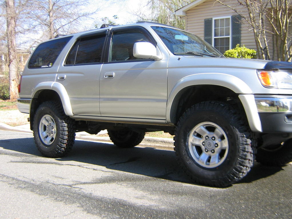

The only problem you might run into is some shops (usually chain stores) won't mount a 285 or bigger to a 7" rim. As far as safety, I know people who have mounted 315/75 (35s) to stock 16x7s without problems and I have personally ran 285s on stock 7" wheels so you'll be fine. Another option is to run 255/85/16s which are ~33.5x10s. I like my 255s a lot and highly recommend them.
255/85 R16's here, articulate it a little bit at full lock and bingo you got rub. Ofcoarse I haven't modified any pinch welds or plastic or nothing to that sort yet and I just have a 3 inch spacer lift up front. Maxxis website claims 33.3 inches in diameter, 10.30 inches wide... all on a 7 inch wide wheel with 19/32
of tread depth?
Looks good man. **** ton o ground clearance for spacers and tire. Looks a lot higher than my 4th gen with DS 2.5/1.5 and 285/75r16's...........
