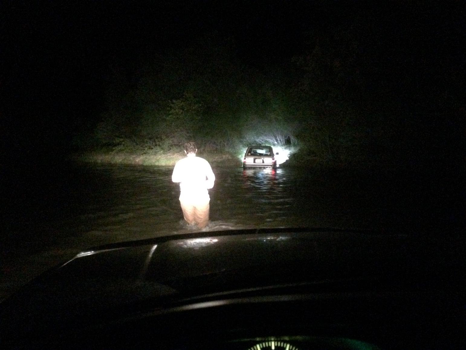

Forded the gila river on saturday sort of...
Starter is still not functioning however jingling it works. Also heres a picture.
