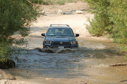

Water
I think I will skip the fun and keep going slow.
This was deep enough for water to hit the fan and I had muddy splatters on the top engine cover.

OP - if you expect to be fording water in the future, watch a few YouTube videos or do some research on how best to do it to mitigate the risks. 4-5mph is about tops. You'll learn about a 'bow wave' and how not to travel faster than it.
As shown by [MENTION=66300]Intruder[/MENTION], 4Runners are more than capable of going through some wet stuff.
Given enough speed hitting water is the same as hitting a brick wall :frusty:

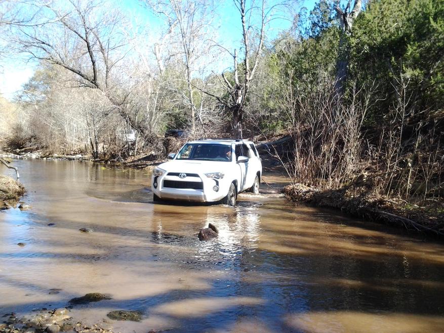

If you want to go fast then the water can't be that deep. If going into deeper water you must do as the others suggested and make a bow wave - simple really but the key is to keep moving at a slow steady pace. See Bob's picture to see what it should look like.
RCMudWings_zps48cfa359.jpg~original
