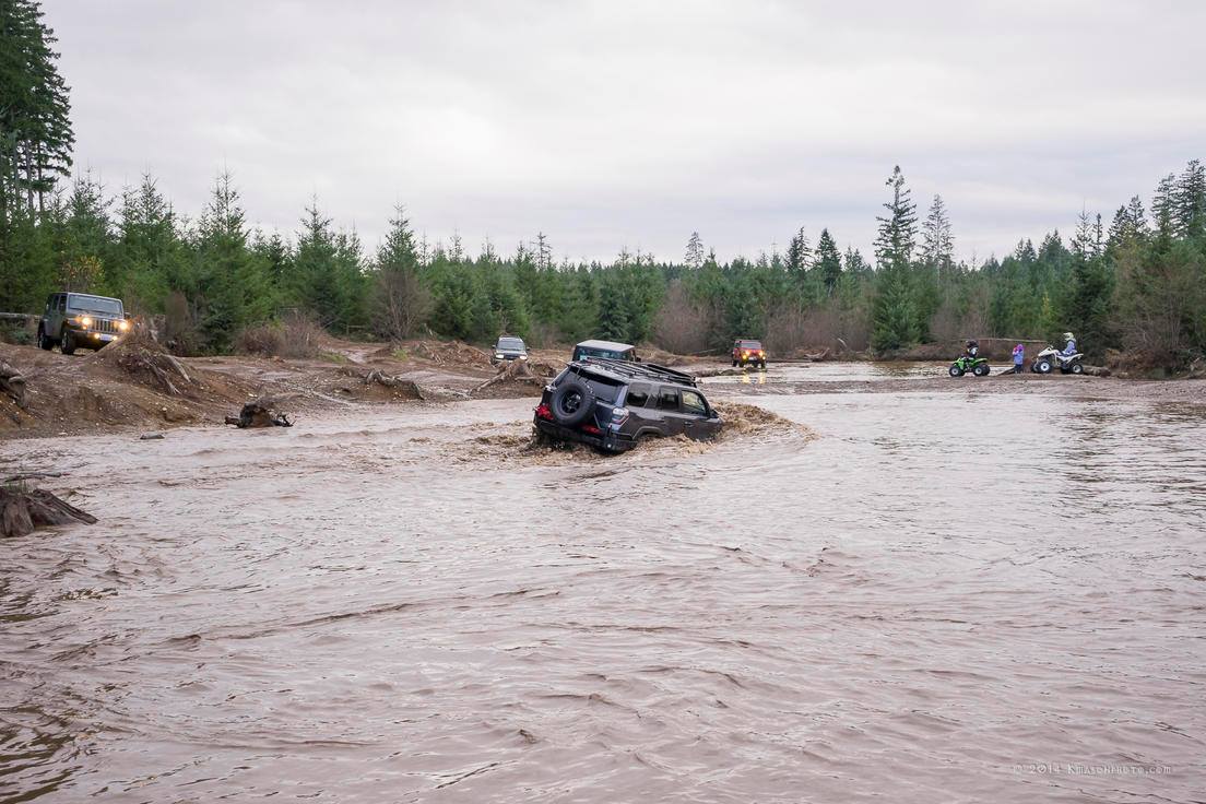

Quite a lot deeper than I thought, but once I committed, I had to push through. Luckily no water got in the intake, but it did get into the rear diff (I hadn't done the mod yet). If you plan on going through water deep enough to cover the rear diff, expect to get water in it if you don't have the mod done!
