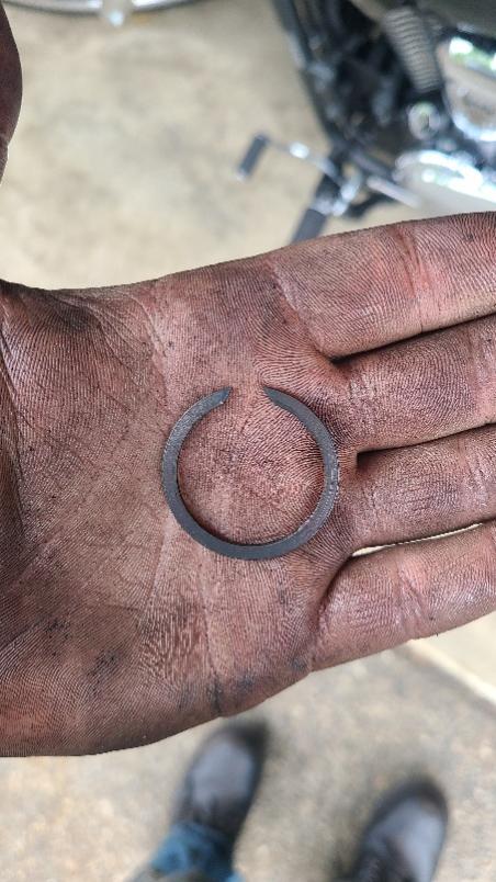

Hey all. Had to reboot my CVs today and I forgot to put the snap ring back on my passenger axle before putting the tulip back on. On top of this I don't have any spare clamps to use right now if I was to take off the boot to put it on (the OEM re-booting kit doesn't include extras)
Is it fine to drive around like this until next weekend or is that snap ring more crucial than I assume? I can't see the axle traveling that much for the splines to completely fall out, especially from a few days of highway driving, but a second opinion would be cool. It's there for a reason after all. Last thing I need right now is to grenade my CVs

Pic related is the one I'm talking about: the big one securing the rollers to the axle shaft, not the small PITA one that goes into the diff itself

Why take chance of it sliding off end of shaft during articulation? And I see that happening as that's why it's there!
Suspn cycles spider is deep in cup as it extends what if spider sticks it going to pull shaft out of spider.
