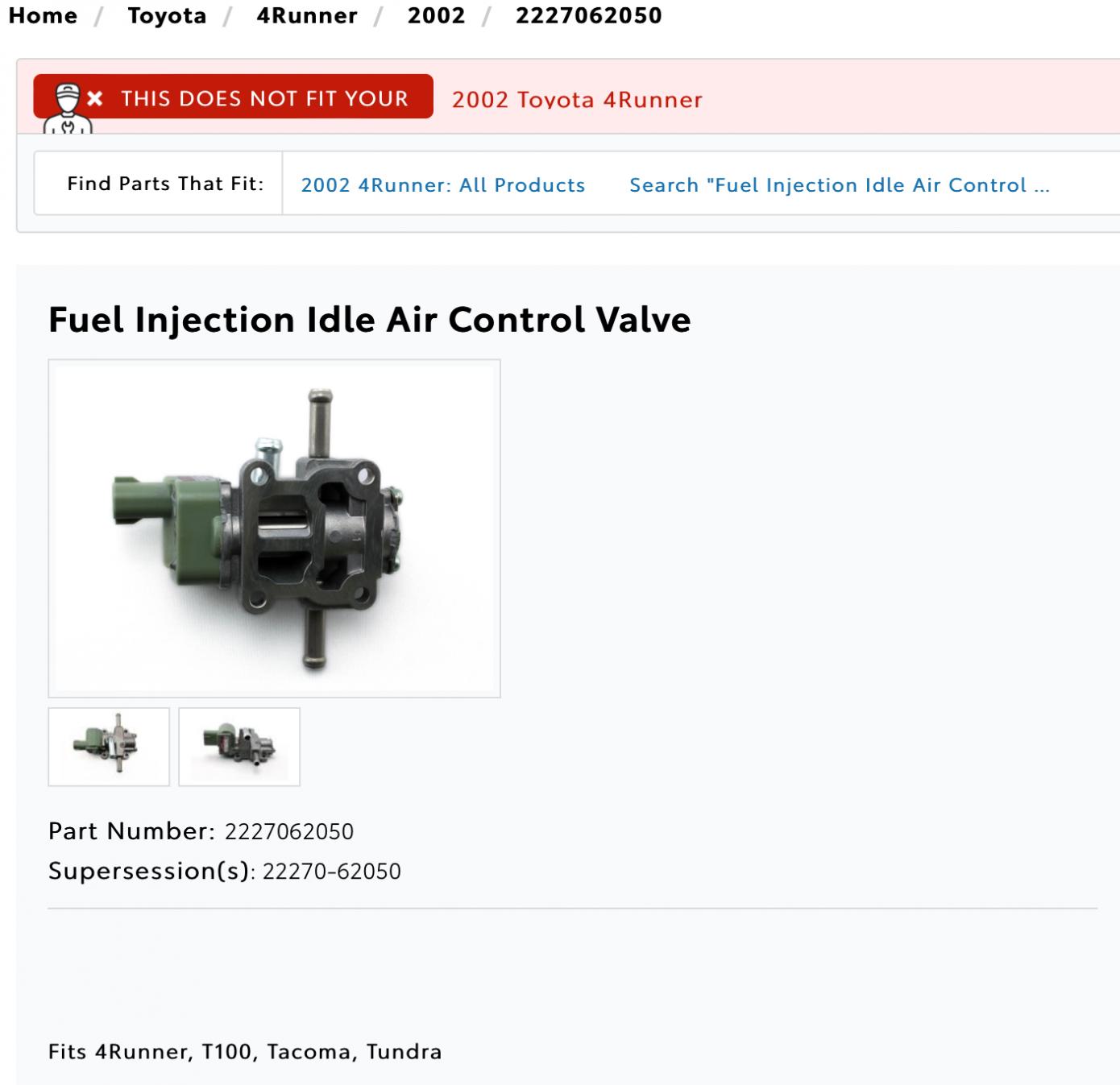

Sounds like the the IAC sensor. Was that gone through when you did the throttle body cleaning?
Unfortunately I don’t think the IAC is serviceable on 01-02 models as it’s part of the throttle body assembly but correct me if I’m wrong.
This is becoming a major problem for me if it’s the IAC.
I think you’re confusing the IAC with the throttle position sensor. Toyota lists the throttle position sensor for 01-02 as not serviceable.
Unless I’ve got wrong part number it shows not a fit for 02 model year.
I think they made change in design for 01-02 models.
Please tell me I’m wrong as can’t imagine having to try and drive back home 1200 miles with a bad IAC and irregular idle in traffic and on highway.

Just off the phone with parts department Conicelli Toyota.
Confirmed 02 AIC is only serviceable by replacing entire throttle body assembly, part #2203062020.
Assuming that is my problem I need to track one down locally here in Ft Myers's area and find shop to replace as I have zero tools with me.
Anybody have shop recommendation and or dealer recommendation on this area?
Looks like I can have new throttle body assy and gasket shipped directly to Naples Toyota and have them complete install on Wednesday.
Not terrible as install is straight forward so hopefully it goes smoothly.
Hopefully diagnosis is correct, sure seems to be classic symptoms of bad IAC so should be good to go.
