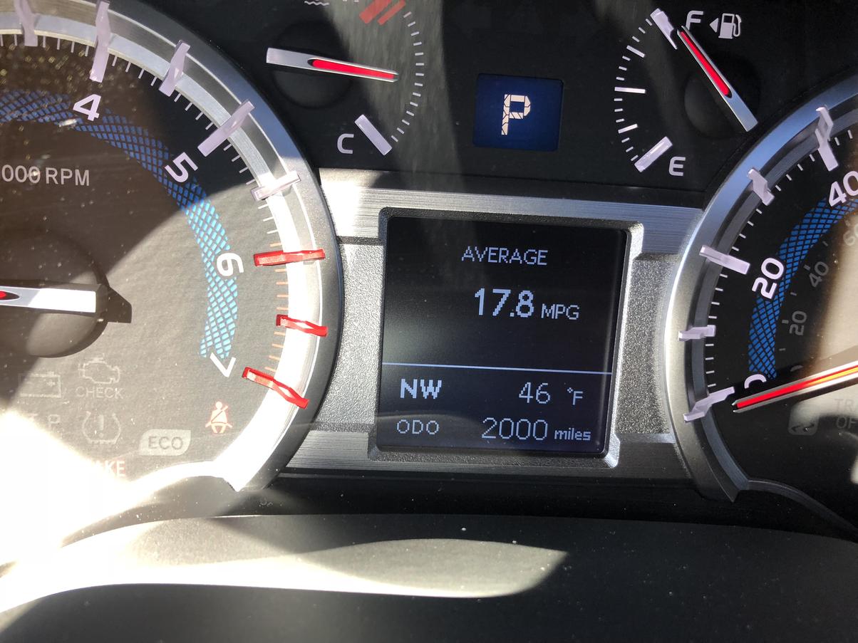

I'm the managing owner of my wife's 2014 LE with 17" TE wheels and Nitto G2 265/70 tires. Her MPG never sees more than 16.3 with 100% city driving. Her right foot is a little heavy. I put on a little over 1200 miles with the 20" pie cutter OEM wheels/tires and averaged 17.9-18.3 MPG. That's with a split of hwy/city driving. I've since installed FX Pro 17” with Conti Terraincontact AT 265/70/17 tires. My MPG has stayed the same with 800 miles on this wheel/tire setup. It's all in the right foot. I'm getting better MPG on my 18 LE S/C than in our 14 LE. Of course, this is easily erased by the right foot. I don't race the truck nor do I burry the pedal. It's not a race car. Which leads me to my comments on the S/C itself.

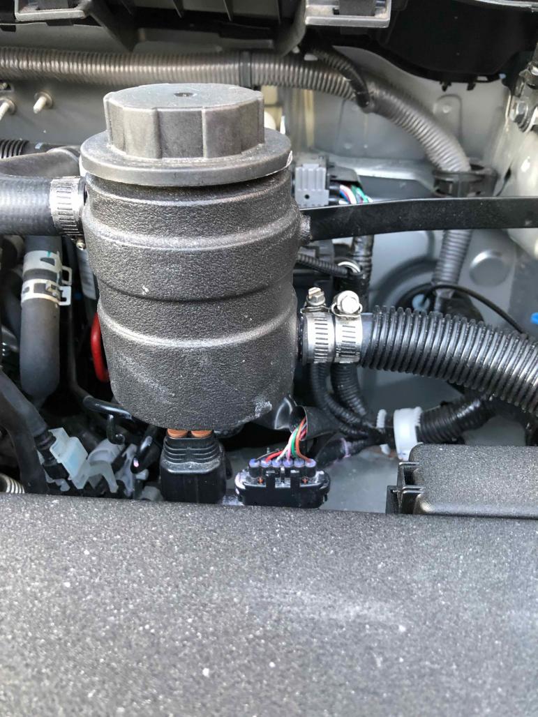

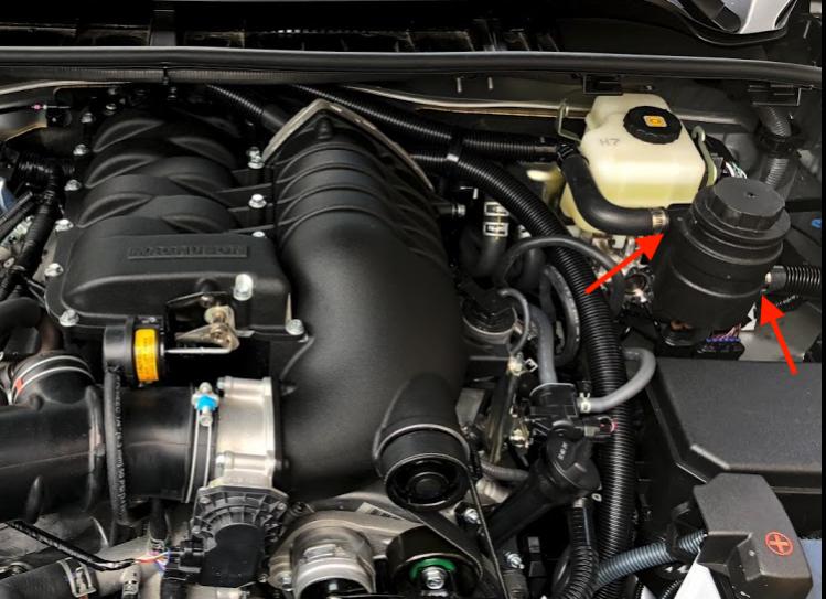

One issue to date. It's a known issue with the reservoir tank. Both the upper and lower hoses had small leaks where they connect to the reservoir tank. I had the exact same issue on my 2011 Tacoma with the TRD S/C (but the lower hose leaked at a much higher rate) it literally drained out on my garage floor the very first night after installation. My reservoir was down about ¼ of the tank capacity and was dripping from both hoses. I noticed the leak about 2 months after installation and when the weather swung from 60F to single digits. This likely had an effect on the rubber hoses connected to the hard-plastic reservoir tank. I checked my tank everyday for a week after initial installation for this specific leak (experience from my Tacoma install) and didn't see a drip. My fix for this was simply tightening the upper worm clamp a half turn. That fixed the upper hose leak. The bottom hose leak turned out to be a little more frustrating. The leak remained after a half turn (even ¾ of a turn). You need to be cautious because you can crush the plastic nipple with too much pressure from the worm clamp. I used the same fix that I did with my Tacoma. The nipple is long enough for 2 worm gear clamps. Make sure the first (nearest to the tank) is as close as you can get it. Place the second worm clamp right beside it and both clamps will be on the nipple. I then used a heat gun (it was below 20F) to heat up the rubber hoses as well as the plastic tank. Cinched up both clamps and that has fixed my leak.
A more elegant fix can be found here: Updated w/fix! Supercharger coolant leak on the reservoir | Tacoma World
That fix addresses the oversized coolant hoses in relation to the reservoir tank nipple.
I was going that route if my two worm clamp fix continued to leak.

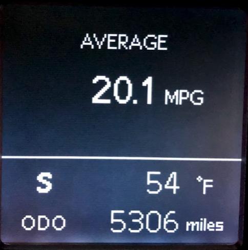

The switch over to winter blend has affected my MPG a bit. We did a PA turnpike ride logging a bit over 600 miles up over the mountains and the trip computer had me at 20.1MPG for the trip. My normal daily driving has me at 16.5 MPG. For comparison sake, my wife's 2014 with the G2s is now at 15.1 MPG. Her tires and her right foot likely have something to do with that. My Contis are not as aggressive as the G2's nor is my right foot. I'm fully confident if she used my truck as her DD the MPGs would dip. That being said...I'm not seeing a drastic (or even minimal) change in my MPG with the S/C. Yes, the higher-octane fuel is required, but I'm thinking folks on this forum did not purchase the 4Runner for great MPG. Bottom line, the S/C has not negatively affected my MPG. Your right foot will have more of an effect on this variable.
