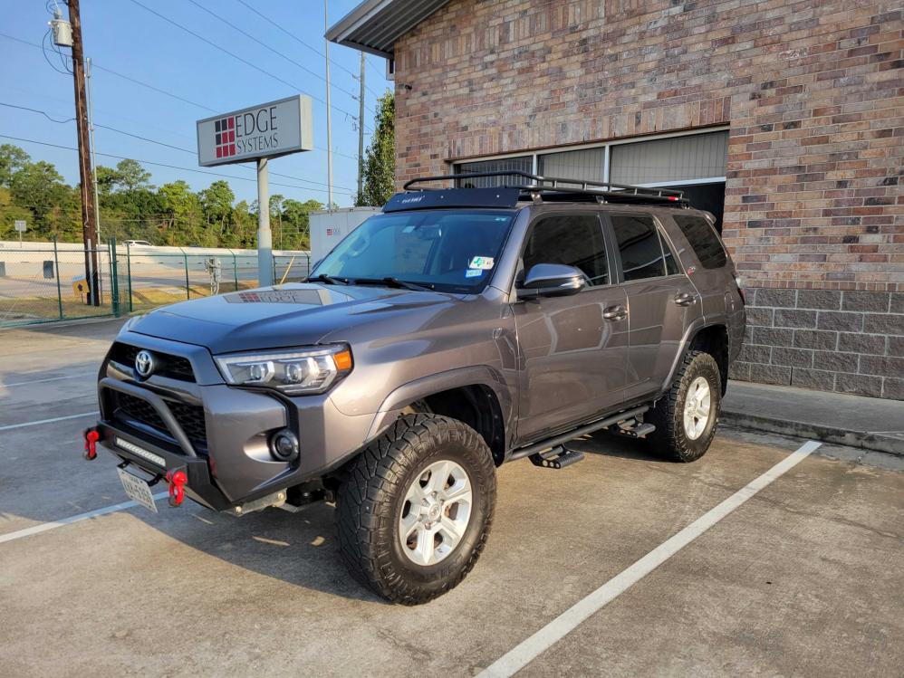

I saw this and figured I would join and chime in. I installed my Mag SC on my 2017 about a year ago while the truck was at a nice broken in 85k miles. I was debating on lower gears or SC.. went SC and still my add lower gears
Now she is at 105k and I have never regretted the decision. I have a 3" OME suspension lift at Medium weight, full RCI under carriage armor, Full length Goby Rack and a southern style Slim line with approach "flares."
It is on stock rims (still have not chosen a good wheel) and 285/75/17 Ridge Grapplers
All that weight hurts and the SC made it to where i can keep up with minivans now! Joking aside.. worth it but here is an honest pro/con at 20k

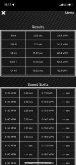

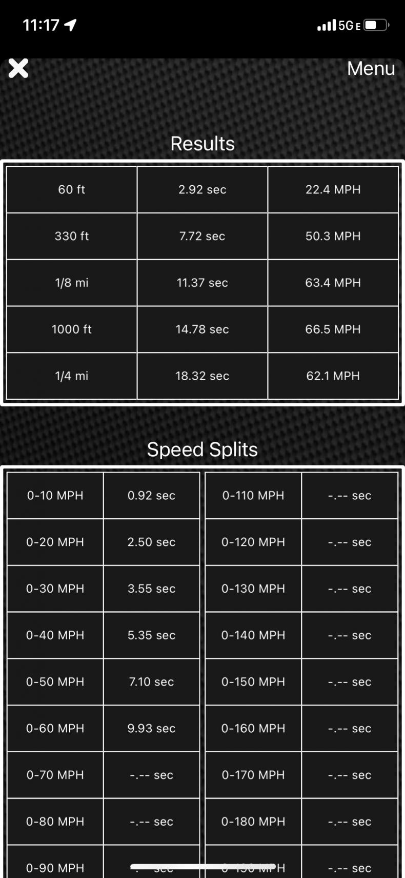

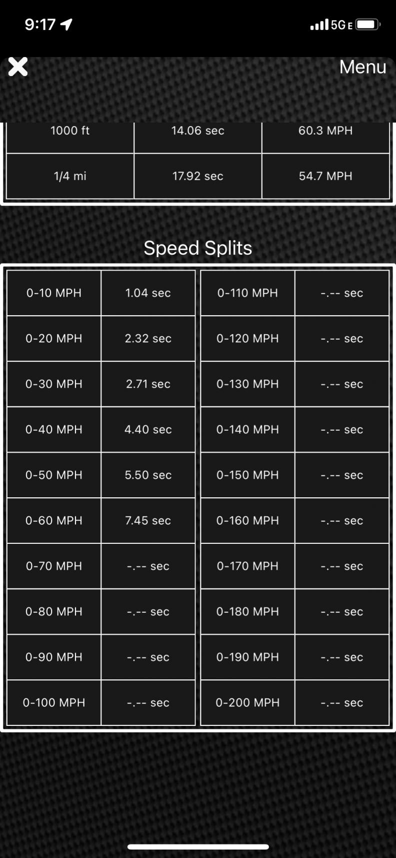

I tried to post performance data from my obd2, before and after supercharger. Standing start, accelerator to the floor and let off as I passed 60mph. Not real scientific but you can see a significant improvement.
