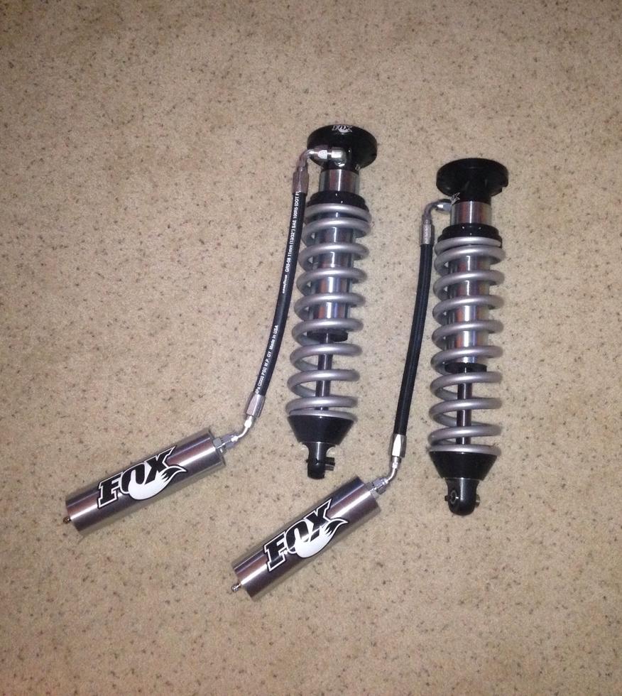

Should have these on in 3 weeks. The reservoirs are much more substantial than the Icons I was running on my Tacoma ...

Yeah. Trust me, they're teasing me more than anyone else while just sitting on the floor in front if me. :)
I plan on doing everything in 24 hrs - front co's, front AOR plate bumper, rear SS 1.2 kit, read AOR bumper, new tires, etc. (alignment the following day)
I'll put a build thread through the following day.
This particular set is setup with 600# coils. I was initially thinking 650's, but decided to run the present springs with little pre-load.

Most vendors have them listed for 1450 to 1550 ... was able to get them for a bit less.
Worth it for everyone? No. For me? Yes. I like having an adjustable CO that is rebuildable and tunable. I really like that the bodies on these are zinc coated, similar to Bilsteins. Great for wet / snowy weather. I'm not a fan of the shafts being chrome instead of nitro steel like my Icons were. I'll have to see if they pit easily with winter weather / mag chloride exposure.
I will probably go with 2.0 with resis in the rear eventually, but I'm going to see how they match up with LC Tokico shocks for the time being.

When I bought mine they only had them for a tacoma( 4runner mounts are 15º different). When I installed my 2.5 fox coilovers I had to redrill all 6 upper shock mounts. Hopefully the ones you bought are 4runner specific.
Yeah. We'll see when the day comes. The manual says "4runner 1996-2002", but lists the 1st gen Tacoma as well.
I don't mind re-tapping the top hats if it comes to that. There's details about these coilovers from Fox that impress me over the Icons that I ran. :)

I knew when purchasing these that the resi placement would be a "one off" situation. They came with brackets (I haven't looked closely) which I was told wouldn't translate to the 4runner.
I'm not too worried about the resi hose, but I do realize that the placement of the reservoir and hose routing will affect its possible contact with the UCAs when in droop / extension.
That's a +1 for Icon. Their hose fittings and resi mounts made it almost impossible to have contact issues.

I absoluetly love these coilovers and you made a great choice. The 600lb coils are really nice on road and do great on washboard type roads. I just took them on a trail today for the first time and it was mostly washboard/bumpy terrain and the front soaked up the road so well. I have the LC Tokico Trekmaster shocks in the rear with Superflex coils and they seem so archaic now compared to the front. The back was all over the place while I felt completely in control up front. I can't wait to upgrade to rear FOX's.
