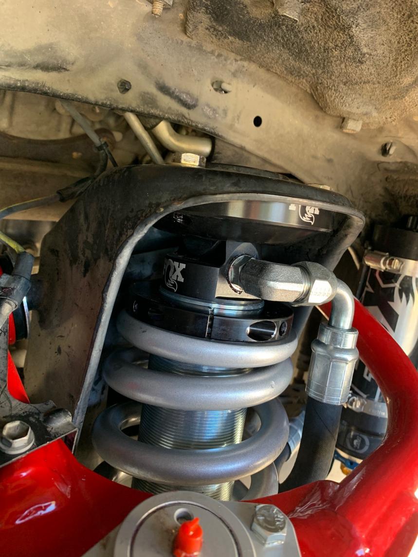

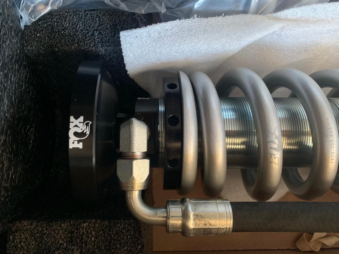

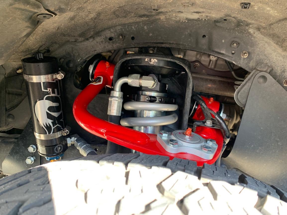

Installing Fox 2.5 CO with 600 springs. How much thread should be exposed in order to get ~3" lift? Out of the box is showing 2-3 threads, maybe 1/4".

They aren't too bad to adjust installed with that corner jacked up. Only loosen the pinch bolt enough to spin the collar, too loose and it'll jump threads. LUBE it up good. The spanner tools that come with coilovers are junk, get a big punch that fits the holes (3/8" I think? don't quote me there). Mine have ~1-1/4" thread showing for 3" lift v8 with dual battery and twin compressor up front, no bumpers or winch.

My girlfriend has the normal 2.5" Fox coilovers, I would assume the spring is the same but I can't find any markings saying the rate that are (easily) visible. She's at 22" hub to fender and 2.75" of thread showing. She has an aluminum plate bumper and that's it.
Counted mine for ya, I have 12-13 threads showing above the collar. There are older versions with shorter springs which might be where people are getting the 2.75" thread showing. I know looking at another guy's build before I bought mine he had about 3" of thread showing.

Thanks for checking. I'll count 12-13 for a starting point and set the driver side a little higher. Hoping it's not too difficult to adjust on the vehicle.

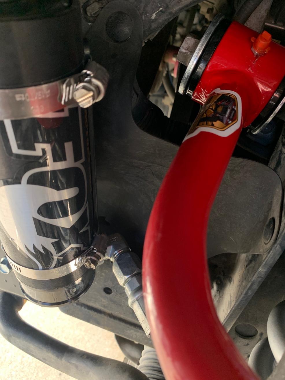

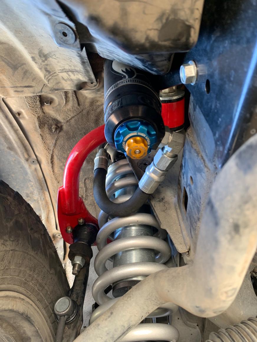

Initial update here. Passenger side was a pain as the resi bracket arrangement is very tight. Driver side was much faster. UCA were probably the easiest part of the hole thing.
Also I wish Fox would use studs on the top hat as that would make it more of a one man job. Lining up bolts is tough while holding the CO with the other hand.
Fox was 100% correct in that the CO's were set for ~3". I guess the discrepancy is the these came with 14" 600 springs instead of 13". This is great if you're looking for 3" with almost no threads showing, bad if you want 2.5" or less. I supposed you'd have to go to 13" springs.
Pics below, hub to fender driver is 23" right now, and 23.5" passenger. I still have a little adjustment left but seems like I will end up 23 1/8" both sides to make it even.
Sway bar doesn't seem centered, off by maybe 1/4"?

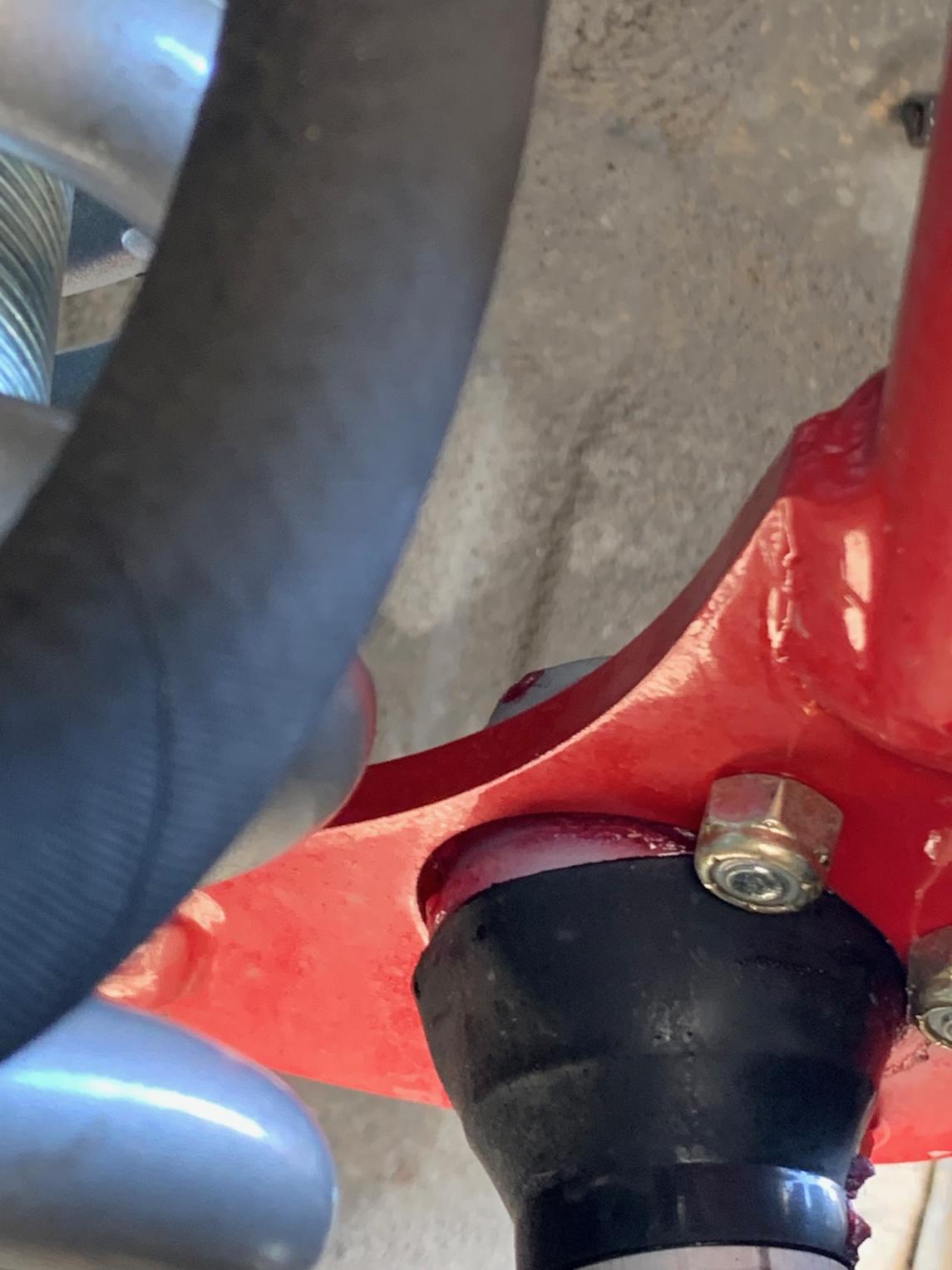

UCA boot seems to leave a portion of ball in the back exposed? Need to email JBA.

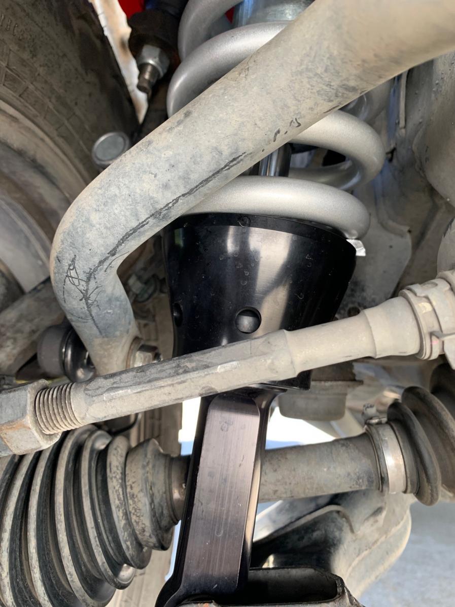

ABS sensor lines end up too short so you have to improvise the brackets a bit.
I got 3 degrees+ castor back after driving around for 4 years at 0. I will probably ask them to set at 4 next time.
Anyway I'll stop rambling and post more updates later, rides like a dream compared to 5100's but I'm still trying to sort out adjusters.
