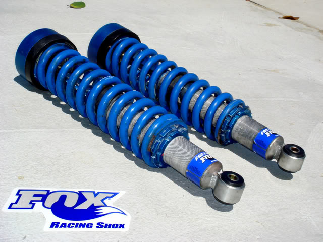

Need Advice guys. I found these Fox Fabtech coils for a good deal ($300 shipped fresh rebuild) and am wondering if I should get them or not. I have seen so many differnet view points on them. I need a new set up, up in the front but I don't want to waste money. If this is an honest to God good deal I could use the saving for the rear but if not I'll put up the money for something good this time.

If they're Fox's they should be good, and that seems like a good deal. Since they say Fabtech that's throwing me off though since I'm only familiar with them doing drop brackets, which would make me think they're coilovers meant for a huge lift which wouldn't work with a stock geometry setup.
[MENTION=87781]97Run-Man[/MENTION] Compared to the factory struts and coils they're fantastic, but compared to an Icon 2.5 remote resi with CDC valves they're junk. It depends on what you're going to do with them. If you're looking at hardcore higher speed wheeling while carrying a bunch of gear then they will probably not be the best choice. If you're doing mild off-roading they'll do fine. Regardless they're much better than the stock setup. I ran them for 10+ years in my Tacoma, and the only time I had issues were when I was driving fast on bumpy desert trails as the shocks would start to fade and needed to cool off.

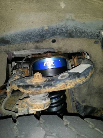

I picked up a used set and just recently rebuilt them myself. Way better than my stock suspension that had 180k. I paid 150 for them used and put 80 bucks into rebuilding them(lower bushings, seals, oil) myself. I had never rebuilt suspension before so it was a learning process. But was really rewarding doing it myself. Now I just need to install my 8 wraps this weekend.
[MENTION=120189]dmag310[/MENTION] so you're going to run these and 8 wraps? Thats what I've got sitting in my garage. I'm curious what it'll look like complete! :) Where did you find a rebuild kit if I may ask?

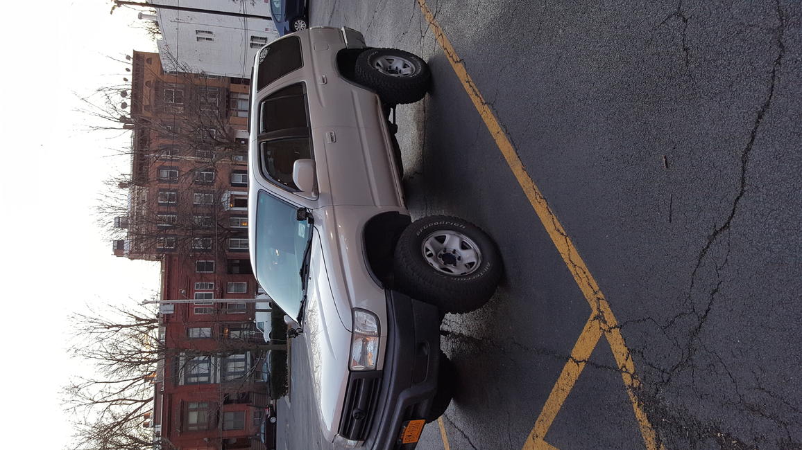

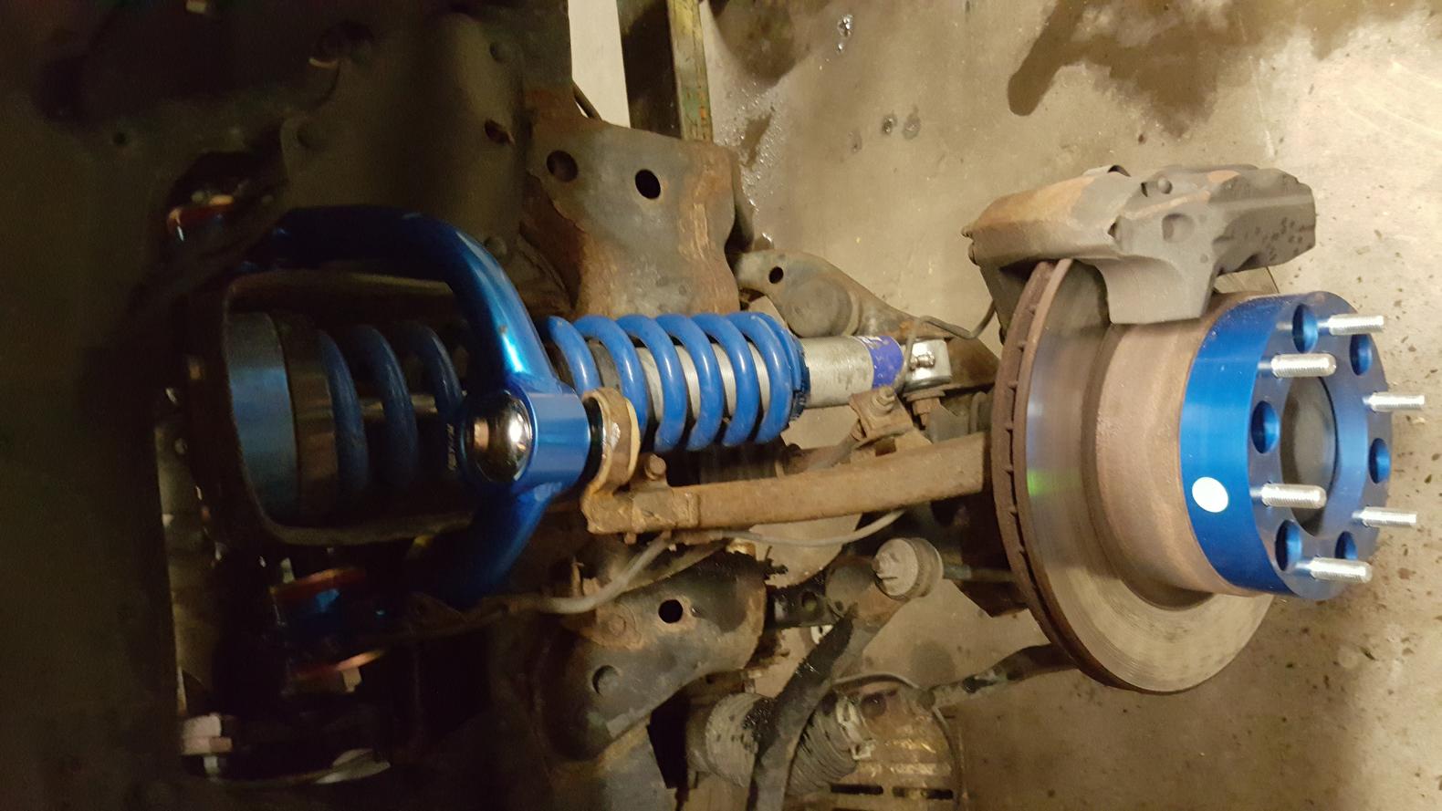

Ive been running mine for too weeks, major improvement over stock. Im running OME 890's in the rear. I wish i had gone with the 8 wraps instead...
