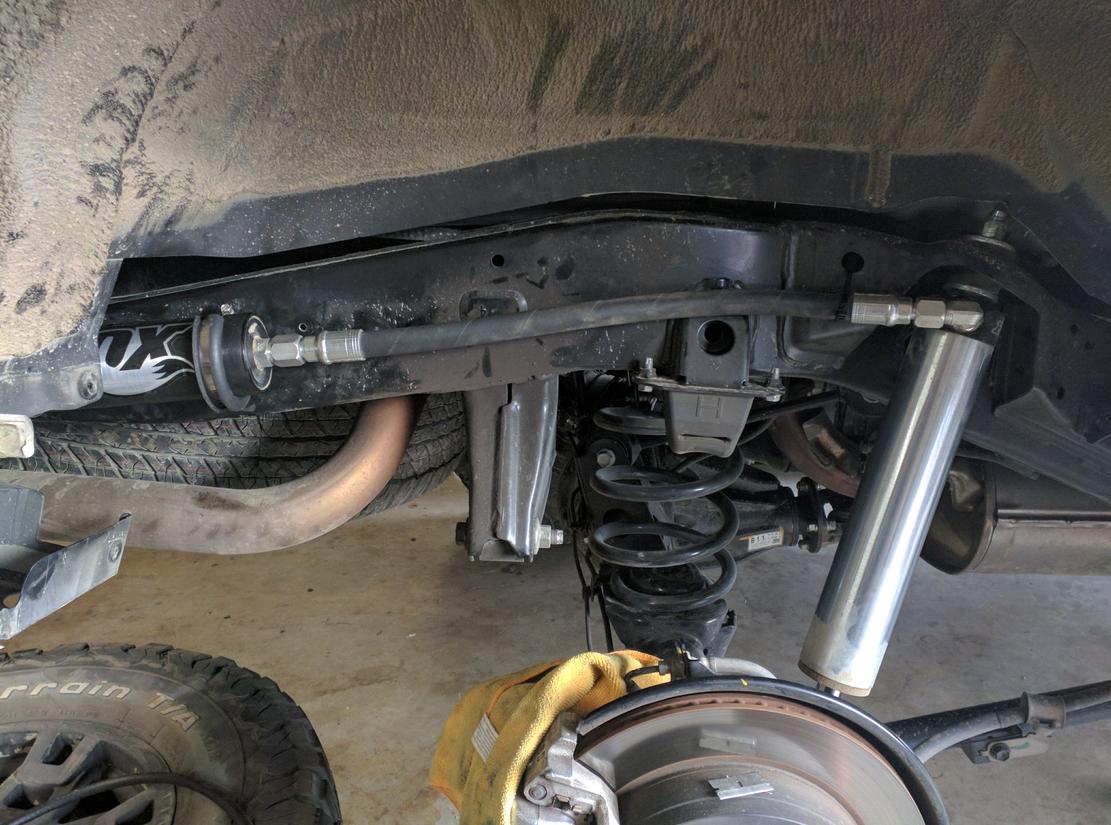

I have Icon 2in rear springs.

Fox Tundra 2.5's allow for 2" plus, just need to change out the bushing but that is all. It's been done here before so there's info on it.
Those are 2.5' DSC? in the rear?
part # 883-26-004 ?
what you have now looks like the 2.0's... I thought the 2.5s are attached
No I have 2.5 and they have the res line. In 4 wheel parts they show the same shock so I think its just a display pic :noidea:

For the rears, you can order the Fox's with a longer rod end. Should be an off-the-shelf solution- try reaching out to Downsouth Motorsports. For Kings, if doing a custom order, you can swap out the shock shaft to a Tacoma with the threaded rod end and swap it as well.
Currently running the above Kings in conjunction with a Icon Overland spring and OME rear trim packers for full 2" rear lift.
