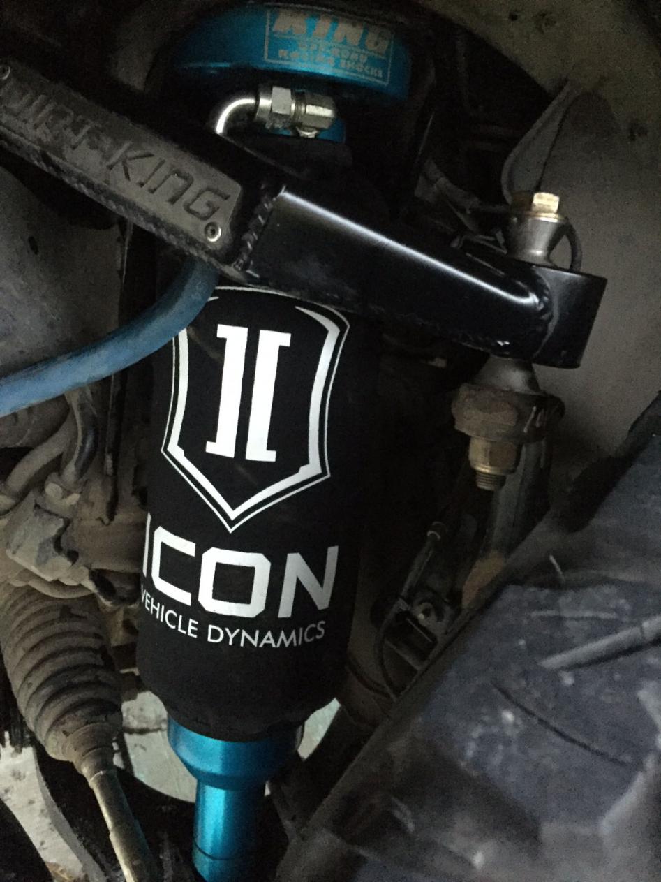

I am curious about coil-over covers, I have seen a few folks use them I am wondering how well they keep CO's protected, particularly in winter weather that killed mine.
I use the icon coilover covers, and they work great. I've got 3 winters on mine, and I'm going to replace them this year (the bottom elastic cuff is pretty relaxed now, not a big deal) The criticism that I read is that they trap stuff inside-- that's really not the case at all. I find critical reviews of these from people that have never used them. Same as the "don't use shock boots" crowd.
I throw mine in a bucket with some revivex (DWR) after I clean my fishing waders and jacket each season in said bucket. This keeps the water beading off of them.
They work very well for the winter. I think I paid $65 from metaltech 4x4, and I'll order my next set from them too.

Btw, I bought the Icon neoprene covers which I have seen on pictures to make for great protection but they are hard to put on already mounted 6112s.
