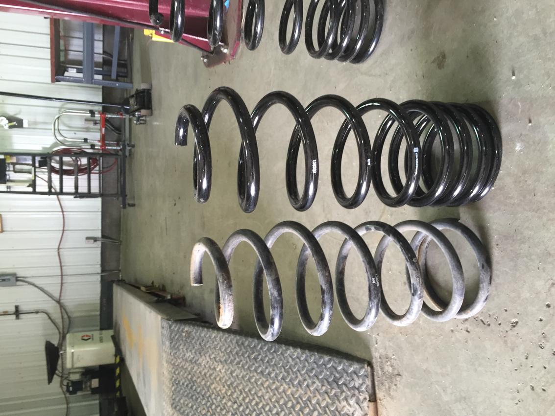

[MENTION=78170]foxtrot[/MENTION] Did you ever put in the new rear springs? I would love to see how they look compared to this:

Yep, sure did. It sits a lot more level. I'll snap a photo tomorrow for you. Here is a comparison of the springs:

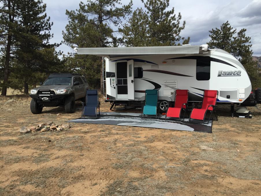

Nice looking trailer, how's it working out for you?

the trailer is awesome. the perfect size for some small family vacations. only had a bad CO2 detector so far so not too bad for a new trailer. the gears were right about $1450 all said and done (set up diffs, gear oil for break in and after break in, and some RTV). not horrible but not great either lol. They do have a 5 year warranty which is nice though.

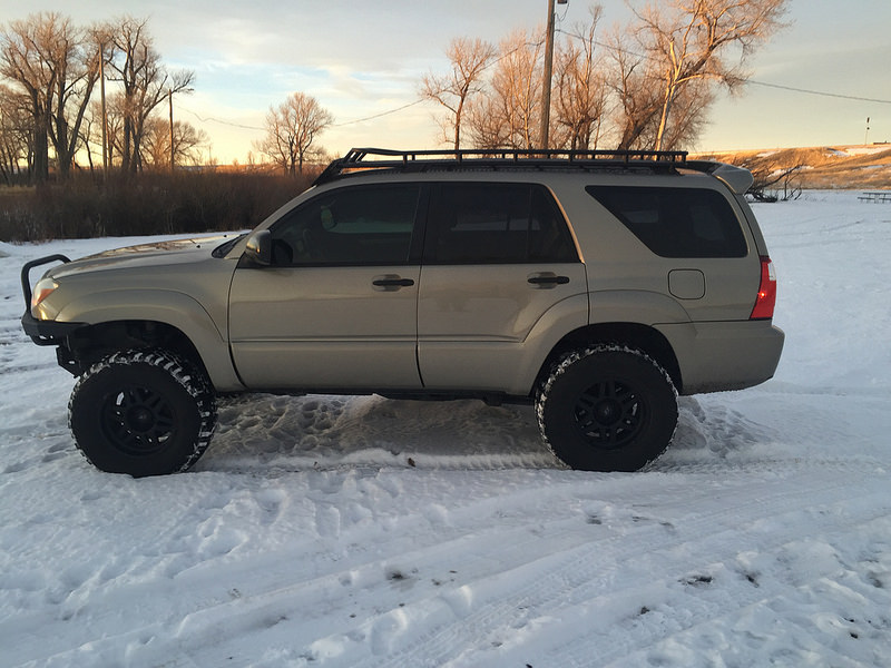

on to the photos:
Here is a side view. (note: my driveway is angled so take that into account.)
