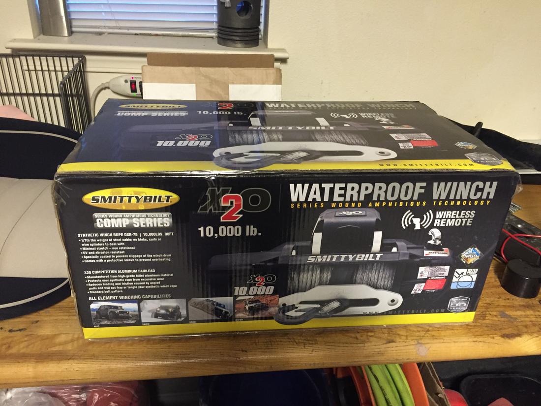

Hey, sorry I haven't gotten photos yet, been crappy weather around here, but I did get the first part of my Black Friday purchases :)
Ya, it was super fast. i recieved it before I even got a shipping notification from Amazon. The bumper is supposed to be done Friday, but I'm not holding my breath. AOR takes a little longer than some but his work is top notch and worth the wait. I'll take some detailed pics of it when I pick it up
