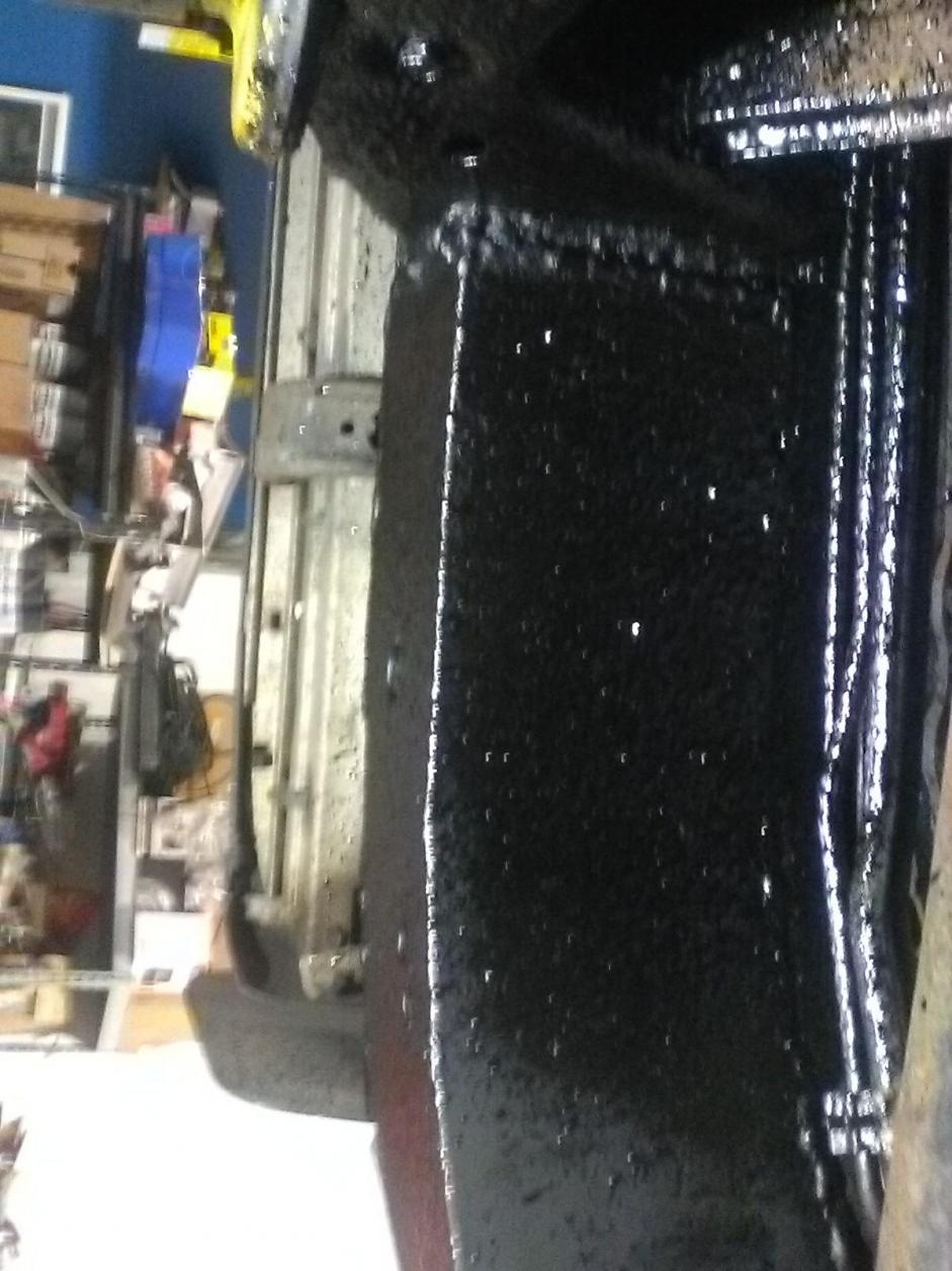

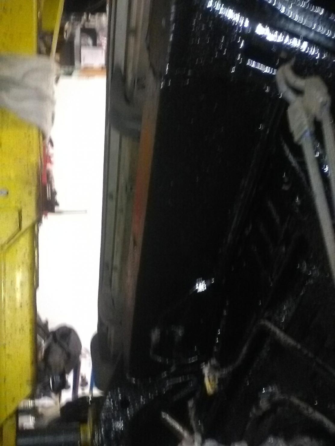

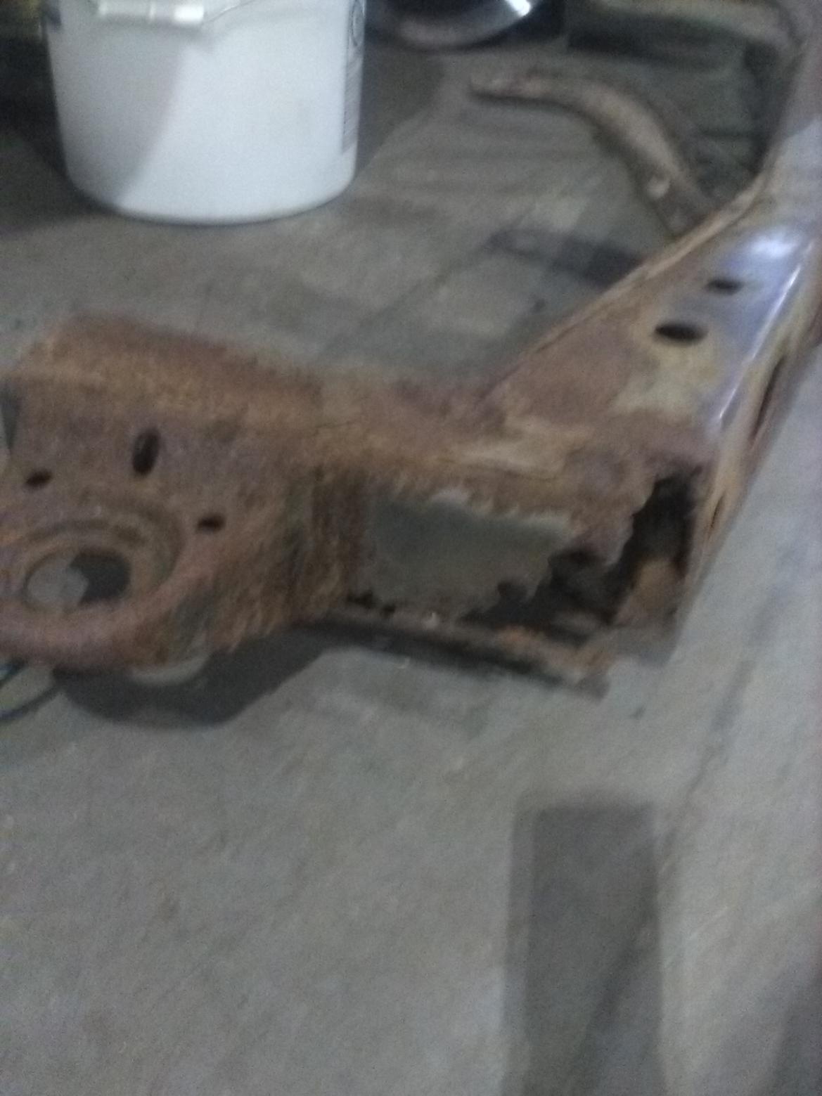

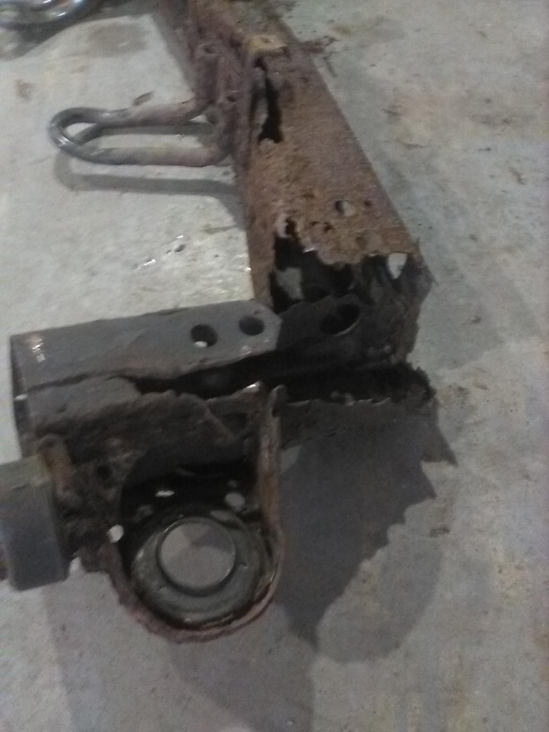

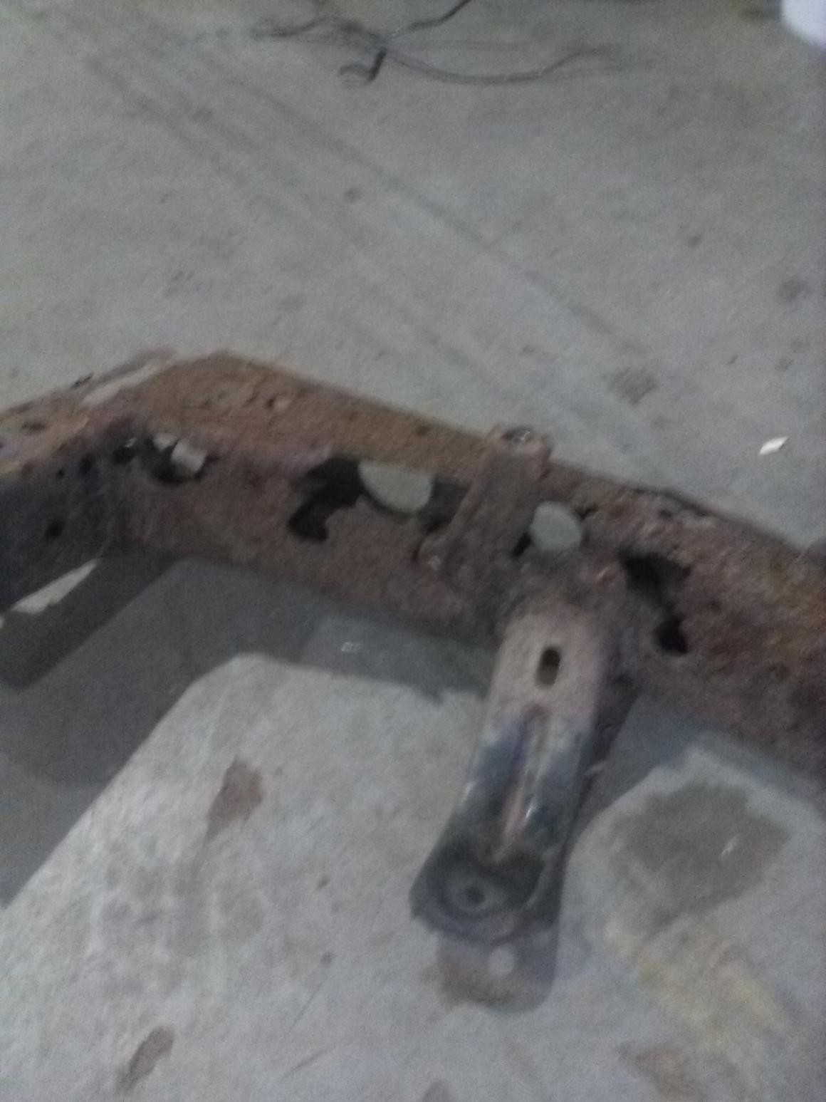

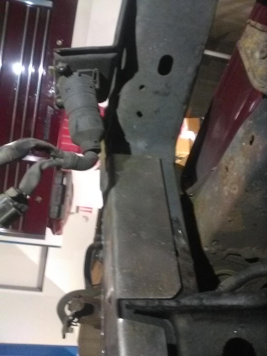

Missed the siderail frame "before" photos... Yianni had already completed the cutting and repairing. I do have the rear section photos (already removed from the vehicle) and the current status photos.

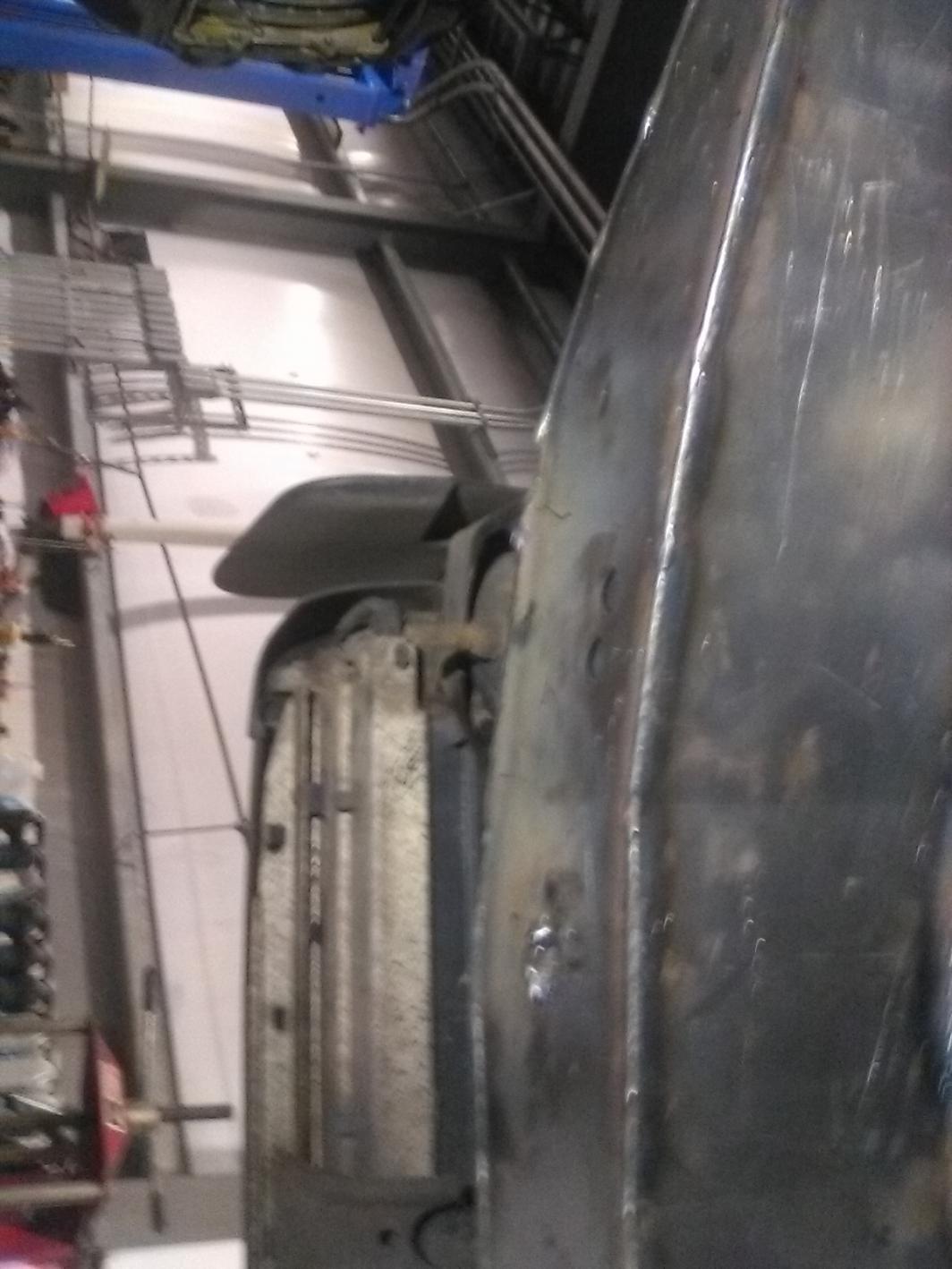

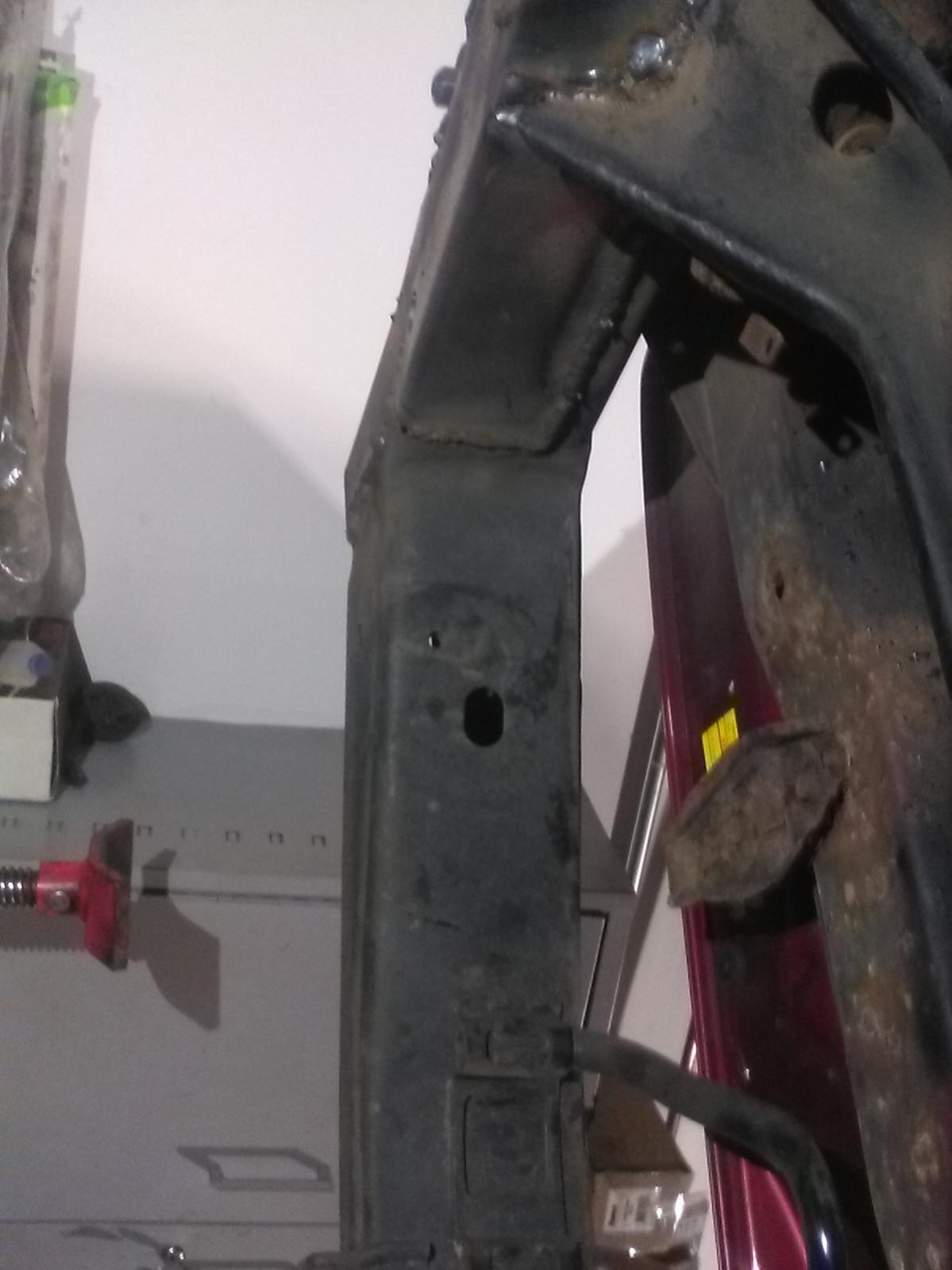

Left side completed, primed, painted and coated, right side cut and panel repaired/welded, rear section cut, repaired and welded.
I had him weld new panels along both entire frame rails, from shock towers to rear. 75% was not neccessary, but what the hell, he was there and easier to complete all at once now, than a little now and more later. Basically, I will have an entire new frame once completed.

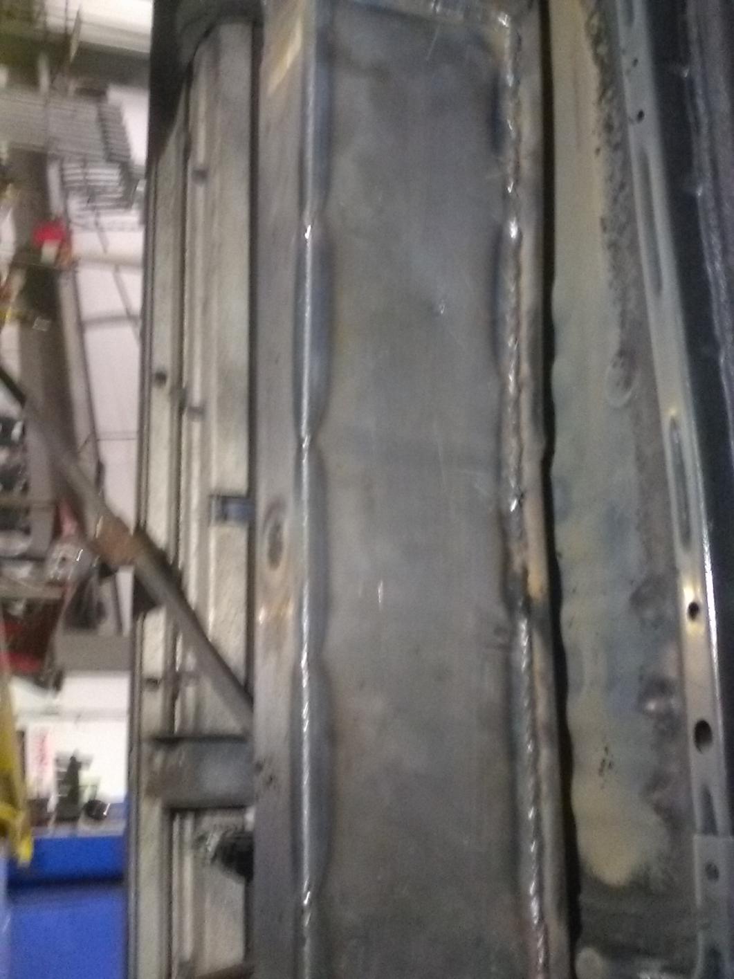

A few more...
Sorry if pictures are not entirely clear. I have an old flip phone, best I can do!
