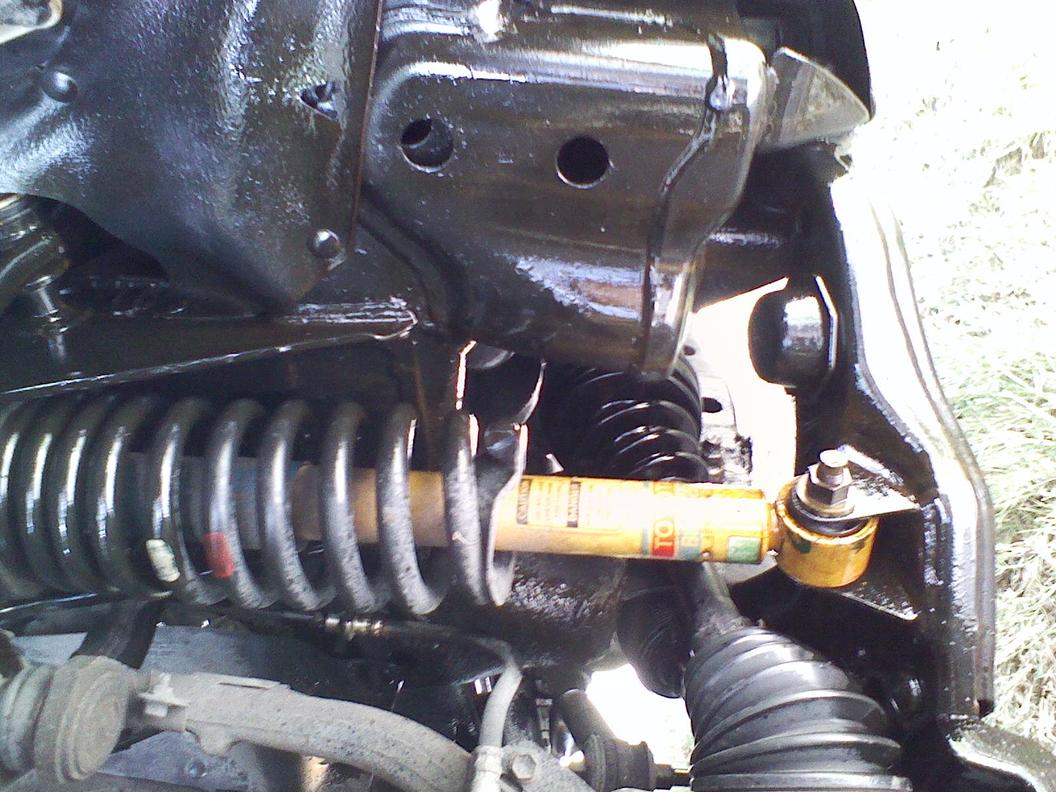

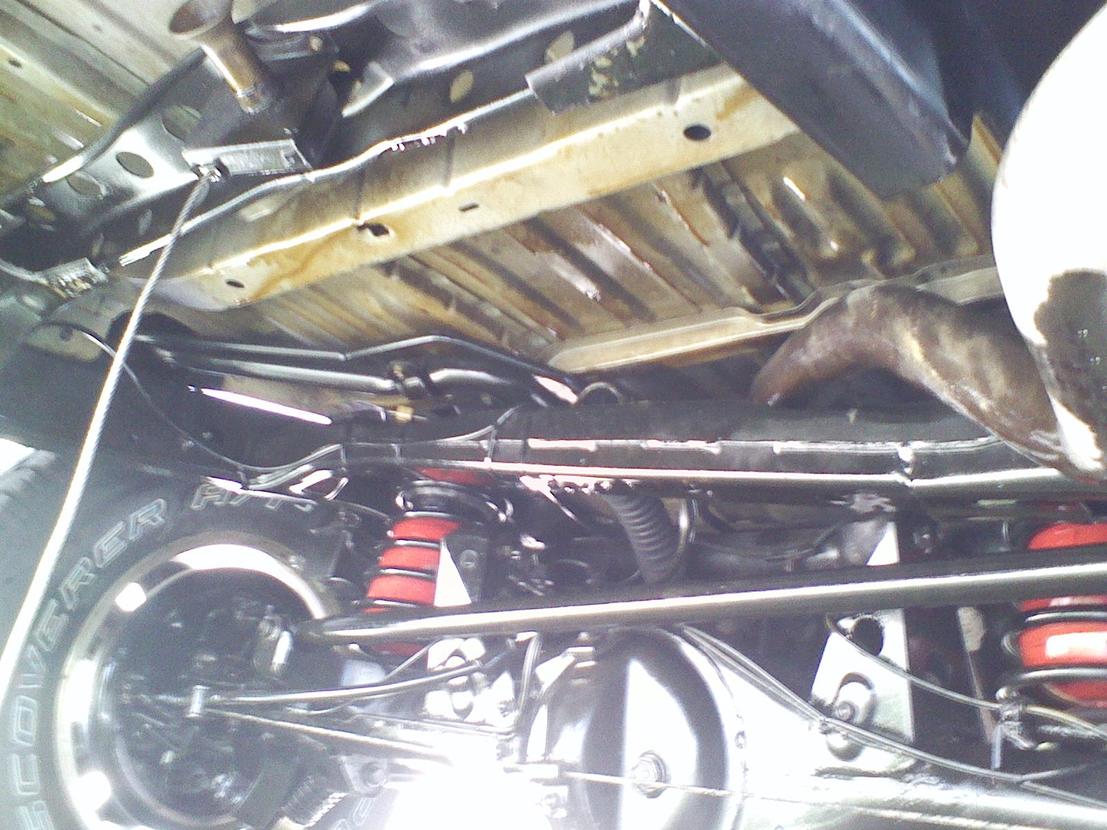

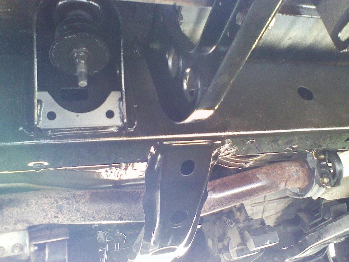

I had everything but no activation energy to get it done. Saw your post last night and ended up doing this today.

Inside the new (to me) frame, Eastwood Internal Frame Coating. On the outside of the frame, wire wheel first, then POR15 cleaner then metal prep then the POR15. Eastwood chassis black for topcoat(s). Some kind of bedliner on the underbody while the frame is out. Still thinking about the diff, which is solid but has a lot of rust. Maybe Eastwood Rust Encapsulator and then more chassis black.
