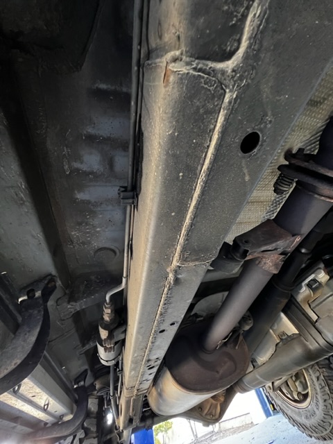

Have an '03 V8 AWD, bought used 4.5 yrs ago with 75K on it, now at 133K and frame is hurting from rust. Pass side under front door rusted through from inside ( see my garage for pics). I have raked about a pound at least of rust from inside the frame on that side with a coat hanger.

Just did some scraping, wire brushing and painting to the cross members yesterday, not a fun job! If it wasn't for this I think this 4R would last another 10-12 yrs, but I think the frame is going to take it out, but it's not near as bad as some pictures I've seen on here.

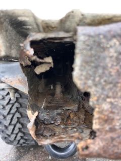

This is my first time posting. I wanted to ask if anyone has had the Control Arm Support rust off and break and if it is fixable? I have a picture attached. I am also trying to find out how to file a complaint for the current class action suit for the rusted frame issue.

Don't bother with the class action as it's a dead deal according to the letter I got within the last couple months. Pics would help as I'm not sure where your issue is but check out some of the bits you can get from the guys below. Also go over the rest of your frame looking for more issues especially the bottom metal parts at the bottom of the wheel arches plus front by tow points and rear behind bumper. Would hate to have you repair something only to find there's way more issues.

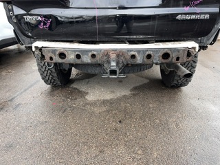

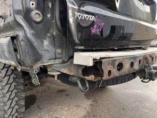

I’ve got the dreaded 4th gen rust…
The center parts of the frame are pretty good, but the front and rear spars were bad, but then discount tire ran my truck into a pole when they were rotating my tires….
Am I at the point this truck is dead? The ship it’s at says they can’t try and fix the frame.

How handy are you A.Vern? That's similar to what mine looked like. I cut out the old metal and welded in new but have been a novice welder for awhile. That's an easy area to weld.
Thanks Mike!
I have buddy who does a bunch of welding, but he was wondering what to weld onto. Has yours held up pretty well? I’m it’s in California now, so minimal rust exposure issues, but I’m afraid it’s too far gone?
That's good. You need to cut back to the good metal (an inch or two usually, make the metal shiny and then weld new steel on there. Really is pretty easy for the back frame as it's easy access. All the repair bits I've welded in look better than the rest of the frame.
I like to cut a section at a time so the patch I'm working is as close to original as possible. Or you could put something like this over the frame.

One more add-on, post 18 on this thread is pics of mine fixed. Looks like yours may be a bit worse but you can see how far back I cut.
