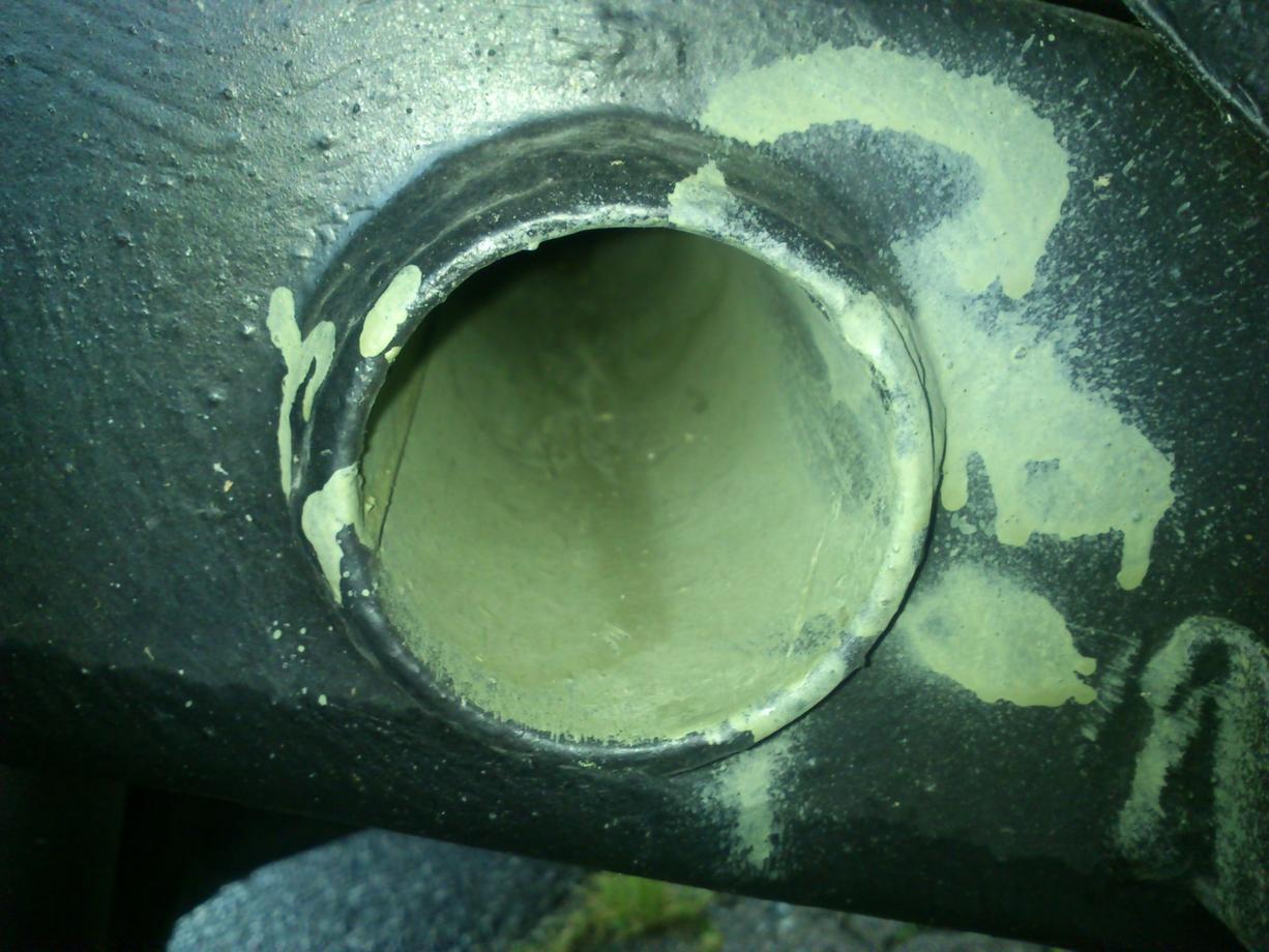

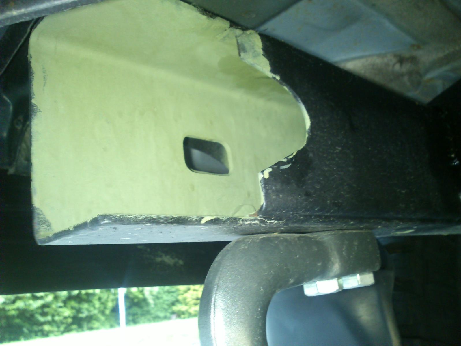

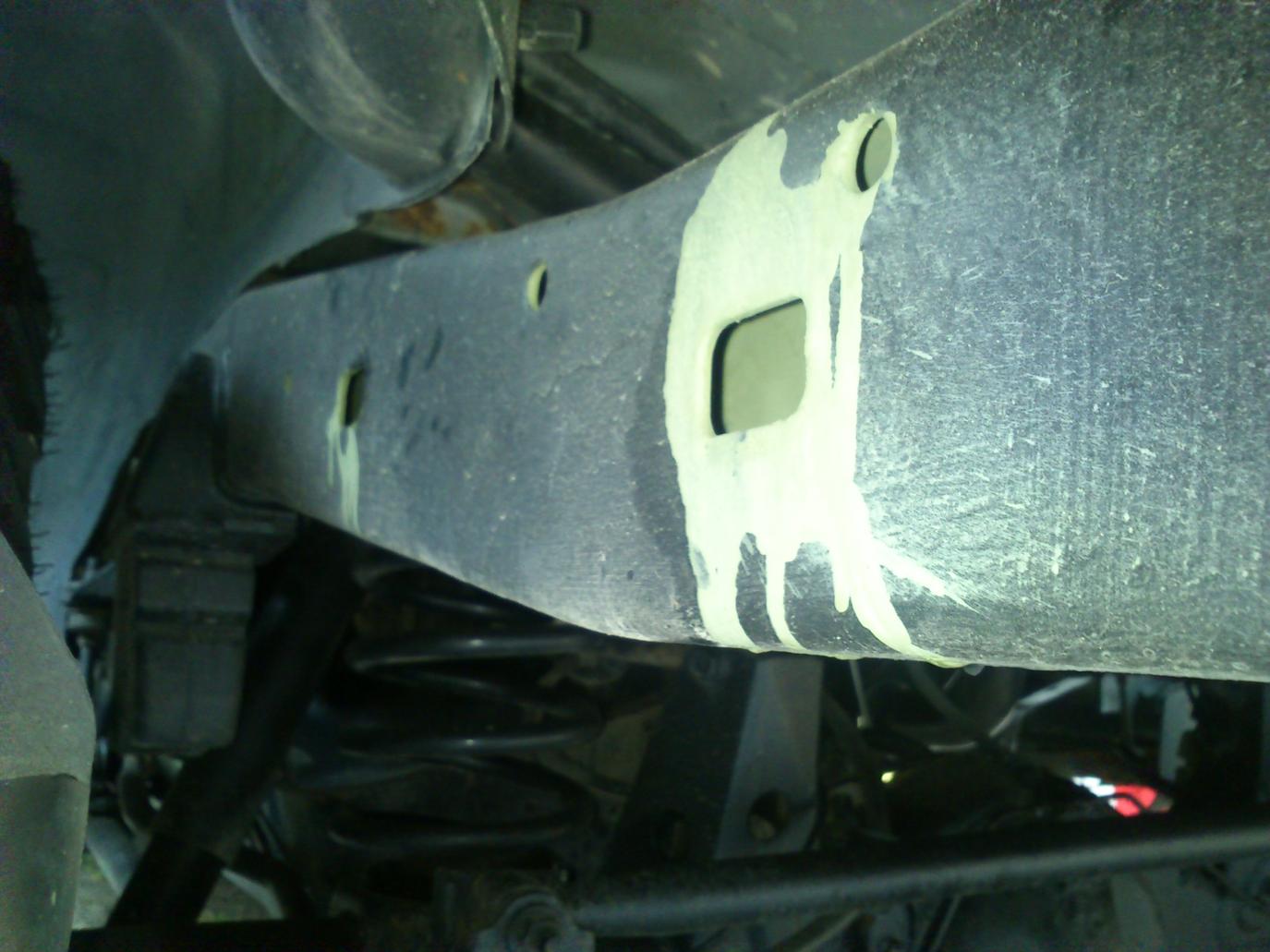

Hi guys, I just thought I would do a review/write up on a really cool frame rust preventer I just used on my 4runner's chassis.
First off
-My Runners frame was EXTREMELY rust free :) just some surface rust on the welds.
-Second the exterior surfaces of the chassis have been sanded, primed and painted with brush-on oil based tremclad. (to prevent further rust in the many years this truck will run for.)
So I thought I have just rust proofed the exterior of the chassis what about the interior? So I did some research and found this product.

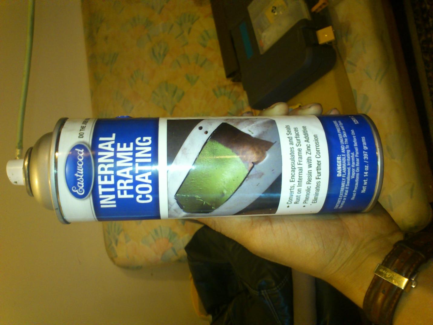

The product is called "EASTWOOD INTERNAL FRAME COATING"
It has
•Tough phenolic resin penetrates, converts and encapsulates the rust on the internal surface
•Zinc phosphate seals it to prevent future corrosion
•24"-long tube with conical nozzle reaches in to spray coating in a radial pattern for complete coverage
here is a link to their website.
Eastwood Internal Frame Coating
I used 3 cans in total to do the whole frames interior so 3x$17.99
They also have a really cool exterior frame coating but I had already tremcladed so I didn't order it.
OK. Enough with the blabber on with the pictures!
hope you enjoy!

I agree with the OP. This is a great product. Easy, even fun, to apply. My truck was up north in the rust belt for 15 years before I bought it. It did not have any frame rot but definitely had moderate surface rust on the frame. I used the Eastwood internal coating to get inside the frame and applied several coats of their rust converter to the outside of the frame. Obviously time will tell, but it seems to be holding up well. And the frame went from looking terrible to looking really good.
I used this product on my rust-free internal frame rails and applied POR to the exterior. I think I used three cans to do the entire frame-including the tubular cross pieces. I put it in thick.
Product was easy to use.
Per the website:
Aerosol covers 10 sq. ft., qt. covers 50 sq. ft.
Fully cures in 24 hours
But can you use this product on rust it's self ? If you have internal rust ?
The key is surface rust. If you have penetrations your best bet is to repair the damage, treat it with POR and then coat it with the Eastwood.
And remember, you will need to apply it periodically down the road as this is what rusts off in place of your frame.

You see that flat rusted bar looking poking out of my frame from the back ? What is that ? It DOES NOT seem to be part of the frame. Someone on here said it's for the hitch or something.
Think I can just go ahead and buy this product and cover the inside ? Even if it's little rust ?
the rusted flat bar your speaking of is just that, a flat bar that has nuts welded to it. those nuts are the nuts that have bolts running through them that hold your hitch on to the frame.
there would be no way to remove those nuts if you were to ever pull your hitch, so thats why they are welded to that flat stock.
