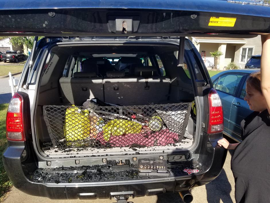

So, yesterday I go to open the trunk to take out some groceries when something crazy happens. The trunk support strut popped off the little ball joint, slammed the trunk shut and shot into the rear window causing it to literally explode.
I can only assume that excessive wear caused this to happen. I am just glad no one got hurt as my wife and 2 year old daughter were standing next to me. Just figured I would share this story and tell people to check those support strut ball joints to make sure they are not to worn out.

Wow... never heard of this happening before. Got these lifts on a lot of vehicles. I'll be checking mine for sure. Glad everyone is ok, but that really sucks.

I had drop it off to replace the glass this morning. That was simple enough but now I am going to replace that whole strut assembly for that side. I am definitely going to be very wary of that door moving forward. Definite design flaw.

There's a recall/warranty for the exploding rear windows. Should have taken it to the dealer and told them that the defroster made it blow out. Think it's good through 2018. Might still be able to go by the dealer with the invoice and get reimbursed.

If I recall correctly, the defroster replacement calls for inspection of the heater wire connections for confirmation.
Yeah I just rolled in with no back window and had already cleaned up all the broken glass mess and what not and just said I would like to take advantage of the recall at this point in time... they said wow when they seen no window and asked if everyone was ok ..I said yeah it was just me that doo doo'd on the seat when it happened ...they laughed and said sir go ahead inside and we will get this all taken care of for you..no inspection since I left nothing to inspect and no questions asked.
Went smooth as can be
Was the strut that failed an OEM part or a replacment? I bought Monroe replacements and was really disappointed with the quality. I installed them, but the ball joint seemed much looser than OEM. I stood back and shook the door hard and one popped off, so I returned and used OEM parts for the replacement.

Hmmm....the one on my passenger side has been making a racket for a while. I've tried cleaning it then applying some spray silicone. This only lasts a few days then it's back to making a terrible groan after the hatch is maybe half open up to the max height. Did you have any symptoms like this before the failure or was it just the slightly loose ball/socket joint?
My hatch goes up and stays up fine so I don't think either strut is "bad" but maybe one side is lifting more of the load than the other. I'm not sure how I can tell.....
Sounds like OEM is the way to go on these? I just replaced the hood struts on my Honda with some aftermarket ones and they seem fine. But my hood goes up maybe 2% as often as the back hatch. That's definitely where I probably shouldn't cut corners.
