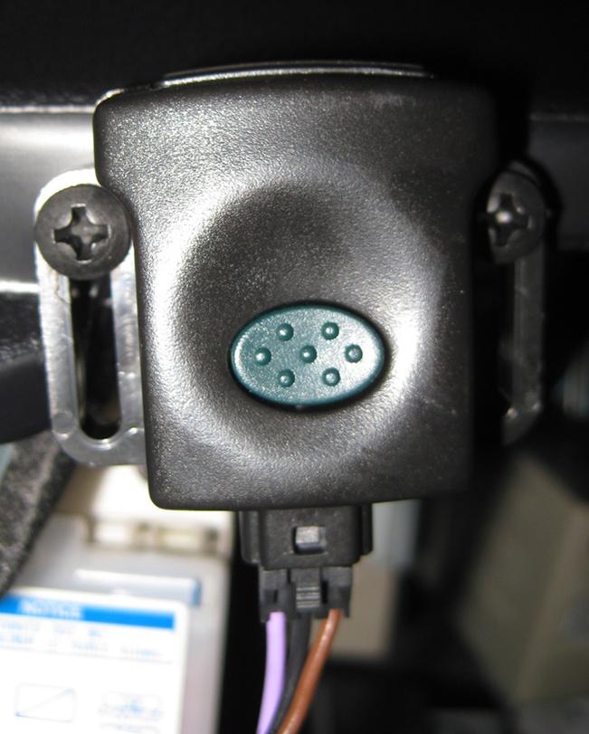

I finally got my 2018 TRD Off Road Premium and the Stealership tried really hard to get me to purchase a Rockliege Security System. I said "Heck No!"

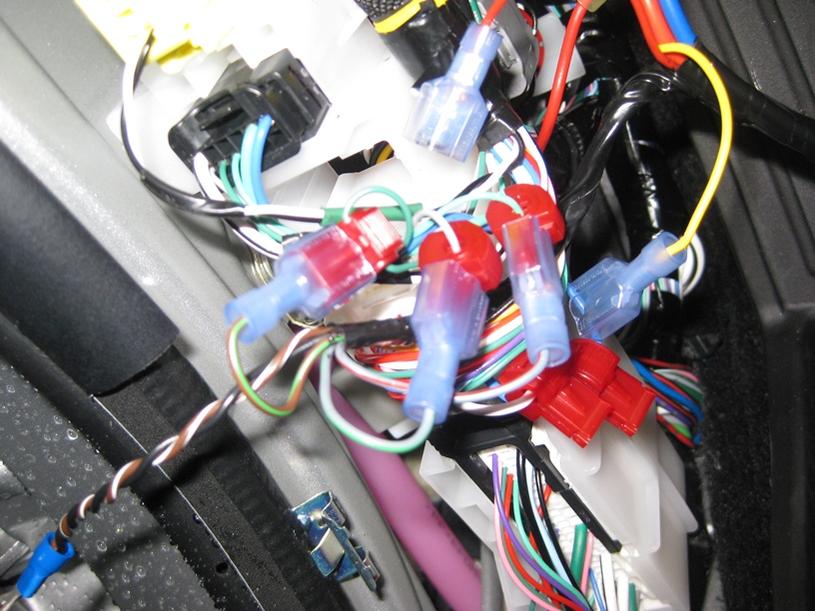

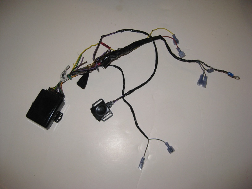

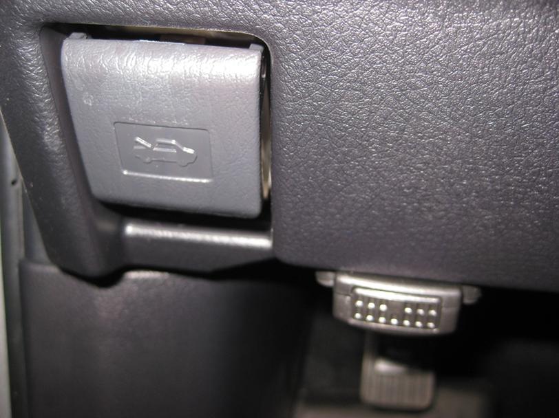

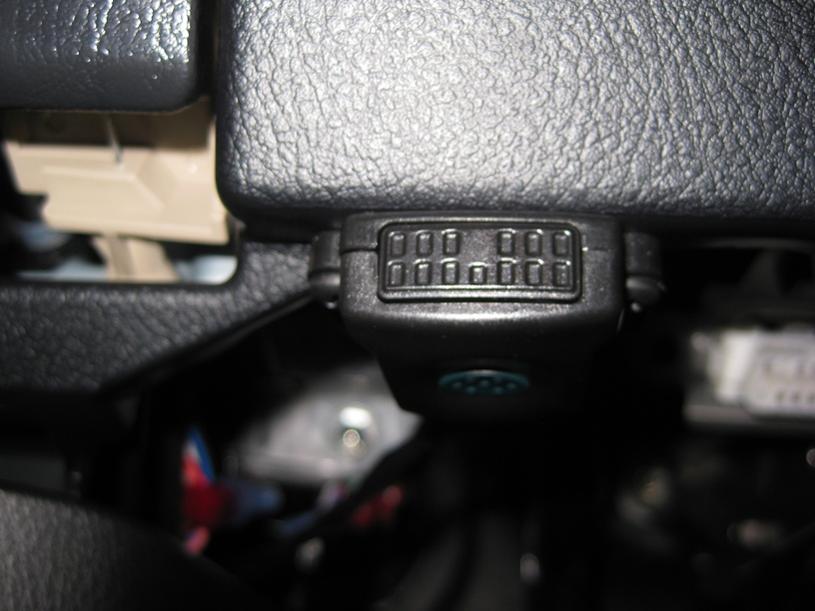

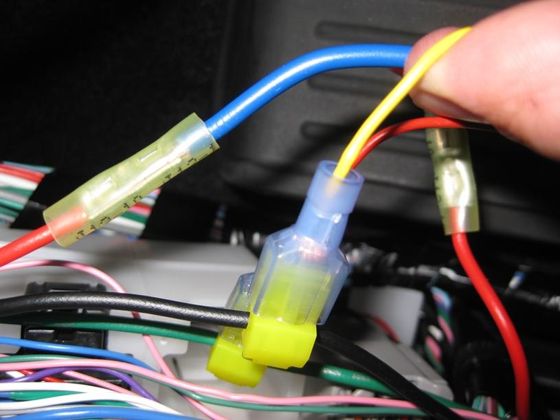

Turns out the Freakin' Dealer had already installed it! Look for a little push button assembly screwed into the dash with stupid self-tapping screws. Behind the left kick panel is a gawd-awful bas-tard bundle of wires with zip ties and electrical tape and little spade lug wire taps jammed into the factory harness. There will also be a little black plastic module with a 24 pin connector plugged in. I'm de-installing it all and slapping it on the desk of the new owner of the stealership the first chance I get.
The pictures below show the alarm's push button switch with the "de-activation" plug pushed into the front. The plug is that dimpled surface on the front. Pushbutton is green colored and on the bottom.

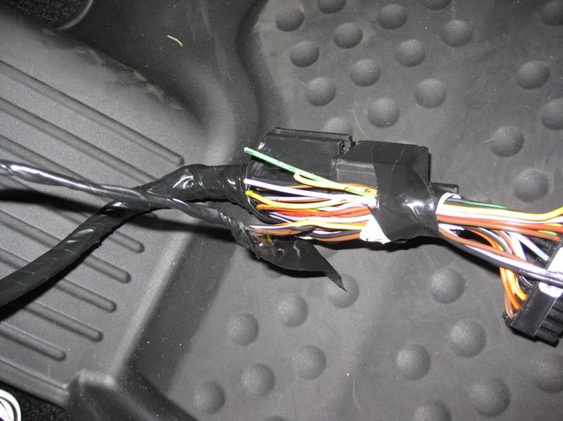

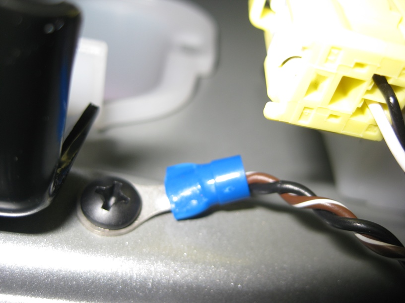

Anyhow, I de-installed the whole fugly mess including a ground screw, six crimp-on wire taps taps and a fugly wire harness layered in nasty sticky black electrical tape. For tonight I had to leave the power interrupt relay in place because the morons butchered a main ignition power wire and I need to cut their splices out, recrimp the ends together and cover it in heatshrink tubing.
It is raining outside so I cannot finish tonight. At least the truck starts and runs without any risk of the alarm ever mistakenly activating the relay and killing the engine dead.
If you wind up doing this on your own as you suggested, solder the ignition power wire, not crimp. Worth the extra time and effort for peace of mind!

Actually not impossible but not super easy either; some effort is needed to undo the mess and not cause more damage. Remove the kick panel, undo two dash screws for the push button, unplug 6 to 7 wire T-taps, undo one ground screw, cut a bunch of ty-wraps and a mile of black electrical tape, one cutout relay and you have to re-splice the power wire that the relay was cut into.
