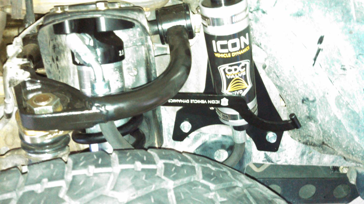

The Fronts are done. The rears are going on tonight

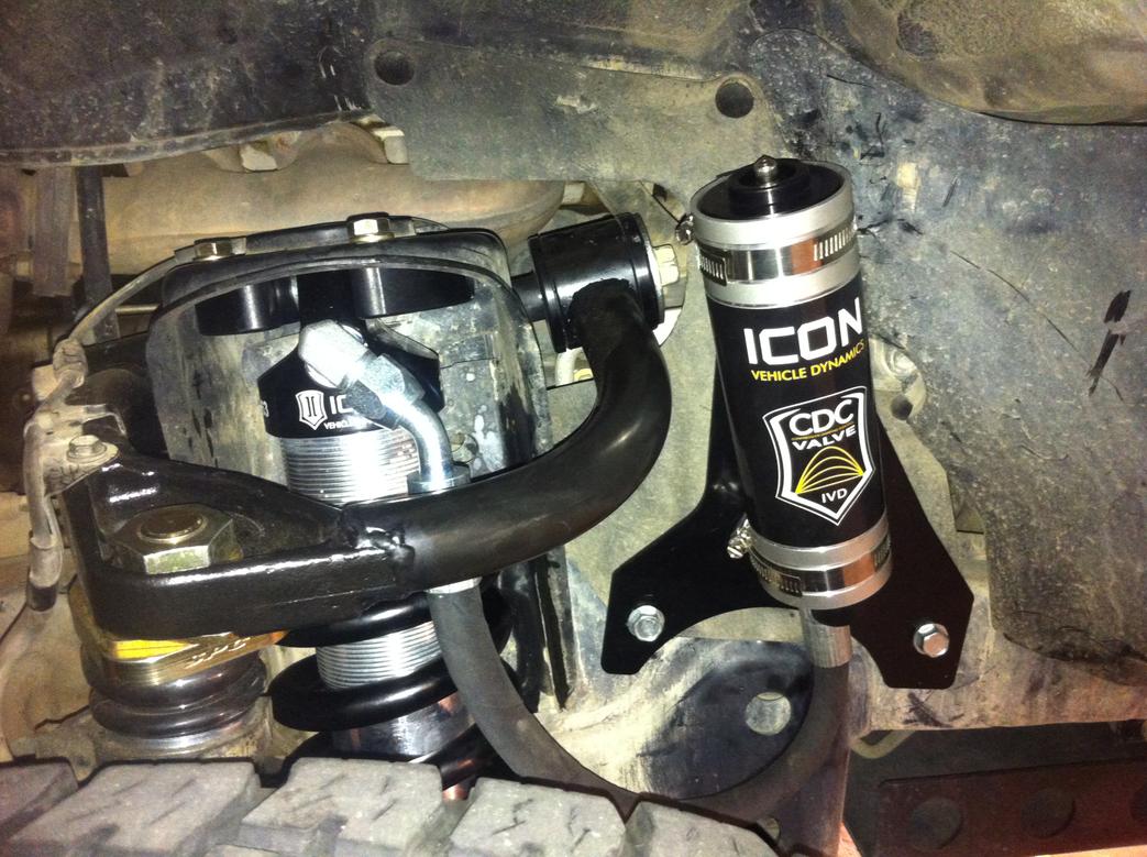

Nice! Looks like a sweet set up! They don't appear to be adjustable when on the vehicle... Is that correct? Looks like the UCA, as well as the reservoir hose would be in the way. Damn cool none the less.
We will have to wait and see. I get it back Friday. These pics are from ICON. I believe you should be able to adjust it from the other side though. The CDC will allow for dampening adjustment for sure :D

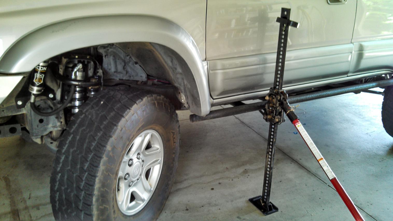

Well they are truly amazing. I am still getting the front ride height dialed in and I need to go get her aligned but it just floats over the bumps. I took her out on a rutted out dirt road about a mile from my house and flew over it at 40 mph like it was nothing. Then I dialed it up to five for the street and it is just perfect. Here are a few cell phone pics but more to come.
As far as adjusting them you do need to use the hilift but the spanner wrench went in just fine. You have to do quarter turns and go back forth from one side of the coilover to the other to avoid the reservoir hose. It took a little longer but it was really no big deal.
Dave

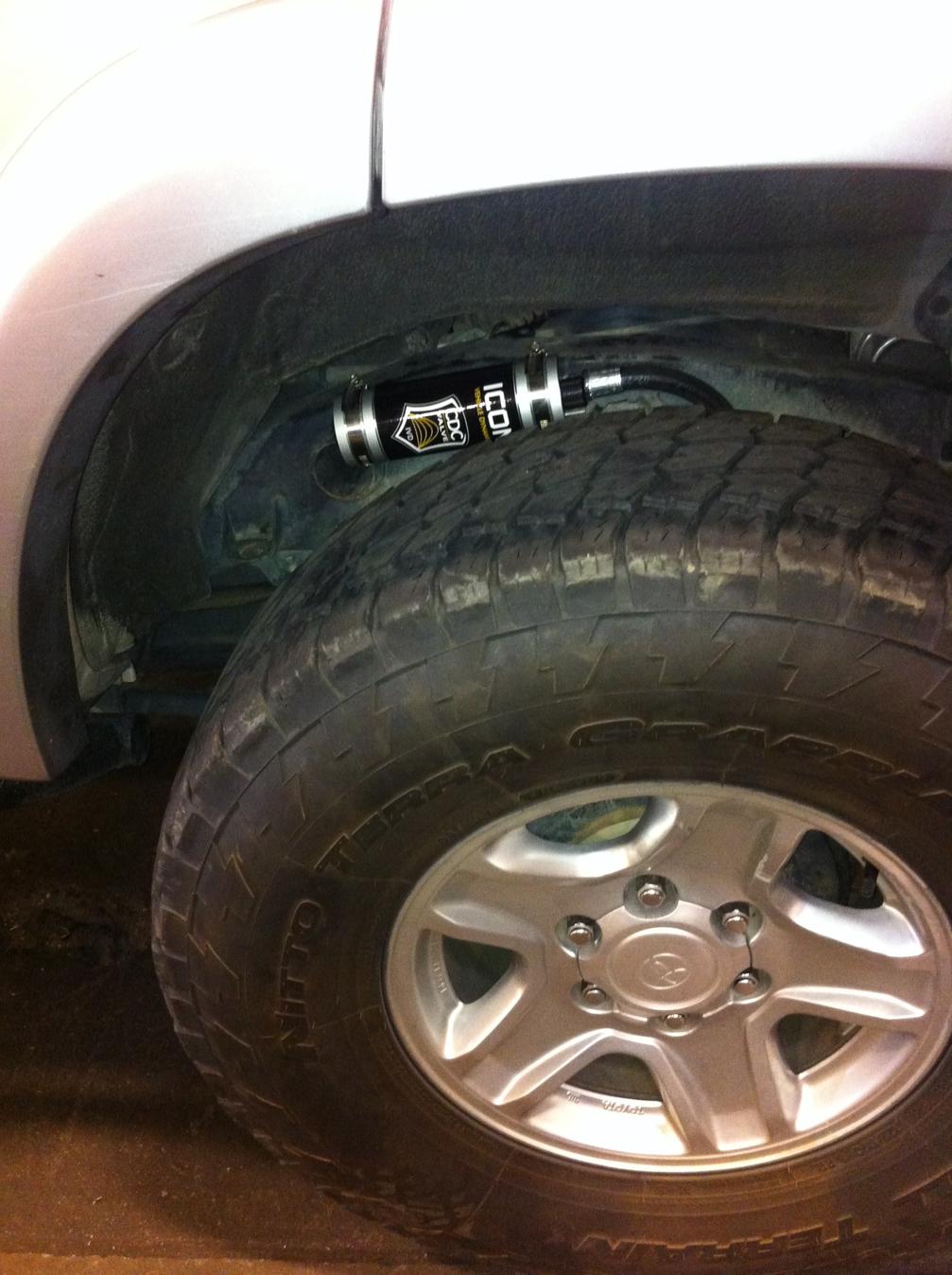

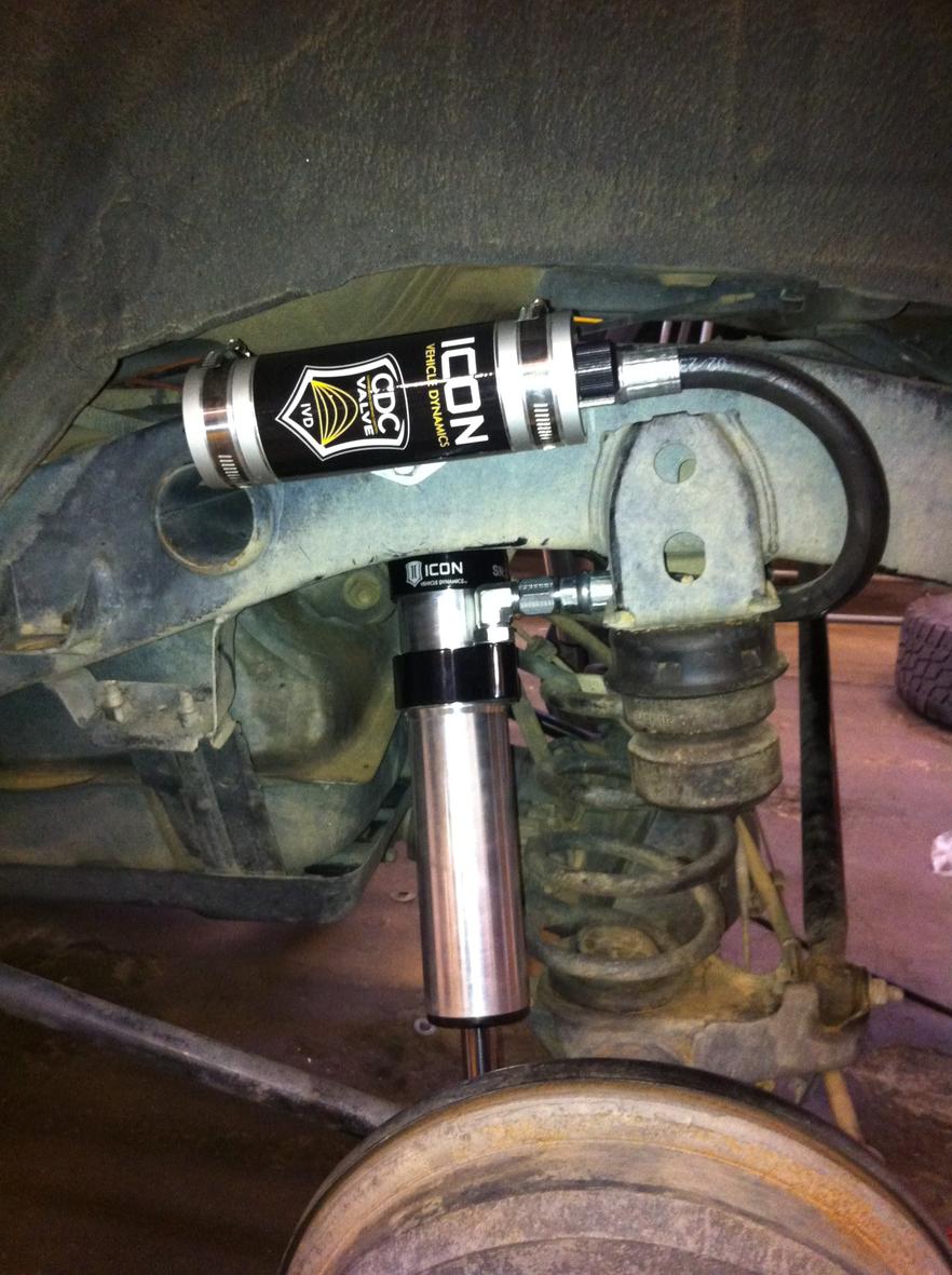

Here is a pic of the rears that shows the remote reservoir placement. I haven't had a chance to stuff the tire but will get to that after I get the front dialed in.
Dave
Looks like they had to change the shape of the top-hat to make room for the bypass hose. Congrats dude, it better ride nice for all that coin.
