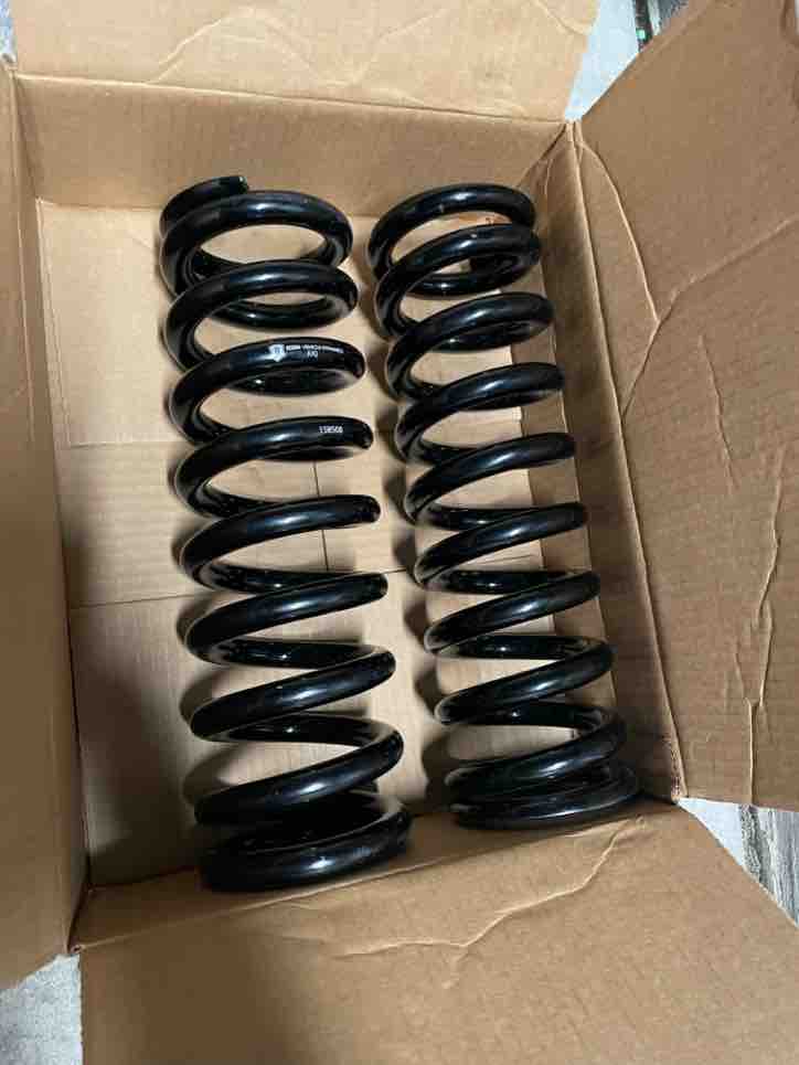

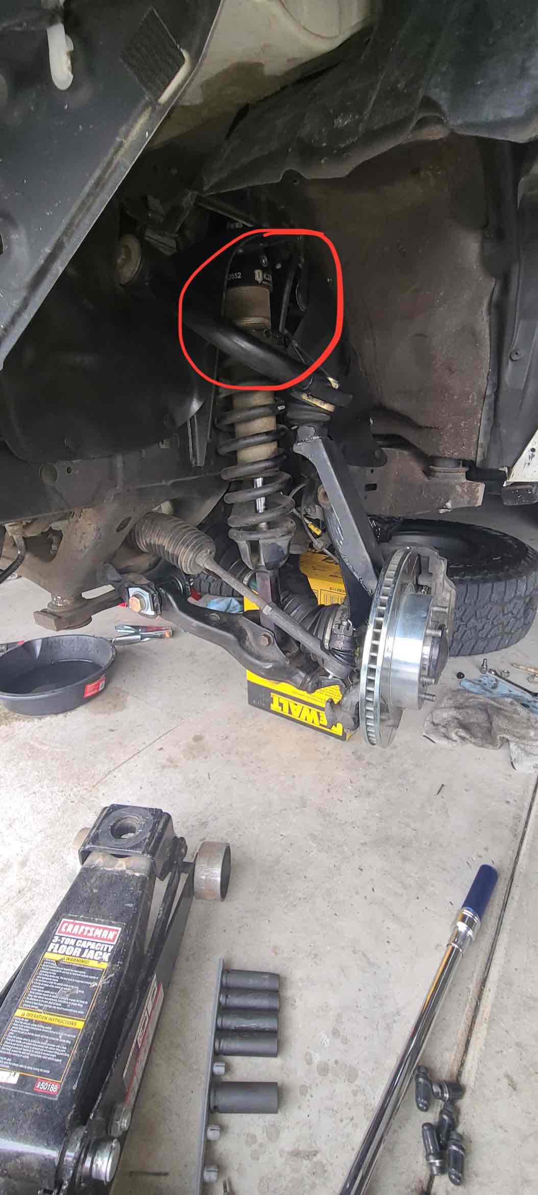

More parts for coil rebuild, just need rebuild kits and oil now. Oh also the will to do it lol. IMG_2511.jpg

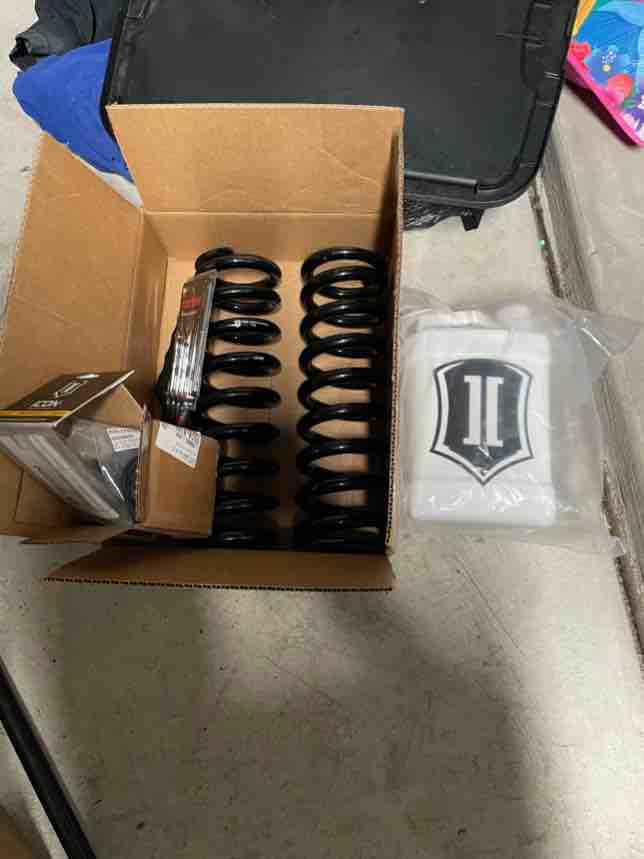

Got the last of my Icon rebuild parts yesterday. Seal kits, com10 bearings, retaining clips for said bearings, smaller spacers to convert to “extended travel”, oil and springs. I ordered a pick set and a spanner wrench as I’ve read they make the job easier. Break down of what the parts cost me for a DIY job not including the nitrogen, which I have no idea what it’ll run as of yet.
Seal kits (2) and com10 bearing retaining clips(4 pairs) from Shockseals.com $66.67
Com10T-F1 bearings (4, 2 for each shock) from offroadwarehouse.com $36.15
1 gallon Icon shock oil and nitrogen fill needle tool from offroadwarehouse.com $89.14
I believe this is everything needed for a basic rebuild unless you need shafts or a new top hat or anything like that. I tried ordering a 1/2 gal oil from ORW which they showed in stock. I then got an email saying sorry, they don’t have it only a full gallon. I paid the difference and bought the nitrogen fill needle tool as well.
I also bought the following items:
Icon 3.14.700 springs. I have a lot of preload on 03.13.650. Got them off a guy on TW, they are brand new $180
Icon 7/8 .600 shaft spacer for extended travel conversion, $30
Pick set for removing seals on amazon $10
Spanner wrench to remove bottom of shock body amazon again, $12
Total $423.96.
Icon gave a quote of $482.94 plus shipping. By spending a bit of time shopping around online I saved $60. I had contacted a shop in town asking about the rebuilds. They said if I provided all parts (so everything I bought for $424) the labor would be $125 per shock and an additional $20 shop fee (nitrogen in guessing) for an additional $270. No thanks i think I can spare a weekend and save $250 lol. I’ll have the same shop do the nitrogen in the end though.
I have a buddy who has a nice stand spring compressor off amazon, there’s no way I’d bet on the crappy HF one I have for those heavy springs. As soon as I can grab that from him, I’ll dive in. Probably next weekend, I’ll report back on how easy or difficult I found this job to be. Wish me luck. IMG_2572.jpg

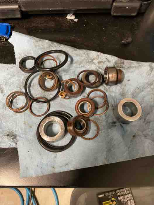

I finally got started on my shock rebuild, getting the spirolocks and bearings out is a real *****.
Ok, I’m the morning and with a fresh mindset it wasn’t that hard after all lol. One down, one to go. Should button it up tomorrow before work and then get the nitrogen done. Hopefully reinstalled by Thursday.
I’d say on a difficulty level, it’s really not bad. Just takes some patience and the right tools. I used this thread and a lot of the tips were spot on for some things.
All done and charged with nitrogen. Just waiting on a set of misalignment spacers for the top hat for one coil over that I fudged because it wouldn’t come off. Overall not a bad job at all. Next time it’ll be even easier. And by next time I mean next week that I have to rebuild my rear resi shocks fml.

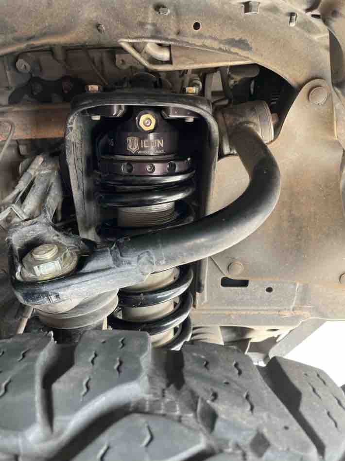

The ride is night and day. I converted to extended travel during the rebuild and swapped in 14” 700lb springs. Before I was blowing through the travel on pot holes because I had tons of preload. Less body roll too with the stiffer springs since I have no sway bar. Definitely a good upgrade.
Look at the difference in preload from before to now with the stiffer springs. IMG_2680.jpg

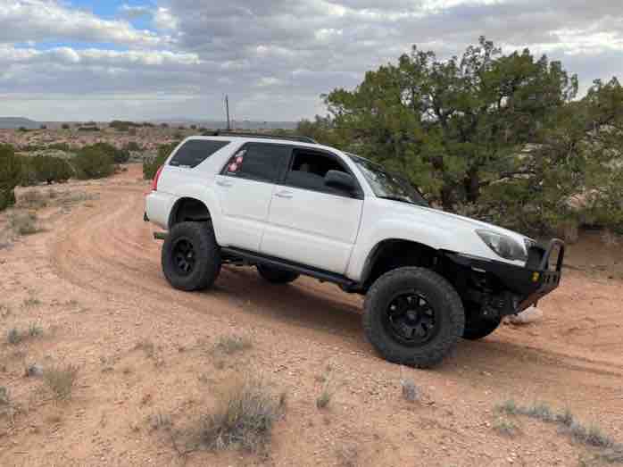

Took her off the beaten path. Rides so much better off-road with the stiffer springs. I was constantly blowing through the travel with the preload I had before. IMG_2767.jpg

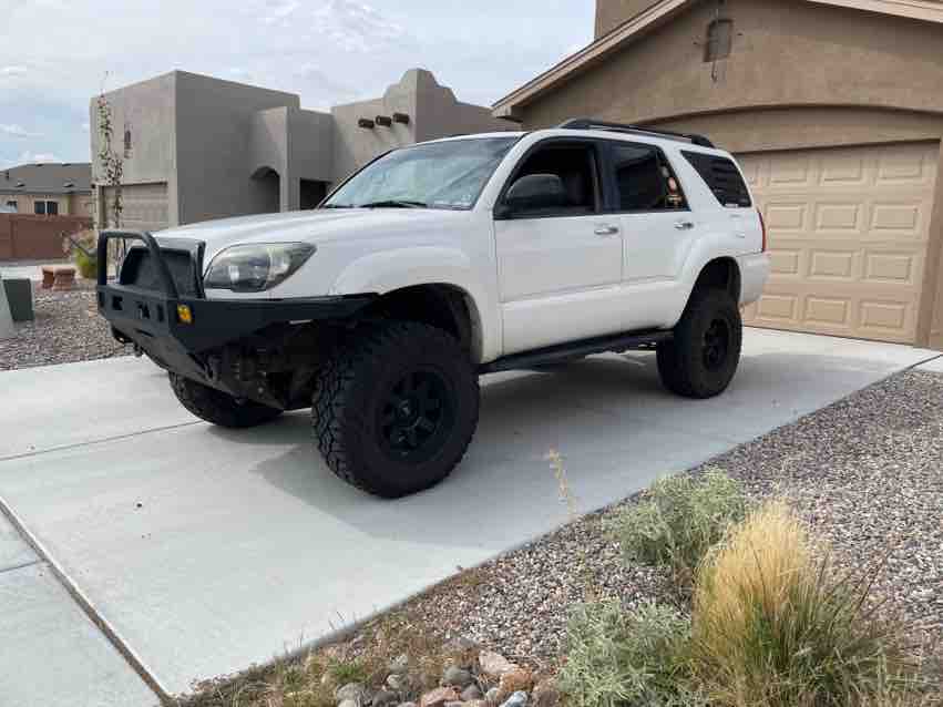

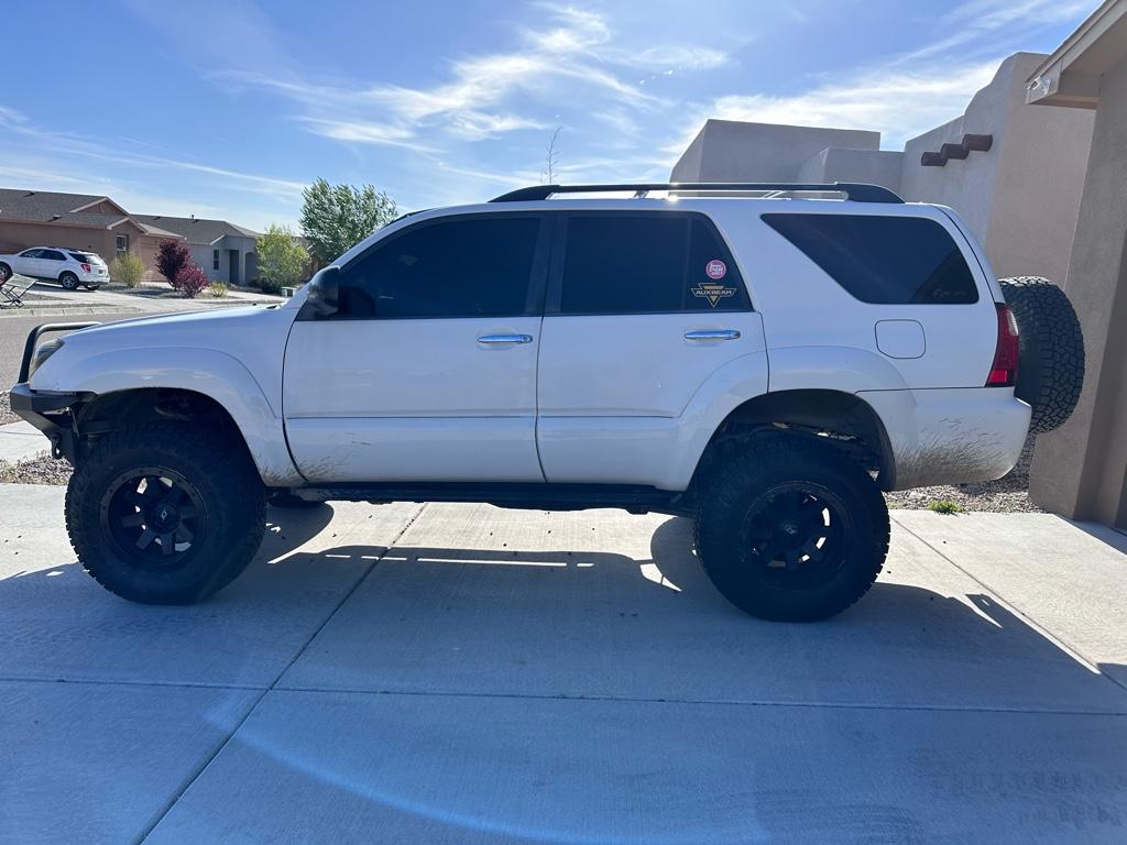

Put new tires on the ol girl. Went with 255/80r17 Toyo ATIII. Looks better than I hoped and drives much better. Feels lighter and gets up to speed easier.
