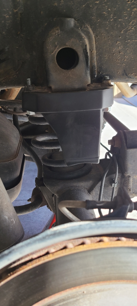

Finally got around to installing my DuroBumps. Pretty straight forward. Tackled during a tire rotation.

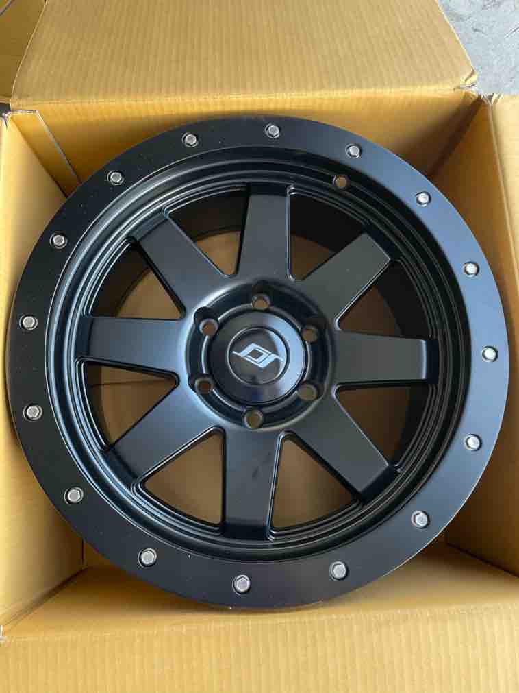

I ran into a guy in a third gen taco at the grocery store with SCS SR8 in jet black the other day (the wheels I’ve always wanted). I jokingly told him I’d swap him my Ray 10’s.
While I do love the design of the Ray’s, the gunmetal never quite convinced me on my white car. I’ve also wanted to get narrower wheels, because I’ve had the bug to try skinny tires.
He said yes and we swapped numbers, I didn’t think he seemed that interested. Well we made it happen today and I’m super pumped! He had all five so we traded straight across. Only downside is I need to disable my TPMS because the light is on now for some reason. They swapped the sensors but they’re 13 years old and I’m not replacing them.

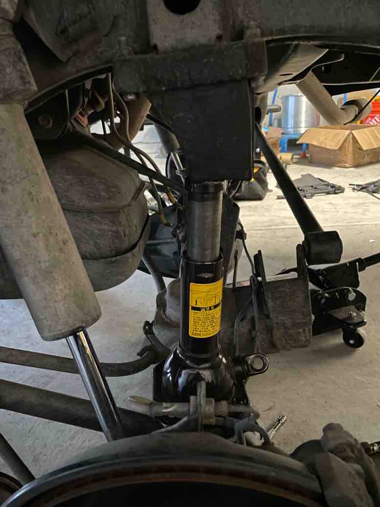

My driver side Icon coil over decided it didn’t need all of its oil sometime between my last tire rotation and today. Guess I’ll be learning how to rebuild shocks!
Been looking at tutorials and there’s nothing technical about it as long as you stay organized. Figured I’ll give it a whirl.

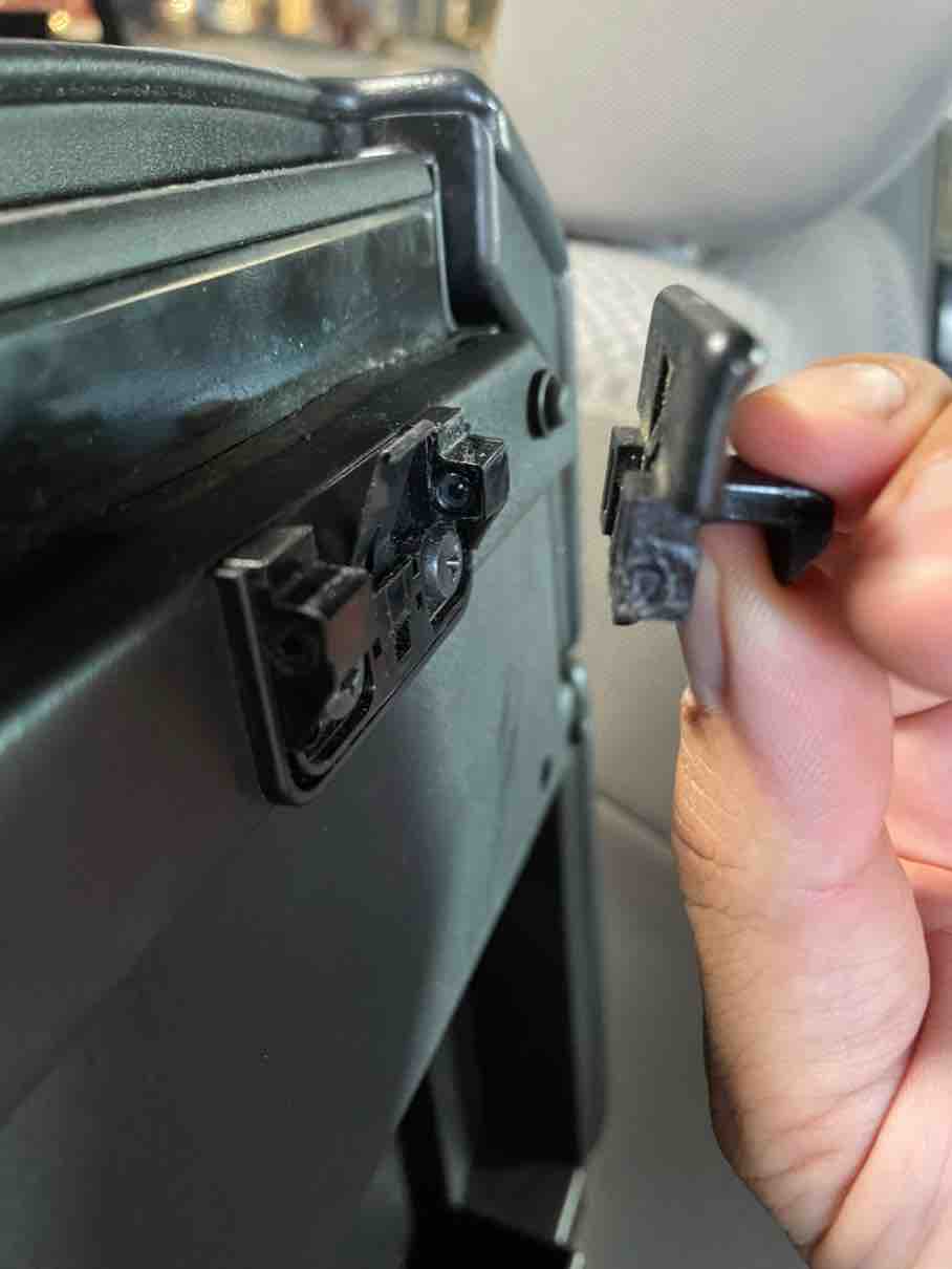

My center console door latch broke the other day. Found it cheapest on eBay, about $17. Came in two days!
Finally gonna get around to ordering the stuff to rebuild my coilovers, but really not looking forward to it. Oh well, it’s a few days in the garage, or twice the price to be lazy and send them off. IMG_2223.jpg
Finally gonna get around to ordering the stuff to rebuild my coilovers, but really not looking forward to it. Oh well, it’s a few days in the garage, or twice the price to be lazy and send them off. View attachment 383827

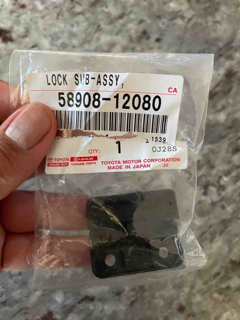

Did the console latch fit/work on your 2008, I ask because I search that part number (58908-12080) and it comes up as the center console latch for a 5th Gen?
The part number for all 4th Gens that I came up with is 58908-32050 and it $8.63 at McGeorge Toyota.

Yes it worked perfect, that’s what I get for not looking into it more. Dang lol.
Parts started showing up for my Icon coil over rebuild. Totally not looking forward to it lol. IMG_2293.jpg

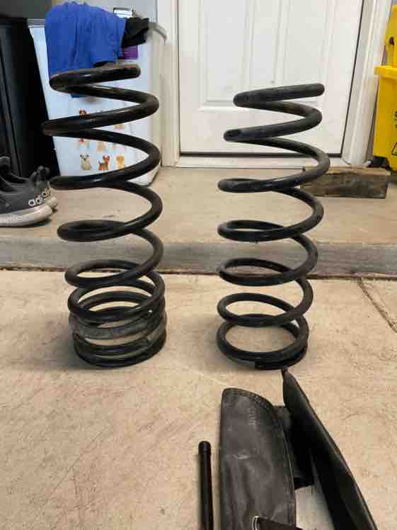

Swapped in Icon overland 3” rear coils. Nothings wrong with the 2” I’ve been running but wanted a bit of rake and a longer spring. Ever since adding the rear tire carrier and spare I’ve noticed it’s a bit harsher over bumps. The initial test drive seems to show this fixed it. IMG_2351.jpg
Old on right, new on left.
So tall I had to use the bottle jack between the axle/bump stop and a spring compressor to get them in!

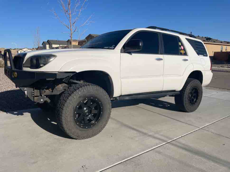

I’d been wanting to go to a heavier load tire than the SL wildpeaks I’ve been running for two years. I came across some D load Duratracs in 285/70R17 for cheap locally. Only 4 though so I had to buy a new one to complete my set of 5. The one new one almost cost as much as the other 4!!
Anyway, here she is on the new shoes and the taller springs. This is still with the old tires loaded in back. I like the rake much more than the level look. IMG_2357.jpg
Rake definitely looks good dude! :cheers:
Gonna ditch my p-rated wildpeaks here soon hopefully!
