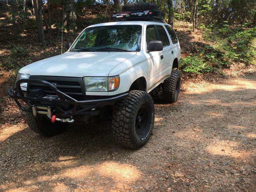

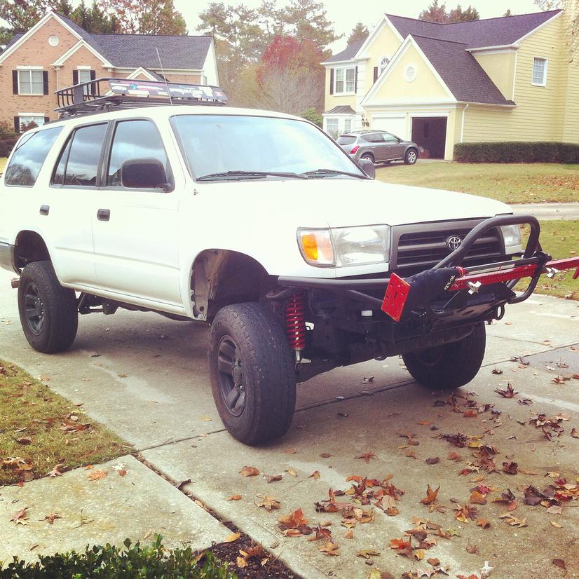

Here we go, very long overdue on a build thread and any activity of sorts.

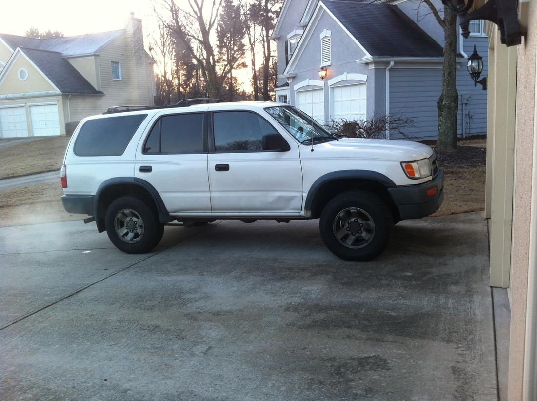

My father's 1996 4runner Base 2.7L 2WD which I bought for $500 and now it is well on its way.
As of 10/14/2016: IMG_5201.JPG

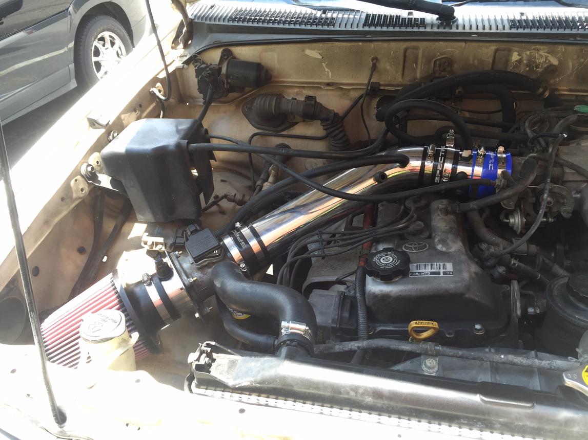

Custom Cold Air Intake

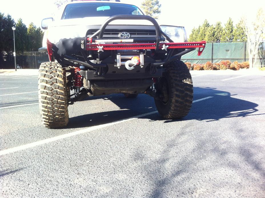

The picture below was the only damage ever done to the car, careless people in parking lots result in things like this!

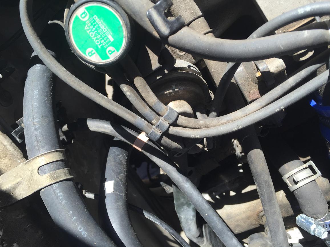

Just as I thought today would be perfect...
Threw a CEL code for the EGR, either a stuck open EGR or a bad VAC line I've checked all the lines and nothing there so we'll sea foam it to see if this can get it unstuck.

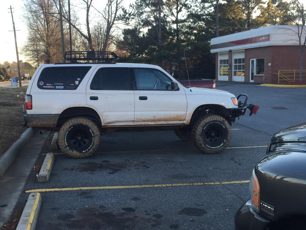

Took some time to go back home and catch a quick trip to the trail and meet some friends back home for the week.
The only last bit of sunlight before s*** hit the fan in Georgia.
I NEED MORE TIME TO WRENCH!!!! :crybaby:
Just a bit of mud to clean off afterwards. :bathbaby:

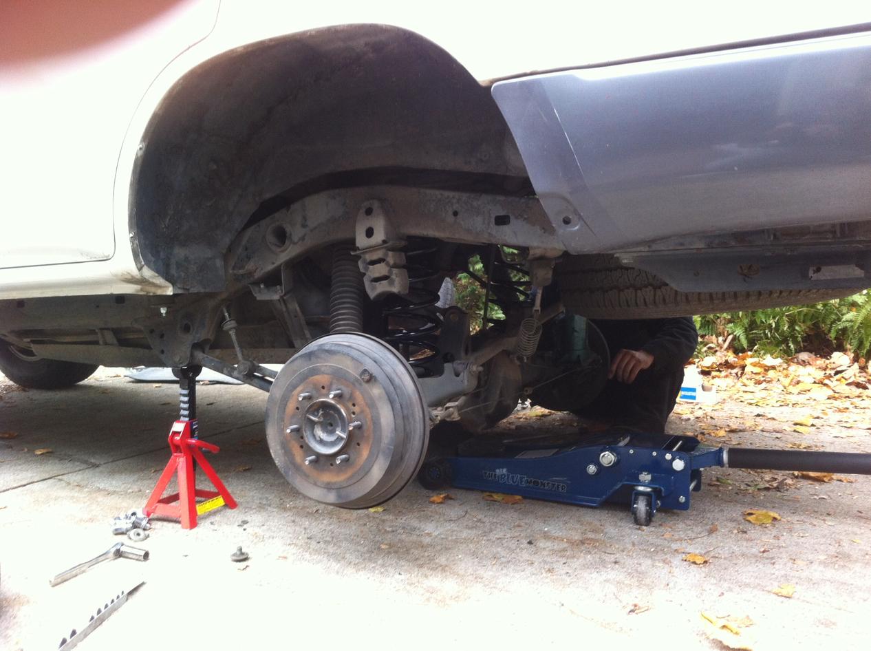

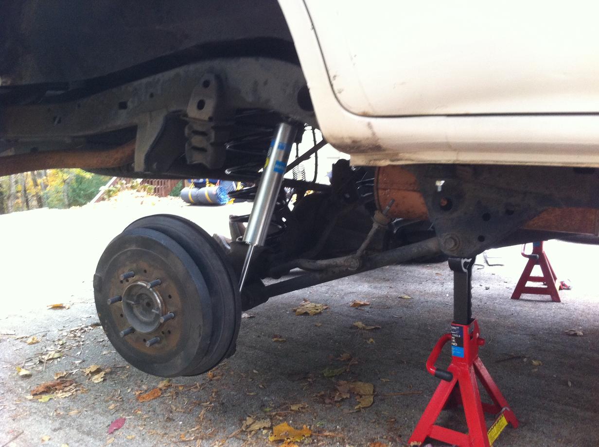

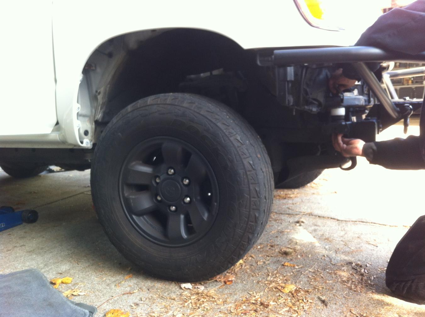

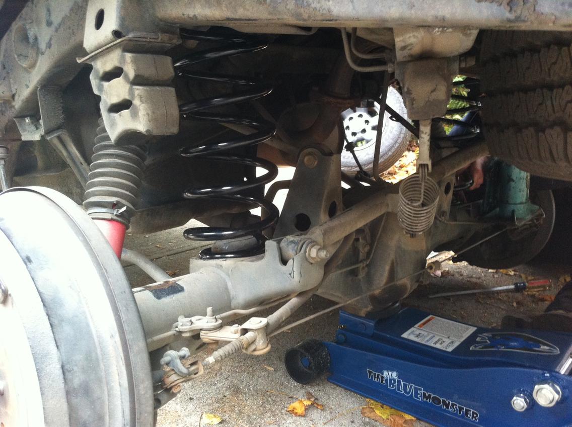

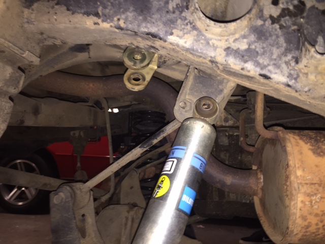

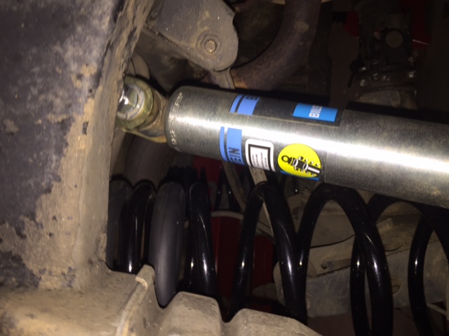

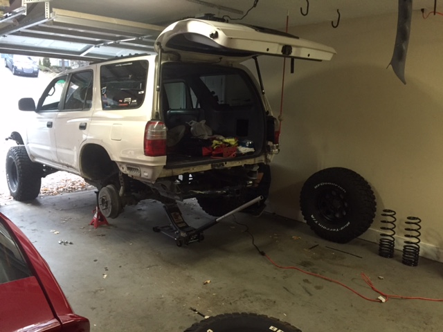

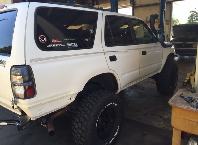

Finally back at it after Thanksgiving, got to install the superflex springs and no more "saggy diaper" .
A friend lent me a space and tools for $30 and it was well worth it.
Getting the OME 890's out was no problem at all, the real problem was having space to get the BEEFY superflex coils in.
The best we could do to get the axle to drop enough was remove the shock eyelet mount from the top instead of the lower eyelet.
100x easier :thumb3:

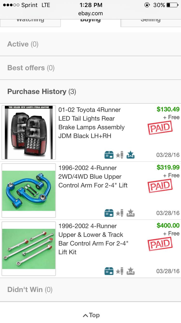

Guinea Pig

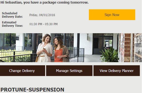

Some many months have passed and I caught the mod fever once again, some exciting new things about to happen! IMG_3180.jpg
Apparently they ship EXTREMELY quickly.
Capture 3.JPG :hungry:
Amazon gift cards come to good use as well. :thumb:
Going to put these parts through their paces!

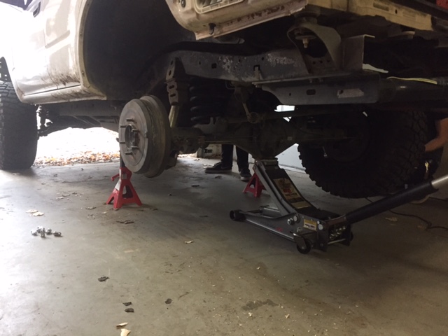

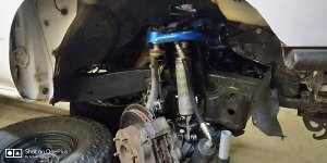

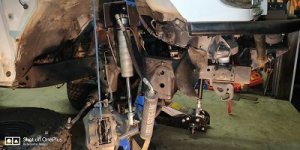

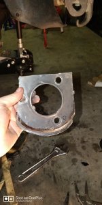

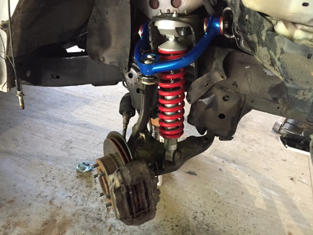

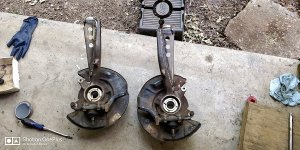

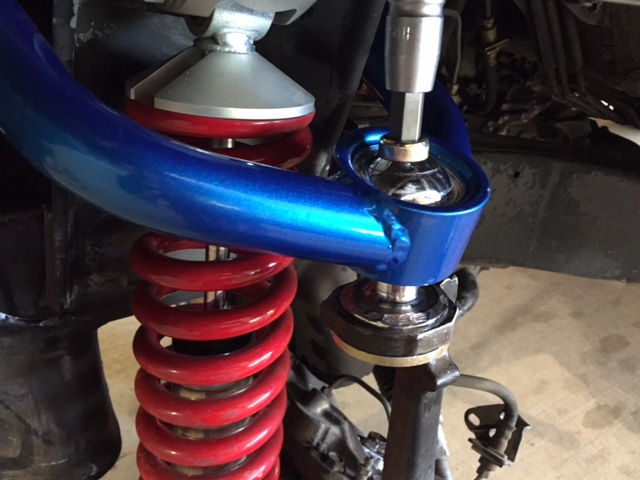

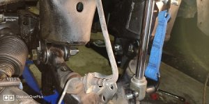

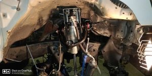

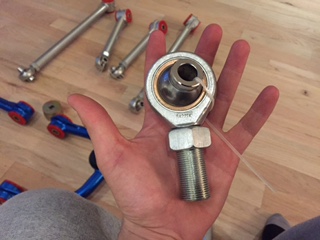

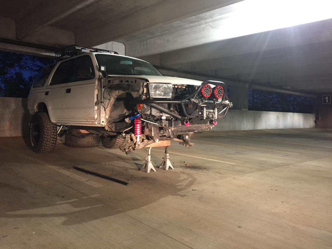

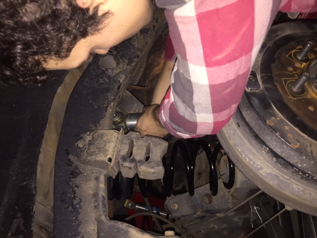

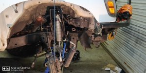

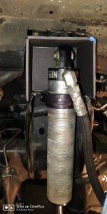

Okay, got this started yesterday morning been about 30 hours of work and no sleep. 4Runner is on stands in the university parking deck and I'm on my way to get my slug adapters pressed into the spindles instead of me trying because I was damn close to damaging one with a ball joint press. Here's where we are now, we still have the rear arms to get swapped!image.jpg
we took the spindle off and going to get the slug adapter pressed in now. This is not for the faint of heart

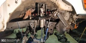

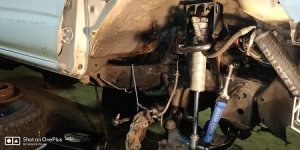

Front end update
After securing everything, torque to spec and voila! Time to test.
All sitting on its own
This took a weekend due to sorting out some fitment issues as expected, everything was a bit *too* snug thus, my job was not made easy. So far, over 6 months and nothing but AWESOME.

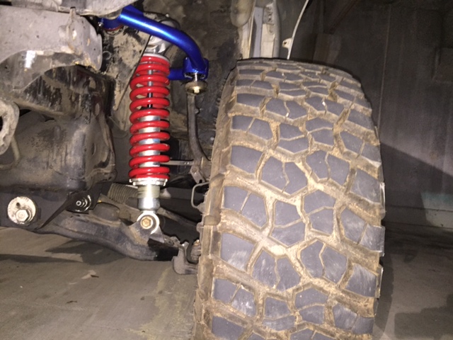

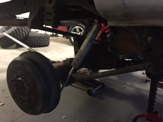

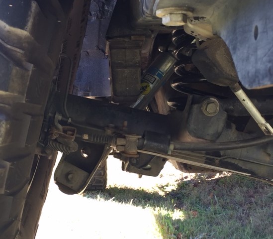

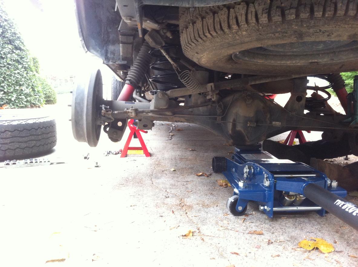

As well as the front UCA's to get the most out of the coilovers, the rear end needed some attention after 280,XXX:IMG_3217.JPG
Taken some time to utilize free space provided by a friend of my fathers:
Test time (in the appalachian mountains back at school):
Near full bump and....
