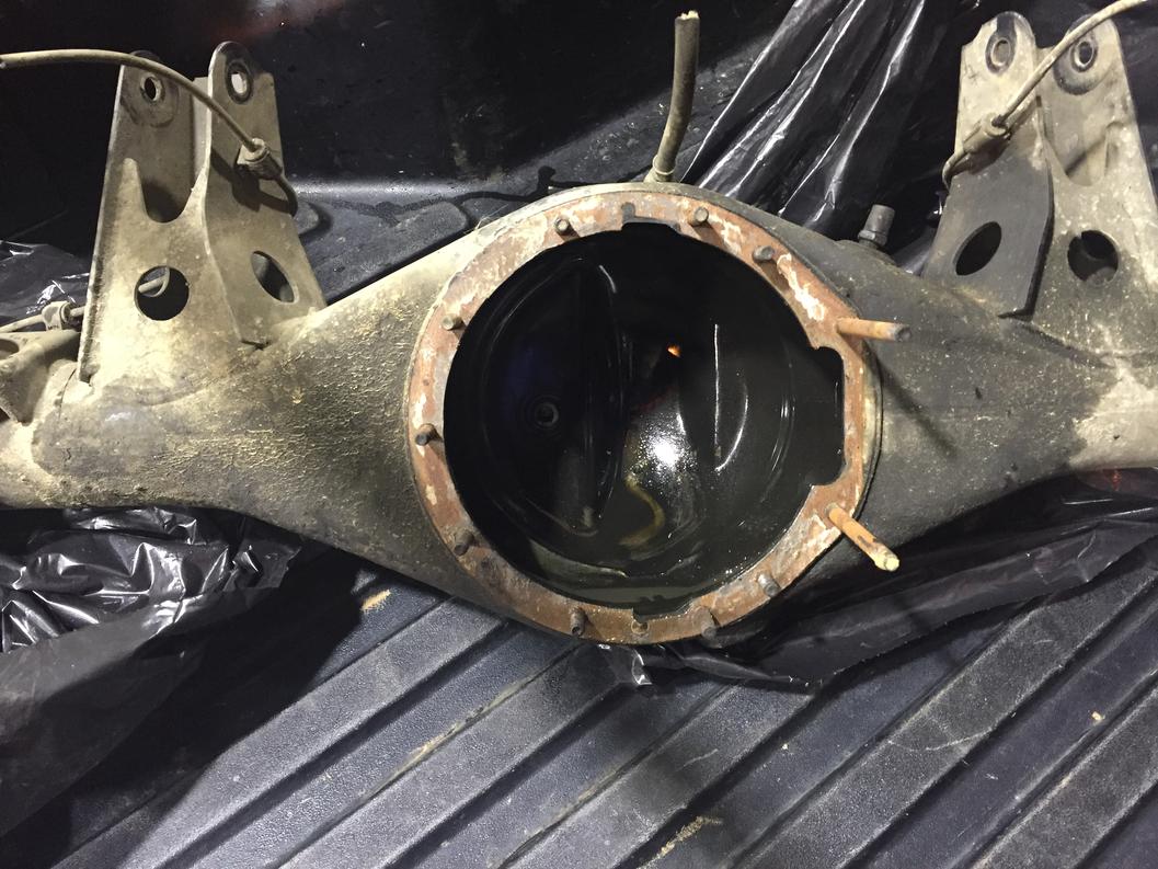

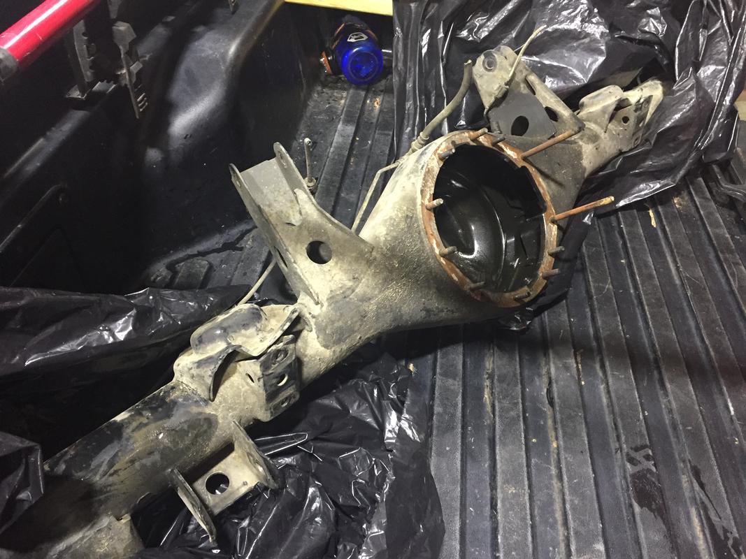

Southern Appalachia is a Toyota goldmine. A good friend was keeping his eye out for a brother and he helped me score a $100 e-locker axle housing and I finally received confirmation that my front E-locker will soon make its way to the US of A all the way from Aussieland. Here is a picture of the last peice I needed for my e locker conversion! Harness is ready to go and the 4.56 OEM E-locker will be installed once College let's out! View attachment 250101 View attachment 250102

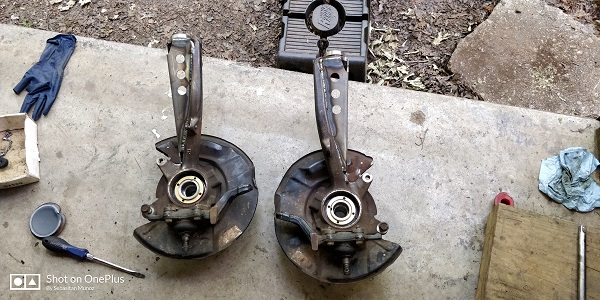

- Need to rebuild steering knuckles and manual hubs

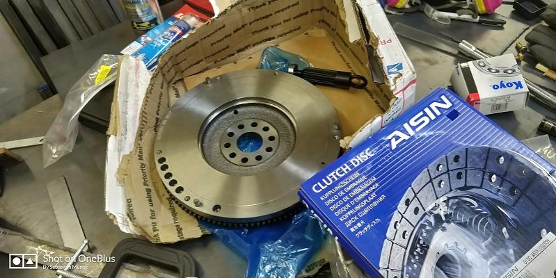

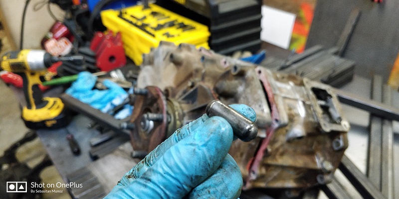

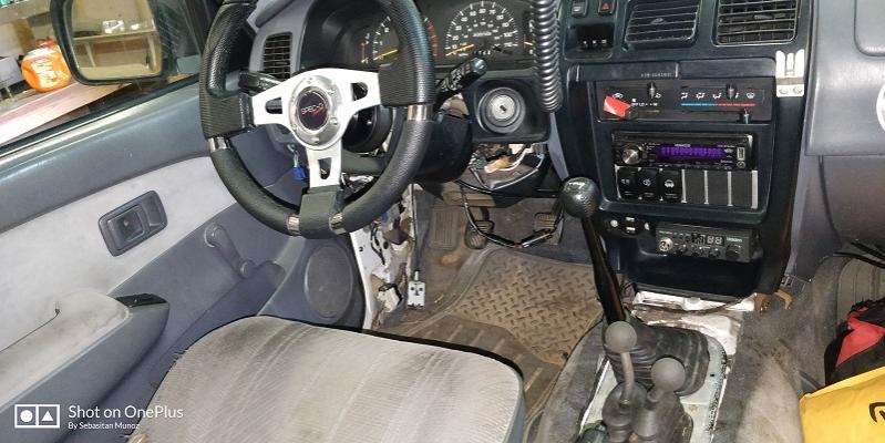

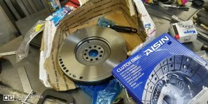

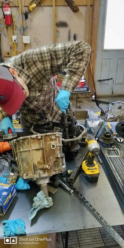

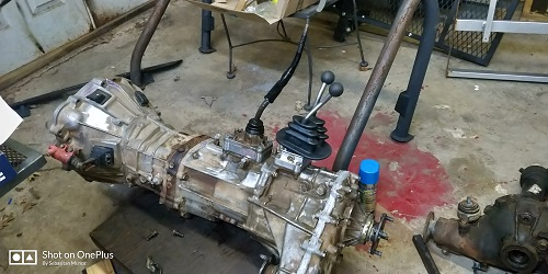

So far, on the swap... the transfer case had come apart something like 4 times because of issues with the interlock pin. Getting the twin-sticks was worth it but it was a PAIN. The pilot bearing was kind of seized up in the crank housing on the back of the motor, and I sacrificed a socket extension to get it out and replace the clutch. New aisin clutch and flywheel totally sweet! FROR frame mounts and my welding has improved dramatically.
My good mate paul enjoying the creature comforts of working in his own engine bay unhindered.

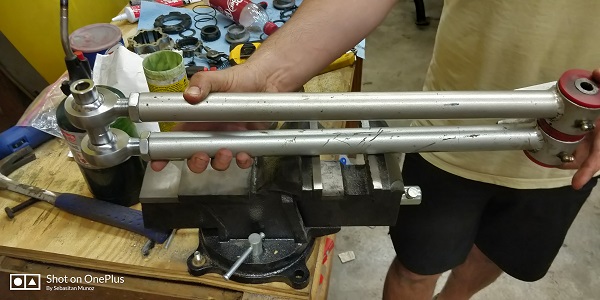

- Rear links rebuilt

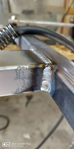

- Panhard Correction welded

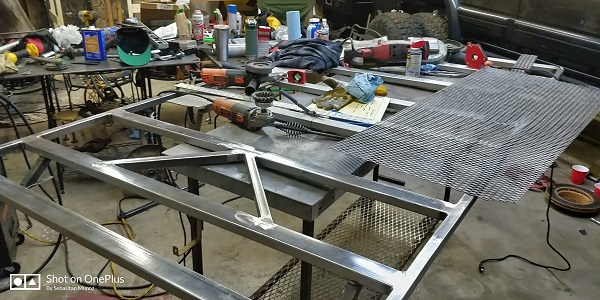

- New roof rack (still being worked on)

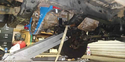

Third time's the charm
Last one for tonight... needed to make up for the lack of activity over the last little while. Going to get back to staying involved. Anyone feel like the 3rd gen community is sort of dwindling?

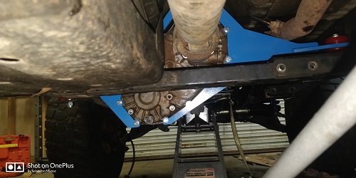

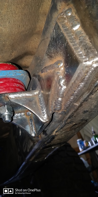

On another note: Here is the transmission all done up, crossmember mounted, painted, and being roughed in to the frame before having been welded on. It feels super solid, but I know I will be going dual cases, so I am going to have to wait for a dual case adapter until then!

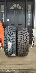

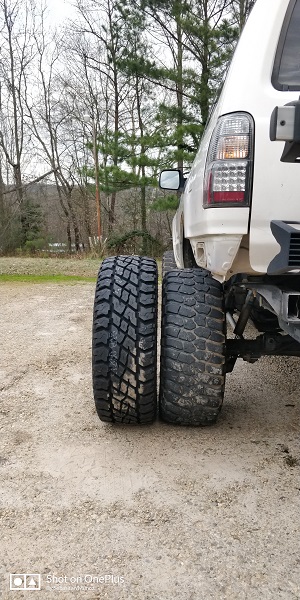

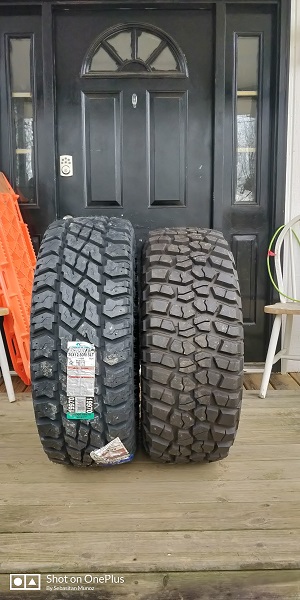

Cooper ST MAXX compared to the BFG KM2... No comparison! :focus:

Here is a photo from early spring... This is essentially where we are at. The roof rack is almost done and I have some hardwood to get started on a storage solution. The main criteria for the storage solution are: Adaptable space, minimal interference between spaces, and a relatively lightweight package. There will be a compromise somewhere, but we will cross that road when we get to refining some sort of design work.

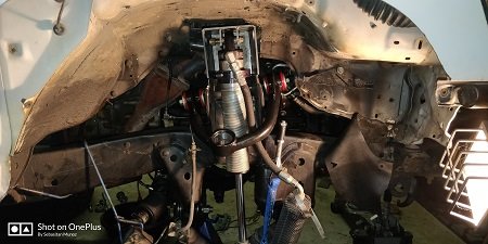

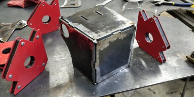

chop chop chop

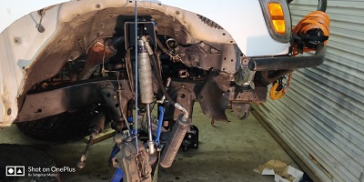

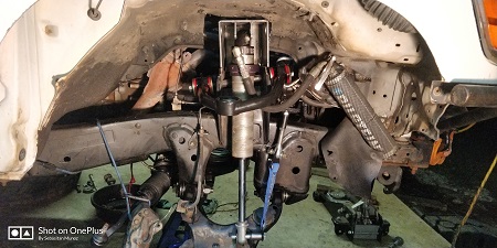

Over the weekend I decided to start chopping and get working on a design I have had in my head for a while.
Cut the strut towers out to stuff a massive coilover in there and gain some travel

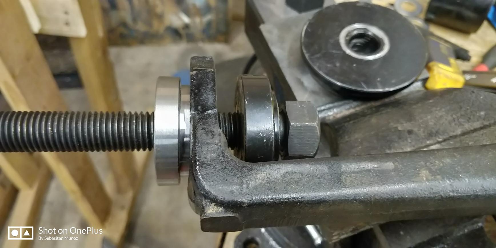

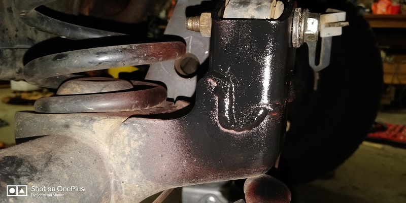

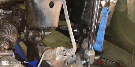

The fun kind of maintenance
Spindle gussets, repainted the UCA's, new bushes/sleeves/ and a beastly EMF Rebuildable Uniball which was nerveracking. [/ATTACH][/ATTACH]

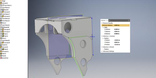

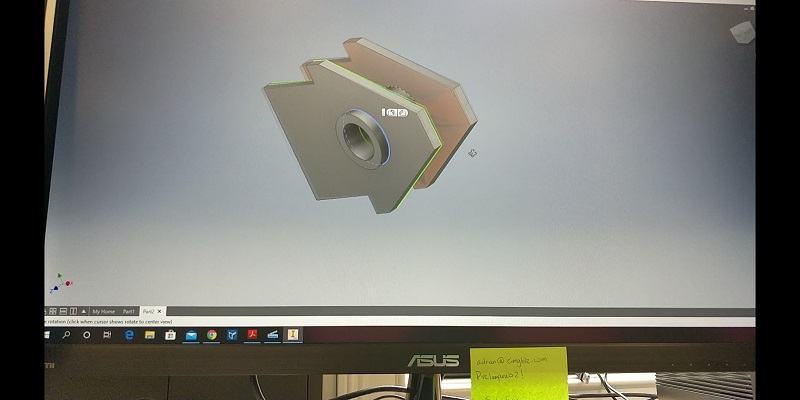

Will update on the design, but over a day I think I have worked the dimensions out and have a pretty complete design

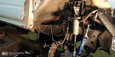

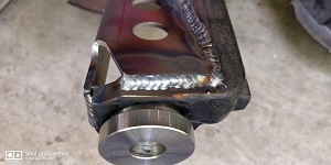

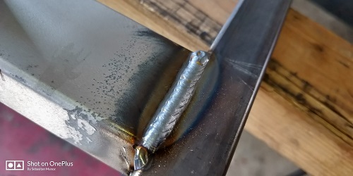

Progress

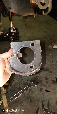

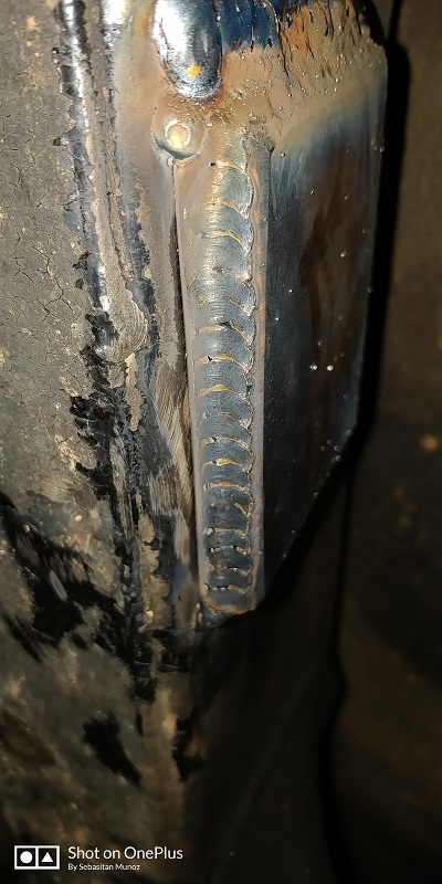

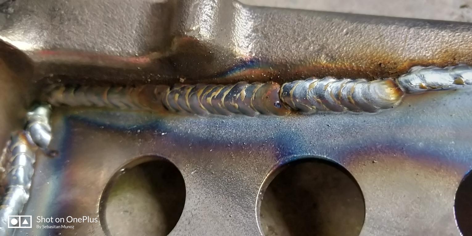

Over the weekend I got some parts cut out and well... IMG_20200526_215123.jpg IMG_20200526_215127.jpg

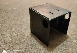

The new towers are tacked and mocked up.
Here you can see where we are at. Resi fittings need to be clocked 90 degrees.
Limit strap bracket is welded and Opt offroad CAM deletes are in too!
I need to make some clearance revisions and make a change to the tab depth, but overall. This is going well!

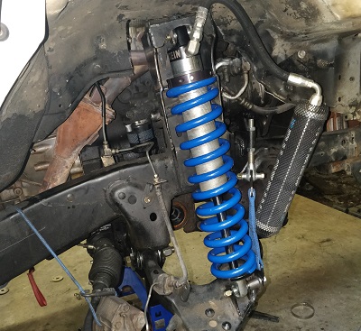

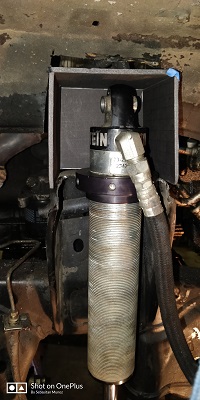

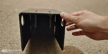

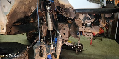

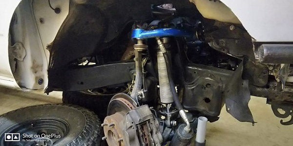

Did you ever finish that front coil bucket project? Seems relatively straight forward and worth it if you can pull 11-12” travel rather than $5k in a LT kit for 13” travel

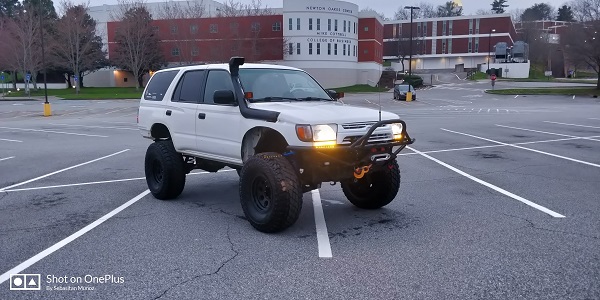

I did as a matter of fact, I've been absent from this forum for a while, but I've been driving it for the last two years after doing the conversion and the towers.
Did it make a difference with how much travel you got or handling? How do you like it?
It has made a significant difference with shock tuning. I'm able to run a much longer coilover and as a result, I am not sitting so deep in the travel. Re-valving allows me to make it a bit more of a progressive tune to have a supple feel on road and lots of bottom out resistance.
As far as offroad, I get as much articulation from the stock IFS geometry as you can squeeze out.
