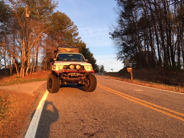

Those nilight projectors are the ones off of Amazon correct? I'm about to order everything to do a cheap retrofit, and was going to go with those as well. How well do they light up the road?
They are the nilight projectors! I will post an output shot of them for you. I have to wait until I am done with lectures for the day.

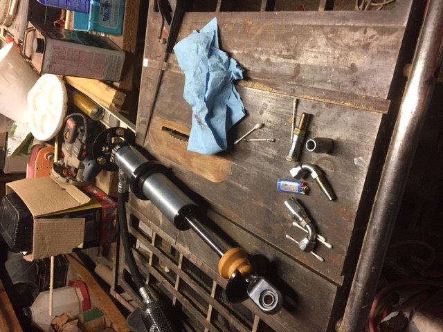

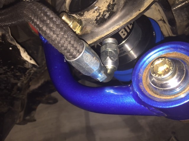

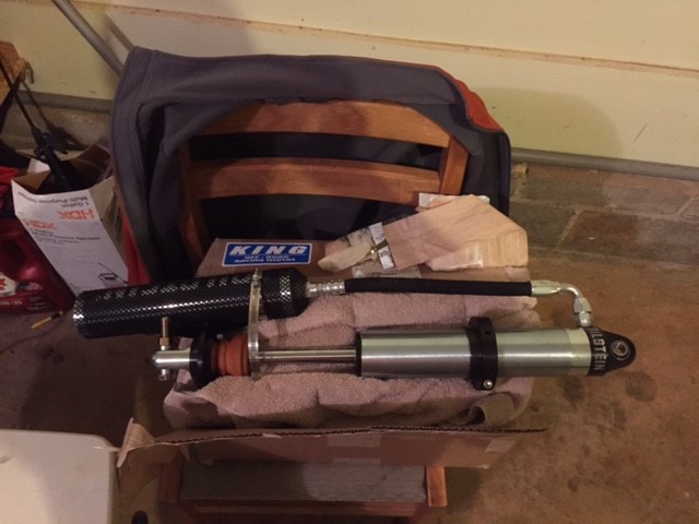

Update: We had to make some modifications to the orientation of the female and male 90* fittings that I ordered from Eaton. Essentially I added a 90* pipe fitting -8S size onto the shock body and flipped the hose around so that the 90* female fitting went onto the reservoir.
The below pictures were the original orientation
This didn't lear the UCA so I went back to the drawing board....

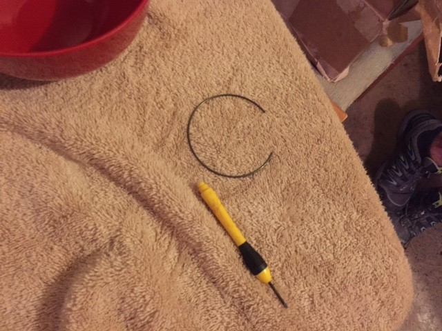

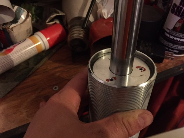

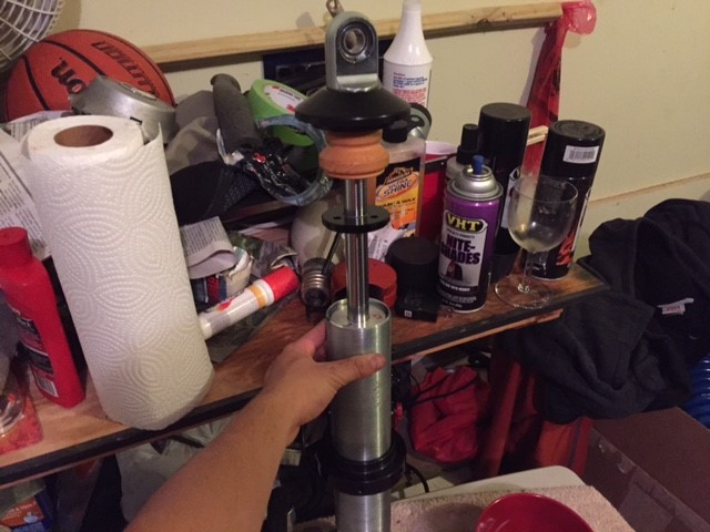

Shock Disassembly:
1:Remove the 3 hex bolts holding the piston dust cap on.
2:Depress the piston into the shock until the snap-ring is exposed.
3:Remove the snap-ring with a pick and pull on the shock shaft to remove from the shock body.
Reassembly: Follow the previous steps in reverse order.
I have a question. After you swapped the fittings. Who recharged the shock for you? Did you have to send it out or do you have someone local that can charge em?
I went to a place local to me called Motion Control Suspension. They were local to me (20 minutes). One suspension shop was going to charge me $250/shock. I looked around and MCS was a small shop manufacturer that actually filled my shocks up on two separate occasions for free. They were super nice and actually offered me a full-time job after seeing the 4Runner and some of the things that I have done. *I didn't take the job* Needless to say, it was free and local! Don't go to a big offroad shop!

There's a local place by me. It's a motorcycle shop that specializes in quads & dirt bikes. I wonder if they can pressurize shocks for me.
Just ask around to see who can pressurize with nitrogen. That's what most higher end coilovers are meant to run!

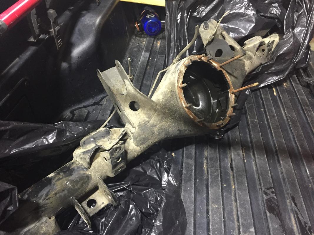

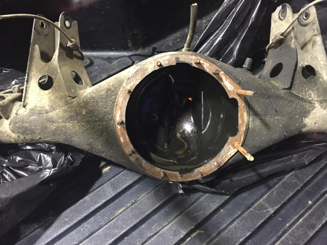

Southern Appalachia is a Toyota goldmine. A good friend was keeping his eye out for a brother and he helped me score a $100 e-locker axle housing and I finally received confirmation that my front E-locker will soon make its way to the US of A all the way from Aussieland. Here is a picture of the last peice I needed for my e locker conversion! Harness is ready to go and the 4.56 OEM E-locker will be installed once College let's out! IMG_7239.jpg IMG_7238.jpg
It's the little things in life :nod:

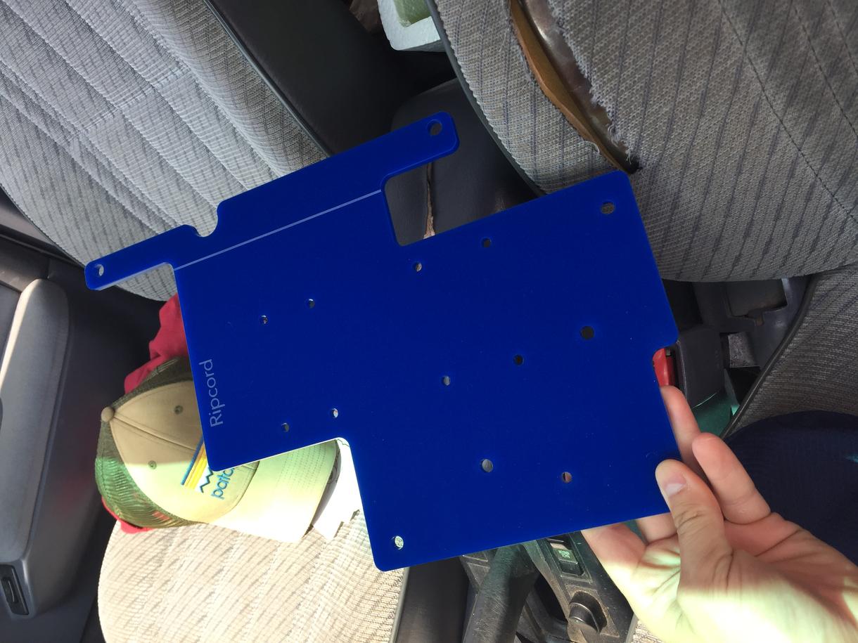

I got my 4-Ripcord Acrylic fuse panel right before he discontinued them! I am going to be running a CS144 Alternator and doing the big 3 mod in the next 2 weeks once college lets out, so I wanted to make sure I ordered my panel with every option he offered. Prompt delivery and a QUALITY product! I already have a Blue Seas Positive/Negative Bus 12-slot fuse panel, 100Amp circuit breaker and 120Amp breaker as well as an ignition relay, this was the last piece to the puzzle. I got this panel in "true blue" to match my King Springs, and it darn near perfect!IMG_7304.jpg Thank you Jim! [MENTION=57546]4-Ripcord[/MENTION] !
