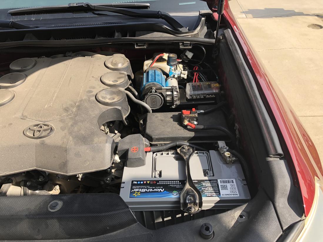

I had the same question a few weeks ago that have a dometic 35 L and wanted to see what was an alternative to a dual battery did some research and came up with upgrading battery I ended up with a NorthStar 27f got it in the mail yesterday installing it last night hooked the fridge last night been connected 24 hours with SoCal temps and I just went to check if battery was dead by starting truck and nope started right up

Did you need to do anything to make the 27F fit?

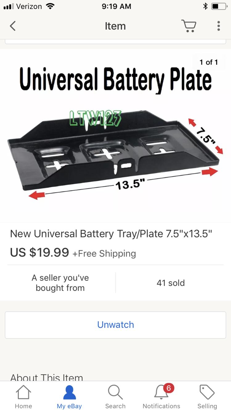

31m is basically the same footprint as 27 just taller and 110ish Ah vs 90ish Ah. You might want to get a metal tray since they are longer than stock.

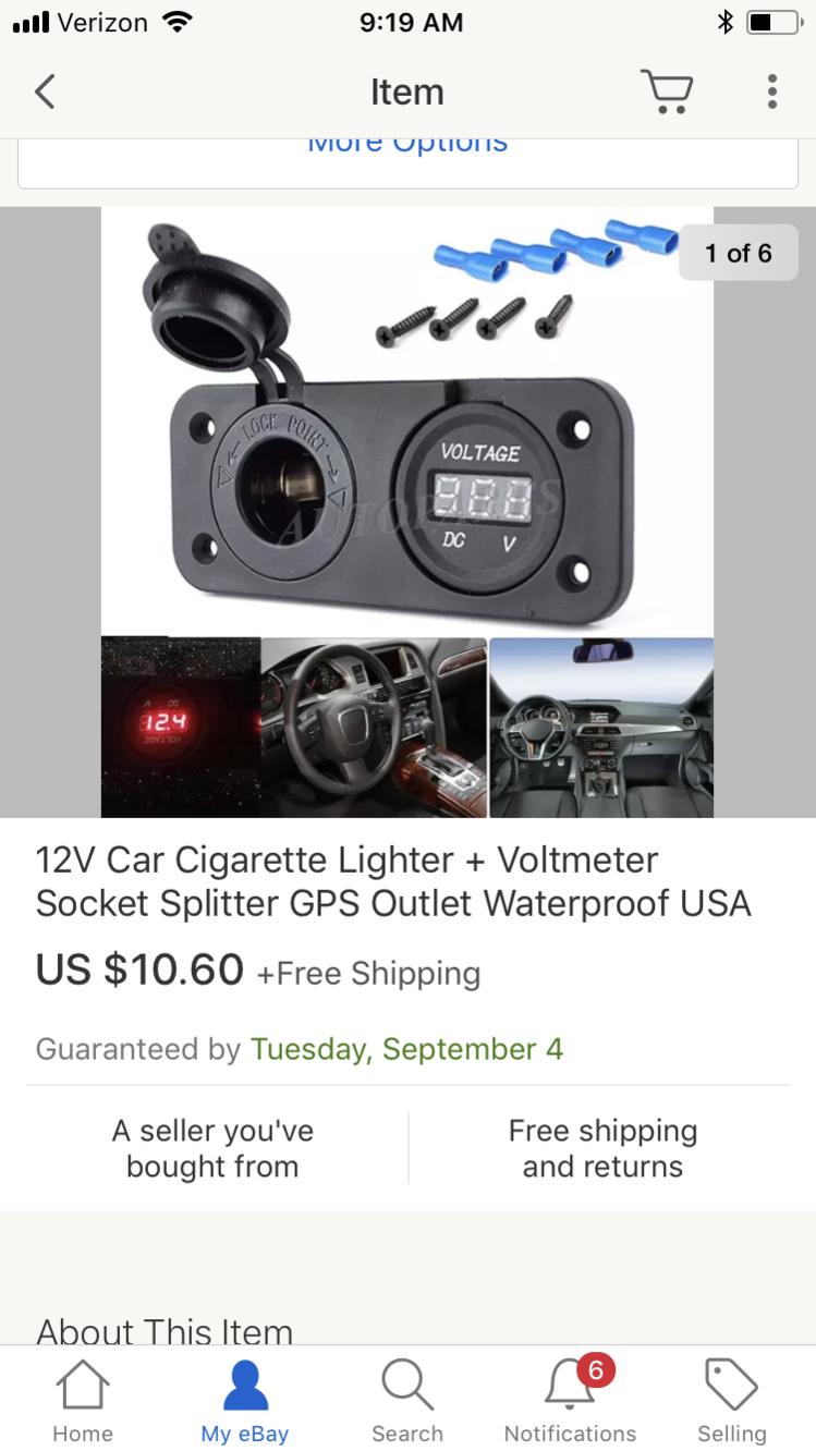

This are items I used for NorthStar 27f and 12v plug I installed in rear of truck

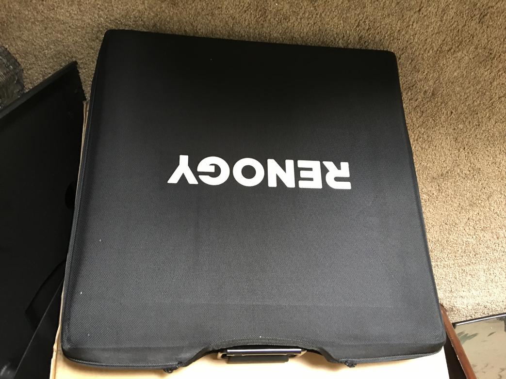

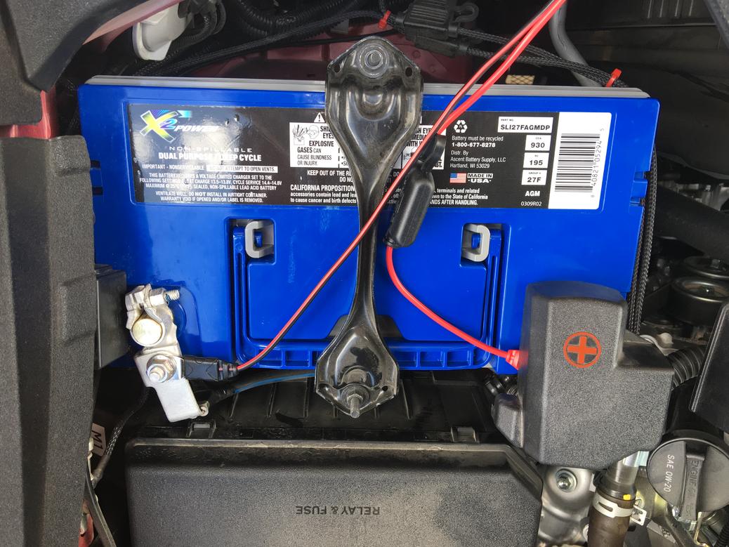

I decided to go with X2 Power 27F and a Renogy 100W solar suitcase. As long as I have decent light, I can run indefinitely. Worked great camping the last 2 1/2 days.
