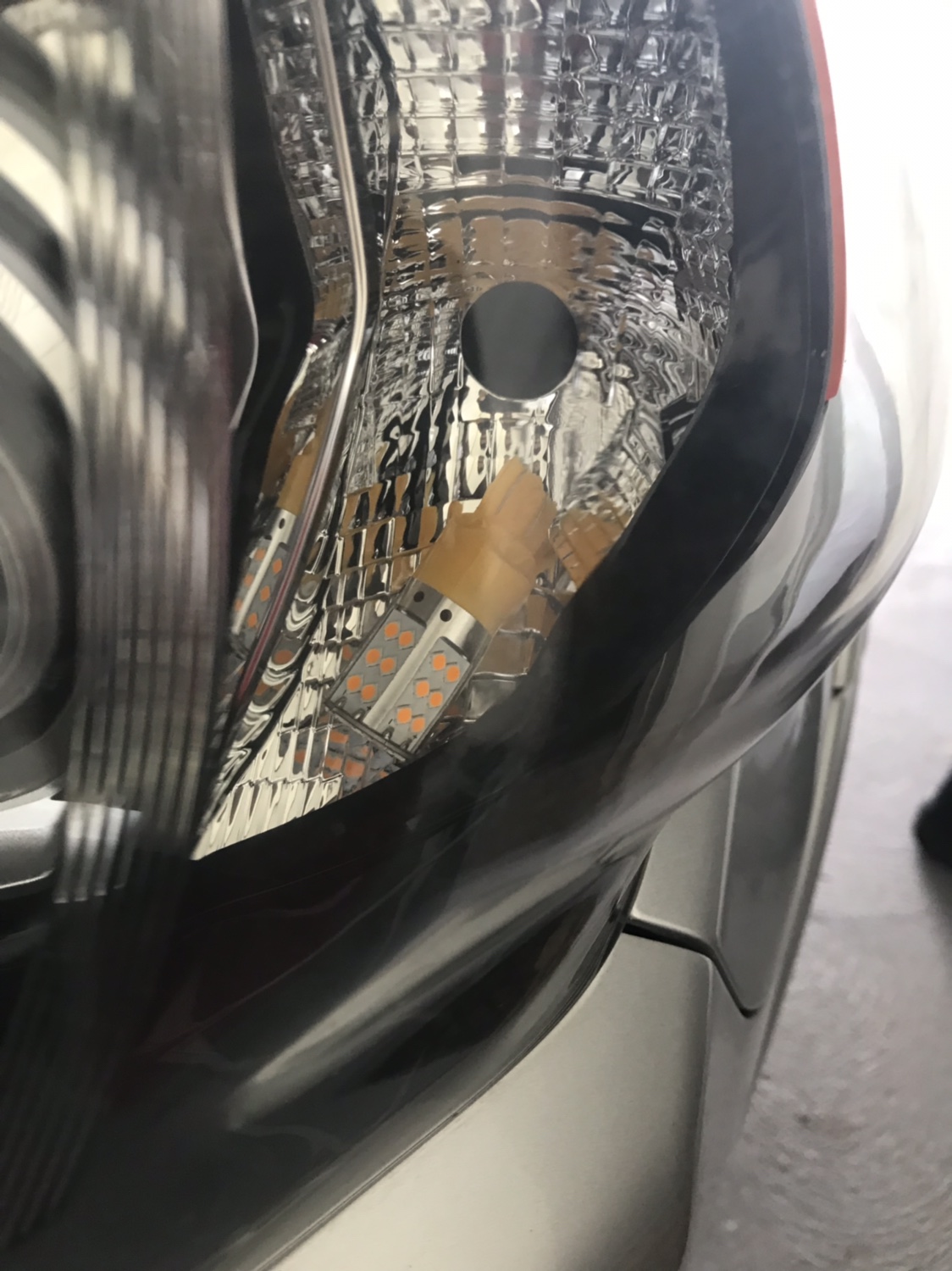

When installing new led lights into your headlight housing make sure they fit snuggly like the stock bulb does. If not this happens...

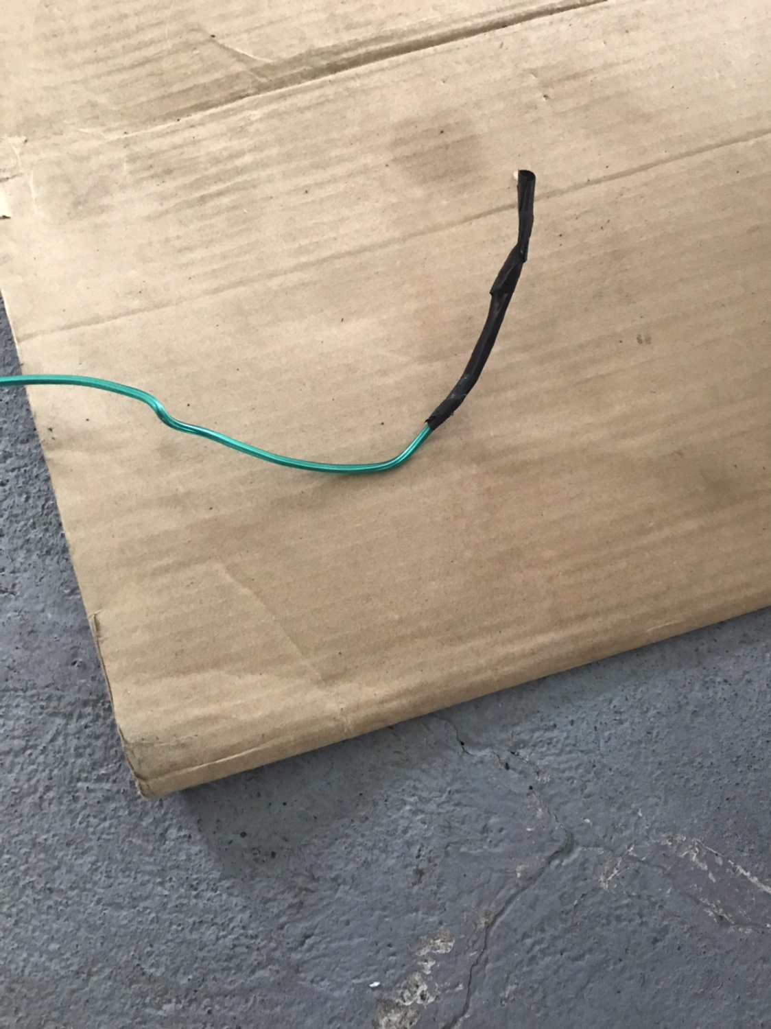

If this does happen you can use some wire clothes line and wrap a ton of electrical tape around it backwards so the sticky side is out
After fishing around in the housing for about 15 mins I was able to bring the light close enough to the opening and use a pair of needle nose pliers to pull it out.

This exact thing happened to me.... The bulb is still in the housing and has been for almost 2 years lol. It drove me nuts trying to get it out so I gave up...
