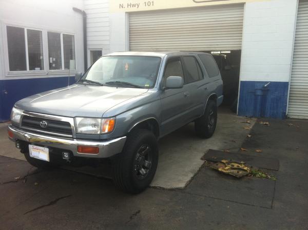

This is how she currently sits..nothing special yet.

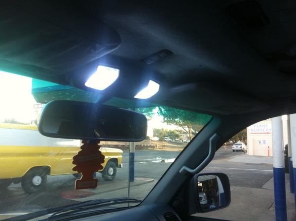

L.E.D map lights:

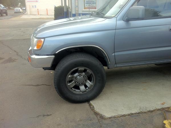

Painted stock wheels with duplicolor graphite:

What LED's are you using for your dome, map and cargo lights?
I got them from Hazardous Lighting out of Alpine. Map lights are almost too bright at night. Dan Hazard the owner is helping me install a rear hatch light for camping and hood light for emergency trailside repairs. He does excellent work with converting/installing LEDs, HID projector retrofits, and custom automotive lighting.

Love the wheels man. Want to do the same with mine. How did you prep/paint those guys?
1. Rinsed wheels off with soap and water..let dry.
2. Sanded with high grit sand paper.
3. Wiped down with acetone...let dry.
4. Sprayed self etching primer...2 coats let 1 hour to dry.
5. Sprayed Duplicolor graphite wheel paint ...4 coats... 10 mins between coats.
6. Sprayed clear coat enamel the next day...2 coats.. 5 mins between coats.
7. Let dry for min 2-3 hours.
8. Had a 6 pack of Stellas.

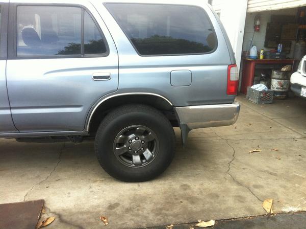

New wheels and bfgs.
Bad shot of the kings but the front sits about 1.25" higher then the rear :( even with 99 talls... Only have had them on since Saturday. o well time for some 906's
Most likely some bilstein smooth body shocks on some custom mounts. The above pics are with brand new 99 tall coils. Waiting for 906's to come in.
I'm running super flex and 94 land cruiser shock from auto parts store. Then my kings up front with no rake. About 3.5" of lift.
