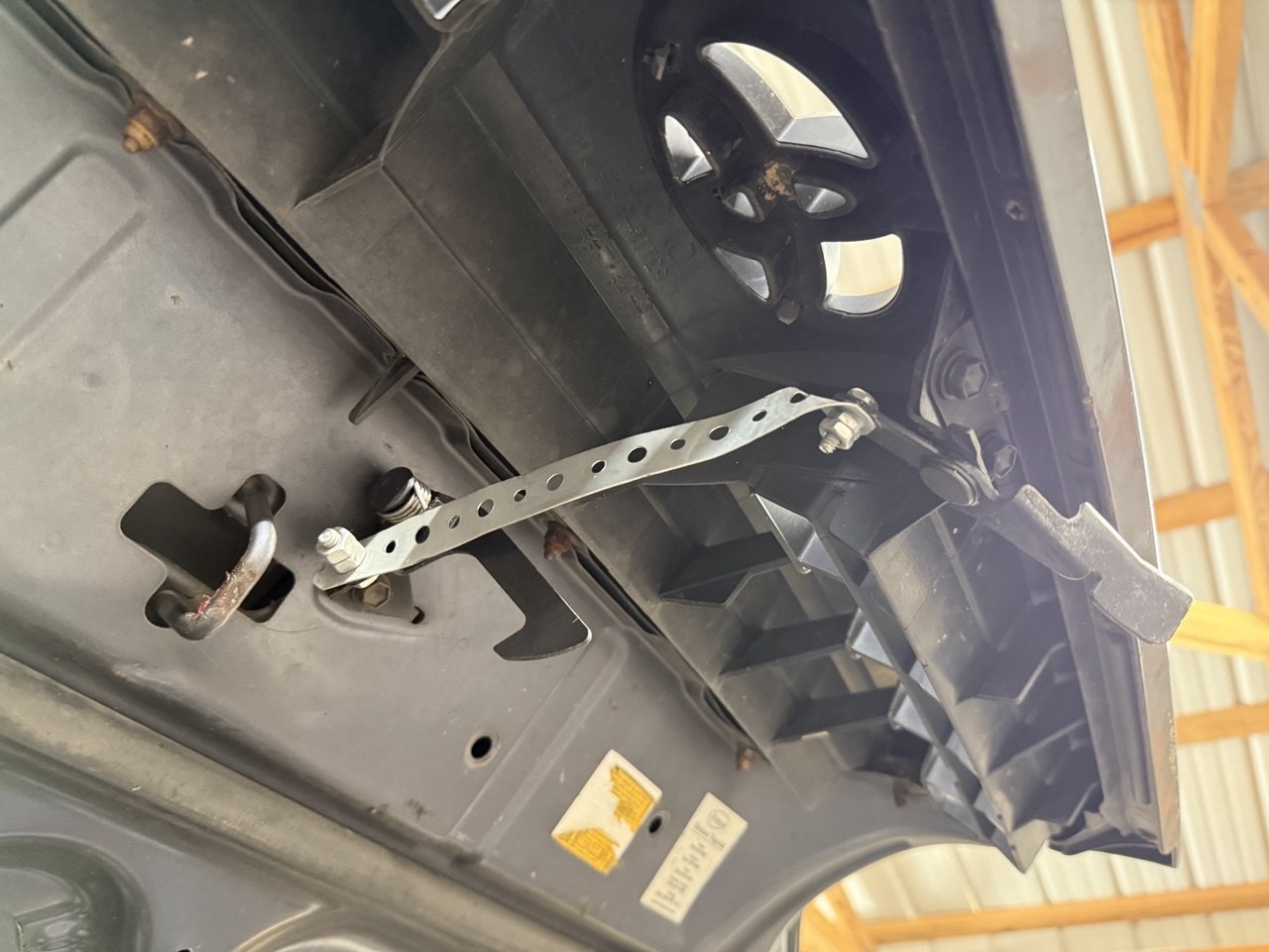

Got the 06-09 TRD "Toyota" Style Grille and modified it to fit on my 04. Just cut the original reinforcement bar on the bottom of the original grille and drilled new holes to make it work. Using a Strong hanger for the hood latch.

Hey man, I too have an 04 I did the headlight swap and 06 TRD grille with. I see in this post you mentioned using a strong hanger as a replacement hood latch/hook.
Would you care to elaborate on this solution you came up with? I’d love to be able to do the same with mine for piece of mind.
Thanks and cheers on the thread
I used a coated metal hanger for two reasons: it was the only one I could find with roughly the same thickness as the OEM rod, and the coating helps prevent rust and corrosion.
It took a little bit of tinkering to get the bends just right, but it's been working for months without any issues.
I hope these pictures help with your build!

I used a hanger with a coating on it, for two reasons. It was the only one with the same thickness as OEM rod and also prevents rust/corrosion... Took a little bit of tinkering to get the right bends but this has been working for months without failure. I hope these pictures help with your build!
<a href="https://imgur.com/gDytCvF"><img src="https://i.imgur.com/gDytCvFl.jpg" title="source: imgur.com" /></a> <a href="https://imgur.com/ePLvYWy"><img src="https://i.imgur.com/ePLvYWyl.jpg" title="source: imgur.com" /></a>
This helped a lot! Late response but was able to come up with something similar. Really appreciate it!
