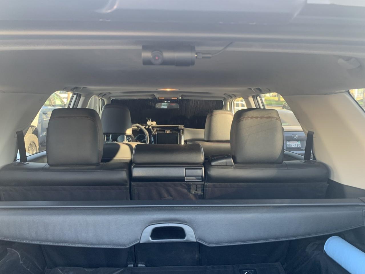

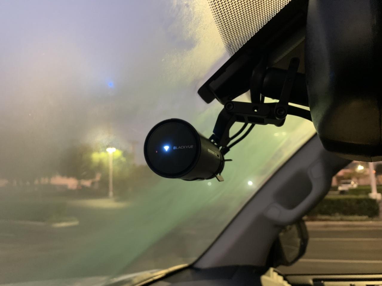

Blackvue DRS900. But really there are a lot of good ones out there like Yo, Garmin and Cobra. I see no need for a screen when you can access live and recorded video woth your phone. Mine is wired to my headunit because I wanted parking mode to work and I already have an aftermarket headunit so I spliced into the aftermarket wiring harness.

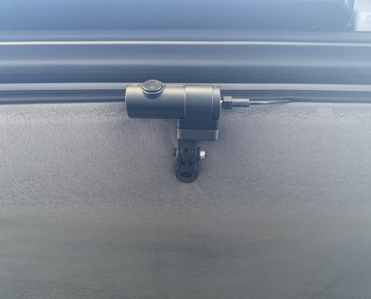

I appreciate you posting the pic of your rear camera. How did you route the wire to the rear camera?
Hope that this thread is still active. I'm looking for a two camera system for my 4Runner.
I purchased the longer cable option then a member on here sent me print files and I had a buddy print out a mount. There's a few on Etsy for sale now. I ran the cable along the door sill with the factory wring and rear washer hose. At the back I went behind the seat and along the inside of the passenger side panel then up the C pillar. I found this easier than trying to go above my headliner and above my moonroof.
