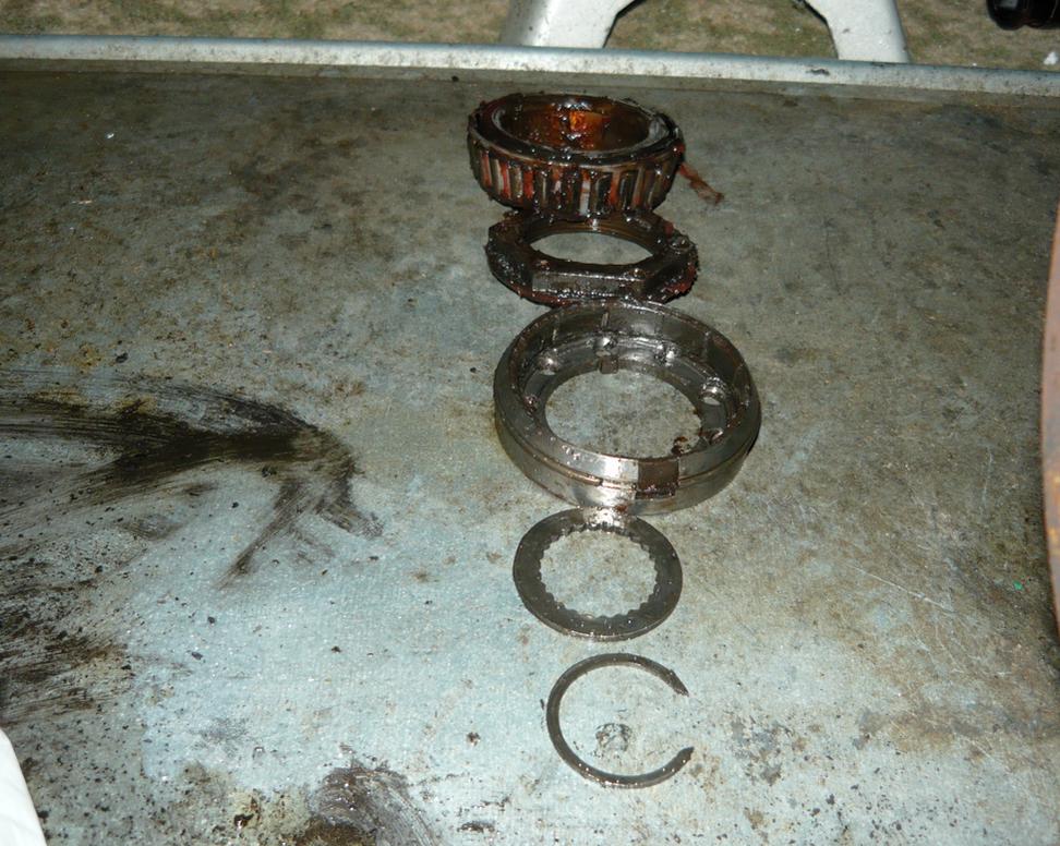

This is a pic of the components that I had to remove to get to mine at the hub side. I was doing the hubs and not the shafts, so I don't have any suggestions for the diff side.

Hey, Awz. When you pull the hub off, you'll be looking at the spindle. When you say "the little gear", you're talking about the second ring from the bottom in Helo's pic? The snap ring is holding that in place. I worked it off with a pair of flathead screwdrivers and some patience. While you've got the CV out is a great time to remove the studs on the axle stub flange and replace them with bolts, for what it's worth.

Got it figured out. I didn't realize I had to remove the hub housing, not just the dial part. And now I've run into the problem of the diff drop not allowing me to remove the shaft. Have to remove the knuckle to get it out at this point, and it's just a matter of time. Didn't have to mess with the wheel bearing at all, it's still loaded and where it's been for... however long it's been since someone messed with it. Thanks for the offer kid, but I think I got it now :)
