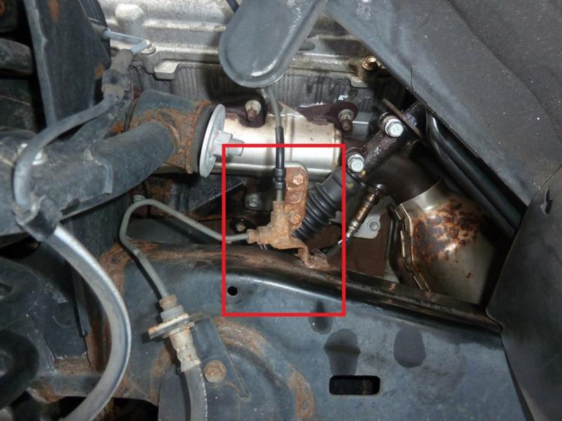

I finally got to fluid filming my 4th gen, but when i started scraping off the old parts i realized my passenger side brake line hold which holds the two ridged lines rusted off the frame, is there a replacement part i can order to give my mechanic?
i had to grab a pic off the internet
any idea what part number this is? how critical is it that i get it pinned down from vibrations?

I went over to parts.toyota website to find the brake line diagram. The diagram is sort of a pile of crap and hard to figure out what’s what but those brackets are pretty easy to pick out. The problem is the bracket is part of the L-fitting, and in all likelihood the associated brake line fittings screwed into that L-fitting will be impossible to salvage so you need to replace the lines or I guess get new fittings and appropriate brake line fab tools. I’ve never done brakes so I really don’t know.

I plan on replacing the same parts myself. I think I priced both driver and passenger side lines/fittings all the way to the caliper from the master cylinder at around $150 for OEM. Those brackets in your photos were around $22 a piece if I recall correctly.

thanks! could you kindly post it or let me know what section it was in? I tried looking for the lines but maybe i was looking in the wrong section im usually pretty good.
This is what you need: Toyota P/N 9041210245
Looks like $20 part. It is simply a right angle M10X1.0 inverted flare fitting.
90412-10245 - Genuine Toyota WAY, 2
Thanks man wow only 20 dollars. I was half expecting it to cost more money for nor eason. Looks like the bolt is stuck in the hole though. hopefully its easy to get out.
